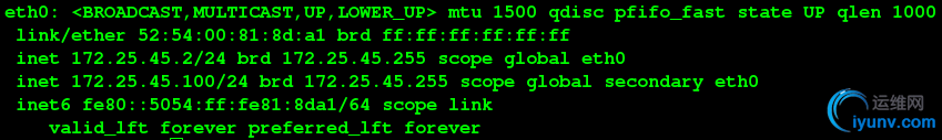

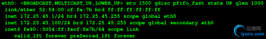

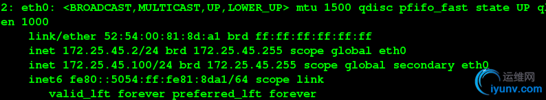

ip addr show
关闭server1的heartbeat的服务,vip切到server2上,但把server1的heartbeat服务打开,vip会切回server1上

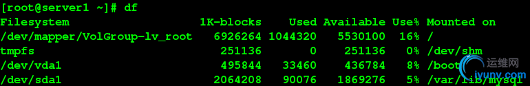

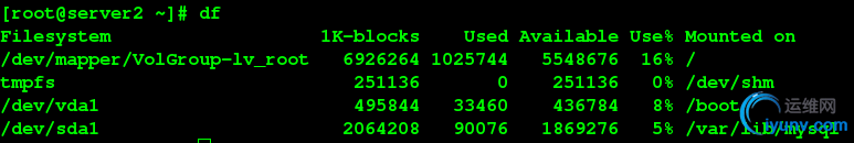

server1.example.com IPaddr::172.25.45.100/24/eth0 Filesystem::/dev/sda1::/var/lib/mysql::ext4  mysqld
scp haresources  172.25.45.2:/etc/ha.d/
/etc/init.d/mysqld stop
mount /dev/sda1 /mnt
cd /var/lib/mysql/
cp -rp * /mnt/
chown mysql.mysql /mnt/
umount /mnt
/etc/init.d/heartbeat stop
/etc/init.d/heartbeat start
tail -f /var/log/message
/etc/init.d/heartbeat start    ##在server2上
ip addr show
ip addr show    ##在server2上
将server1上的heartbeat服务再次打开,则server2上的vip和挂载都会切回server1

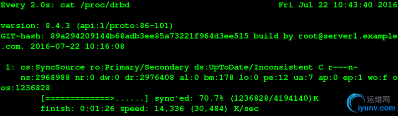

【server1】
cat /proc/drbd
drbdadm primary sqldata --force
cat /proc/drbd
watch cat /proc/drbd
