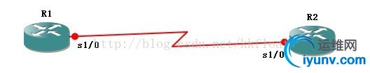

  • 实验一、HDLC封装
    R1配置:
    R1#conf t
    R1(config-if)#exit
    R1(config)#ints1/0
    R1(config-if)#ipadd 192.168.12.1 255.255.255.0
    R1(config-if)#encapsulationhdlc //设置接口封装模式为HDLC,其实Cisco路由器串口默认就是HDLC封装可以不打此命令
    R1(config-if)#nosh
    R1(config-if)#exit
    R2配置:
    R2#conf t
    R2(config)#ints1/0
    R2(config-if)#ipadd 192.168.12.2 255.255.255.0
    R2(config-if)#enc
    R2(config-if)#encapsulationhdlc
    R2(config-if)#nosh
    R2(config-if)#exit
    检查:
    R1#sh interfacess1/0
    Serial1/0 is up,line protocol is up
      Hardware is M4T
      Internet address is 192.168.12.1/24
      MTU 1500 bytes, BW 1544 Kbit, DLY 20000 usec,
         reliability 255/255, txload 1/255, rxload1/255
      Encapsulation HDLC, crc 16, loopbacknot set
      Keepalive set (10 sec)
      Restart-Delay is 0 secs
      CRC checking enabled
      Last input 00:00:08, output 00:00:08, outputhang never
      Last clearing of "show interface"counters never
      Input queue: 0/75/0/0(size/max/drops/flushes); Total output drops: 0
      Queueing strategy: weighted fair
      Output queue: 0/1000/64/0 (size/maxtotal/threshold/drops)
         Conversations  0/1/256 (active/max active/max total)
         Reserved Conversations 0/0 (allocated/maxallocated)
         Available Bandwidth 1158 kilobits/sec
      5 minute input rate 0 bits/sec, 0 packets/sec
      5 minute output rate 0 bits/sec, 0packets/sec
         37 packets input, 2974 bytes, 0 no buffer
         Received 37 broadcasts, 0 runts, 0 giants,0 throttles
         0 input errors, 0 CRC, 0 frame, 0 overrun,0 ignored, 0 abort
         48 packets output, 4122 bytes, 0 underruns
         0 output errors, 0 collisions, 2 interfaceresets
         0 output buffer failures, 0 output buffersswapped out
         3 carrier transitions     DCD=up DSR=up  DTR=up  RTS=up CTS=up

实验四、PPP的PAP双向认证
R1配置:
R1#conf t
R1(config)#usernameuser2 password abcdef //创建被验证方用户名、密码
R1(config)#ints1/0
R1(config-if)#encapsulationppp  //设置接口封装模式为PPP
R1(config-if)#pppauthentication pap //设置ppp使用pap认证模式
R1(config-if)#ppppap sent-username user1 password 123456//使用pap方式发送认证的自己的用户名和密码
R1(config-if)#nosh
R1(config-if)#exit
R2配置:
R2#conf t
R2(config)#usernameuser1 password 123456 //创建被验证方用户名、密码
R2(config)#ints1/0
R2(config-if)#encapsulationppp  //设置接口封装模式为PPP
R2(config-if)#pppauthentication pap //设置ppp使用pap认证模式
R2(config-if)#ppppap sent-username user2 password abcdef //使用pap方式发送认证的自己的用户名和密码
R2(config-if)#nosh
R2(config-if)#exit
检查测试:
R1#debug ppp authentication
PPP authentication debuggingis on
*Mar  1 00:39:04.179: Se1/0 PPP: Authorizationrequired
*Mar  1 00:39:04.191: Se1/0 PAP: Using hostnamefrom interface PAP
*Mar  1 00:39:04.195: Se1/0 PAP: Using passwordfrom interface PAP
*Mar  1 00:39:04.195: Se1/0 PAP: O AUTH-REQ id 5len 17 from "user1"
*Mar  1 00:39:04.195: Se1/0 PAP: I AUTH-REQ id 2len 17 from "user2"
*Mar  1 00:39:04.199: Se1/0 PAP: Authenticatingpeer user2
*Mar  1 00:39:04.203: Se1/0 PPP: Sent PAP LOGINRequest
*Mar  1 00:39:04.207: Se1/0 PPP: Received LOGINResponse PASS
*Mar  1 00:39:04.215: Se1/0 PPP: Sent LCP AUTHORRequest
*Mar  1 00:39:04.215: Se1/0 PPP: Sent IPCP AUTHORRequest
*Mar  1 00:39:04.227: Se1/0 LCP: Received AAA AUTHORResponse PASS
*Mar  1 00:39:04.227: Se1/0 IPCP: Received AAAAUTHOR Response PASS
*Mar  1 00:39:04.231: Se1/0 PAP: O AUTH-ACK id 2len 5
*Mar  1 00:39:04.283: Se1/0 PAP: I AUTH-ACK id 5len 5
*Mar  1 00:39:04.287: Se1/0 PPP: Sent CDPCP AUTHORRequest
*Mar  1 00:39:04.291: Se1/0 PPP: Sent IPCP AUTHORRequest
*Mar  1 00:39:04.303: Se1/0 CDPCP: Received AAAAUTHOR Response PASS
R2#debug ppp authentication
*Mar  1 00:29:54.299: Se1/0 PAP: Using hostnamefrom interface PAP
*Mar  1 00:29:54.303: Se1/0 PAP: Using passwordfrom interface PAP
*Mar  1 00:29:54.303: Se1/0 PAP: O AUTH-REQ id 1len 17 from "user2"
*Mar  1 00:29:54.335: Se1/0 PAP: I AUTH-REQ id 4len 17 from "user1"
*Mar  1 00:29:54.335: Se1/0 PAP: Authenticatingpeer user1
*Mar  1 00:29:54.339: Se1/0 PPP: Sent PAP LOGINRequest
*Mar  1 00:29:54.343: Se1/0 PPP: Received LOGINResponse PASS
*Mar  1 00:29:54.351: Se1/0 PPP: Sent LCP AUTHORRequest
*Mar  1 00:29:54.351: Se1/0 PPP: Sent IPCP AUTHORRequest
*Mar  1 00:29:54.359: Se1/0 LCP: Received AAAAUTHOR Response PASS
*Mar  1 00:29:54.363: Se1/0 IPCP: Received AAAAUTHOR Response PAS
*Mar  1 00:29:54.363: Se1/0 PAP: O AUTH-ACK id 4len 5
*Mar  1 00:29:54.371: Se1/0 PAP: I AUTH-ACK id 1len 5
*Mar  1 00:29:54.379: Se1/0 PPP: Sent CDPCP AUTHORRequest
*Mar  1 00:29:54.383: Se1/0 PPP: Sent IPCP AUTHORRequest
*Mar  1 00:29:54.391: Se1/0 CDPCP: Received AAAAUTHOR Response PASS

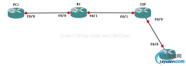

实验七、PPP overethernet(PPPoE)模拟ADSL拨号上网
PC1配置:
Router#conf t
Router(config)#hostname PC1
PC1(config)#int fa0/0
PC1(config-if)#ip address dhcp
PC1(config-if)#no sh
Internet配置:
Internet#conf t
Internet(config)#int fa0/0
Internet(config-if)#ip add 202.100.100.1 255.255.255.0
Internet(config-if)#no sh
Internet(config-if)#exit
Internet(config)#router ospf 1
Internet(config-router)#net 0.0.0.0 255.255.255.255 area 0
Internet(config-router)#exit
ISP配置:
ISP#conf t
ISP(config)#int fa0/0
ISP(config-if)#ip add 202.100.100.100 255.255.255.0
ISP(config-if)#no sh
ISP(config-if)#exit
ISP(config)#username user1 password adsl123456 //创建拨号认证的账户
ISP(config)#int virtual-template 1 //创建虚拟拨号模板接口
ISP(config-if)#mtu 1492 //修改虚拟接口的MTU,因为增加了8 byte的PPPoe与ppp封装,而以太网IP封装不能超过1500byte
ISP(config-if)#ppp authentication chap //此虚拟拨号接口使用PPP的chap认证,客户端必须发用户名跟密码
ISP(config-if)#ip address 80.80.80.1 255.255.255.0 //配置此虚拟接口的IP地址
ISP(config-if)#ppp ipcp dns 8.8.8.8 4.4.4.4//拨号用户认证成功后获得的域名服务器地址
ISP(config-if)#peer default ip address pool ADSL-POOL //拨号用户chap认证成功后可以获得的地址池地址
ISP(config-if)#no sh//开启接口
ISP(config-if)#exit
ISP(config)#bba-group pppoe ADSL //建立全局bba组
ISP(config-bba-group)#virtual-template 1 //将前面创建的虚拟拨号模板放到bba组中
ISP(config-bba-group)#sessions per-mac limit 1 //设置此拨号组中的每个mac地址的pppoe会话数限制为1
ISP(config-bba-group)#exit
ISP(config)#int fa0/1
ISP(config-if)#pppoe enable group ADSL//将物理接口关联到bba组ADSL,并使能PPPOE
ISP(config-if)#no sh //开启接口
ISP(config-if)#exit
ISP(config)#router ospf 1
ISP(config-router)#net 0.0.0.0 255.255.255.255 area 0
ISP(config-router)#passive-interface fa0/1
ISP(config-router)#exit
R1配置:
Router>en
Router#conf t
Router(config)#hostname R1
R1(config)#ip dhcp pool LAN-POOL //创建为内部用户分配的DHCP地址池
R1(dhcp-config)#network 192.168.1.0 //设置地址池分配的网络地址
R1(dhcp-config)#dns-server 8.8.8.8 4.4.4.4//设置地址池分配的DNS服务器地址
R1(dhcp-config)#default-router 192.168.1.1//设置地址池分配的默认网关
R1(dhcp-config)#lease 7//设置地址池租约期限为7天
R1(dhcp-config)#exit
R1(config)#ip dhcp excluded-address 192.168.1.1 192.168.1.99//设置 DHCP地址池不分配的IP段
R1(config)#ip dhcp excluded-address 192.168.1.201 192.168.1.254//设置 DHCP地址池不分配的IP段
R1(config)#int fa0/0
R1(config-if)#ip add 192.168.1.1 255.255.255.0
R1(config-if)#ip nat inside //接口开启内部NAT
R1(config-if)#no sh
R1(config-if)#exit
R1(config)#int Dialer 1 //创建拨号虚拟接口 1
R1(config-if)#mtu 1492 //修改虚拟接口的MTU,因为增加了8 byte的PPPoe与ppp封装,而以太网IP封装不能超过1500byte
R1(config-if)#ip address negotiated//此接口IP地址根据协商获得,即有ISP分配
R1(config-if)#encapsulation ppp //设置此接口为PPP封装
R1(config-if)#ppp authentication chap callin//路由器R1先发起呼叫到路由器ISP,ISP路由器收到呼叫会挑战路由器R1,但路由器R1不会挑战路由器ISP。实质就是单向认证。此命令可以不打
R1(config-if)#ppp chap host user1 //设置chap认证使用的用户名
R1(config-if)#ppp chap password adsl123456 //设置chap认证使用的密码
R1(config-if)#ppp ipcp dns request accept //当IPCP协商完全成功时,请求并接受ISP端发过来的DNS服务器地址
R1(config-if)#ppp ipcp route default//当IPCP协商完全成功时,增加一个预设路由路径到系统的路由表,将对端当作默认路由使用。这个路由条目在ppp连线中断后会移除。
R1(config-if)#ip nat outside//此接口开启外部 NAT
R1(config-if)#dialer pool 1 //将此接口加入拨号池1
R1(config-if)#no sh
R1(config-if)#exit
R1(config)#int fa0/1
R1(config-if)#pppoe enable group global //物理接口使能PPPoe,关联bba全局组
R1(config-if)#pppoe-client dial-pool-number 1//将物理接口关联拨号池1
R1(config-if)#no sh //开启接口
R1(config-if)#exit
R1(config)#access-list 1 permit 192.168.1.0 0.0.0.255//标记可以NAT的网段
R1(config)#ip nat inside source list 1 interface dialer 1 overload//设置端口复用NAT
检查测试:
ISP#debug ppp  authentication
*Mar  1 00:13:38.823: ppp3 PPP:Using vpn set call direction
*Mar  1 00:13:38.827: ppp3 PPP:Treating connection as a callin
*Mar  1 00:13:38.827: ppp3 PPP:Session handle[22000005] Session id[3]
*Mar  1 00:13:39.023: ppp3 PPP:Authorization required
*Mar  1 00:13:39.087: ppp3 CHAP: OCHALLENGE id 1 len 24 from "ISP"
*Mar  1 00:13:39.147: ppp3 CHAP: IRESPONSE id 1 len 26 from "user1"
*Mar  1 00:13:39.159: ppp3 PPP:Sent CHAP LOGIN Request
*Mar  1 00:13:39.167: ppp3 PPP:Received LOGIN Response PASS
*Mar  1 00:13:39.263: Vi1.1 PPP:Sent LCP AUTHOR Request
*Mar  1 00:13:39.267: Vi1.1 PPP:Sent IPCP AUTHOR Requestl
*Mar  1 00:13:39.283: Vi1.1 LCP:Received AAA AUTHOR Response PASS
*Mar  1 00:13:39.287: Vi1.1 IPCP:Received AAA AUTHOR Response PASS
*Mar  1 00:13:39.291: Vi1.1 CHAP:O SUCCESS id 1 len 4
R1#sh ip int brief
Interface                 IP-Address      OK? MethodStatus                Protocol
FastEthernet0/0           192.168.1.1     YES manual up                    up
FastEthernet0/1           unassigned      YES unset  up                    up
NVI0                      192.168.1.1     YES unset  up                    up
Virtual-Access1           unassigned      YES unset  up                    up
Virtual-Access2           unassigned      YES unset  up                    up
Dialer1                    80.80.80.101    YES IPCP  up                    up
R1#sh ip name-server
8.8.8.8
4.4.4.4
R1#sh ip route
Codes: C - connected, S - static, R - RIP, M - mobile, B - BGP
       D - EIGRP, EX - EIGRPexternal, O - OSPF, IA - OSPF inter area
       N1 - OSPF NSSA externaltype 1, N2 - OSPF NSSA external type 2
       E1 - OSPF external type 1,E2 - OSPF external type 2
       i - IS-IS, su - IS-ISsummary, L1 - IS-IS level-1, L2 - IS-IS level-2
       ia - IS-IS inter area, * -candidate default, U - per-user static route
       o - ODR, P - periodicdownloaded static route
Gateway of last resort is 80.80.80.1 to network 0.0.0.0
     80.0.0.0/32 is subnetted, 2subnets
C       80.80.80.101 is directlyconnected, Dialer1
C       80.80.80.1 is directlyconnected, Dialer1
C    192.168.1.0/24 is directlyconnected, FastEthernet0/0
S*   0.0.0.0/0 [1/0] via 80.80.80.1
PC1#ping 202.100.100.100
Type escape sequence to abort.
Sending 5, 100-byte ICMP Echos to 202.100.100.100, timeout is 2 seconds:
Success rate is 80 percent (4/5), round-trip min/avg/max = 28/60/96 ms
R1#debug ip nat
IP NAT debugging is on
*Mar  1 00:36:46.379: NAT*: s=192.168.1.100->80.80.80.101,d=202.100.100.100 [5]
*Mar  1 00:36:46.455: NAT*:s=202.100.100.100, d=80.80.80.101->192.168.1.100 [5]
*Mar  1 00:36:46.507: NAT*:s=192.168.1.100->80.80.80.101, d=202.100.100.100 [6]
*Mar  1 00:36:46.523: NAT*:s=202.100.100.100, d=80.80.80.101->192.168.1.100 [6

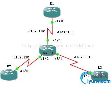

实验九、帧中继之配置星型网络并尝试运行EIGRP(RIP)
R1配置:
R1#conf t
R1(config)#int lo 1
R1(config-if)#ip add 1.1.1.1 255.255.255.0
R1(config-if)#exit
R1(config)#int s1/0
R1(config-if)#encapsulation frame-relay
R1(config-if)#frame-relay map ip 10.10.10.1 102
R1(config-if)#ip add 10.10.10.1 255.255.255.0
R1(config-if)#no sh
R1(config-if)#exit
R1(config)#router eigrp 1
R1(config-router)#net 0.0.0.0 255.255.255.255
R1(config-router)#no auto-summary
R2配置:
R2#conf t
R2(config)#int lo 1
R2(config-if)#ip add 2.2.2.2 255.255.255.0
R2(config-if)#exit
R2(config)#int s1/0
R2(config-if)#encapsulation frame-relay
R2(config-if)#frame-relay map ip 10.10.10.2 201
R2(config-if)#ip add 10.10.10.2 255.255.255.0
R2(config-if)#no sh
R2(config-if)#exit
R2(config)#router eigrp 1
R2(config-router)#net 0.0.0.0 255.255.255.255
R2(config-router)#no auto-summary
R3配置:
R3#conf t
R3(config)#int lo 1
R3(config-if)#ip add 3.3.3.3 255.255.255.0
R3(config-if)#exit
R3(config)#int s1/0
R3(config-if)#encapsulation frame-relay
R3(config-if)#frame-relay map ip 10.10.10.3 301
R3(config-if)#ip add 10.10.10.3 255.255.255.0
R3(config-if)#no sh
R3(config-if)#exit
R3(config)#router eigrp 1
R3(config-router)#net 0.0.0.0 255.255.255.255
R3(config-router)#no auto-summary
FR-SW配置:
FR-SW#conf t
FR-SW(config)#frame-relay switching
FR-SW(config)#int s1/1
FR-SW(config-if)#encapsulation frame-relay
FR-SW(config-if)#frame-relay intf-type dce
FR-SW(config-if)#frame-relay route 102 interface s1/2 201
FR-SW(config-if)#frame-relay route 103 interface s1/3 301
FR-SW(config-if)#no sh
FR-SW(config-if)#exit
FR-SW(config)#int s1/2
FR-SW(config-if)#frame-relay route 201 interface s1/1 102
FR-SW(config)#int s1/3
FR-SW(config-if)#frame-relay route 301 interface s1/1 103
检查测试:
R1#sh frame-relay pvc
PVC Statistics for interface Serial1/0 (Frame Relay DTE)
              Active     Inactive      Deleted       Static
  Local          2            0            0            0
  Switched       0            0            0            0
  Unused         0            0            0            0
DLCI = 102, DLCI USAGE = LOCAL, PVC STATUS = ACTIVE, INTERFACE =Serial1/0
  input pkts 10            output pkts 11           in bytes 58
  out bytes 628            dropped pkts 0           in pkts dropped 0
  out pkts dropped 0                out bytes dropped 0
  in FECN pkts 0           in BECN pkts 0           out FECN pkts 0
  out BECN pkts 0          in DE pkts 0             out DE pkts 0
  out bcast pkts 6         out bcast bytes 324
  5 minute input rate 0 bits/sec,0 packets/sec
  5 minute output rate 0 bits/sec,0 packets/sec
  pvc create time 00:05:36, lasttime pvc status changed 00:05:26
DLCI = 103, DLCI USAGE = LOCAL, PVC STATUS = ACTIVE, INTERFACE =Serial1/0
  input pkts 28            output pkts 28           in bytes 2318
  out bytes 2354           dropped pkts 0           in pkts dropped 0
  out bcast pkts 7         out bcast bytes 418
  pvc create time 00:05:37, lasttime pvc status changed 00:05:27
R1#sh frame-relay map
Serial1/0 (up): ip 10.10.10.1 dlci 102(0x66,0x1860), static,
              CISCO, statusdefined, active
Serial1/0 (up): ip 10.10.10.2 dlci 102(0x66,0x1860), dynamic,
              broadcast,
Serial1/0 (up): ip 10.10.10.3 dlci 103(0x67,0x1870), dynamic
              broadcast,, statusdefined, active
R1#ping 10.10.10.2
Sending 5, 100-byte ICMP Echos to 10.10.10.2, timeout is 2 seconds:
Success rate is 100 percent (5/5), round-trip min/avg/max = 36/50/92 ms
R1#ping 10.10.10.3
Sending 5, 100-byte ICMP Echos to 10.10.10.3, timeout is 2 seconds:
Success rate is 100 percent (5/5), round-trip min/avg/max = 36/55/88 ms
R1#sh ip rou eigrp
     2.0.0.0/24 is subnetted, 1subnets
D       2.2.2.0 [90/2297856] via10.10.10.2, 00:04:09, Serial1/0
     3.0.0.0/24 is subnetted, 1subnets
D       3.3.3.0 [90/2297856] via10.10.10.3, 00:05:52, Serial1/0
R2#sh ip rou eigrp //学不到全部路由
     1.0.0.0/24 is subnetted, 1subnets
D       1.1.1.0 [90/2297856] via10.10.10.1, 00:04:27, Serial1/0
R3#sh ip route  eigrp//学不到全部路由
D       1.1.1.0 [90/2297856] via10.10.10.1, 00:06:40, Serial1/0
在帧中继星型网络中不难发现,只有R1这个中心路由器学习到了所有路由,而R2、R3并没有学习到全部路由,这是因为RIP和EIGRP的水平分割问题导致的路由更新问题。另外运行OSPF路由协议也会有问题的

R3配置:
R3#conf t
R3(config)#int lo 1
R3(config-if)#exit
R3(config)#int s1/0
R3(config-if)#no frame-relay inverse-arp
R3(config-if)#frame-relay map ip 10.10.10.5 301 broadcast
R3(config-if)#ip add 10.10.10.6 255.255.255.252
R3(config-if)#no sh
R3(config-if)#exit
FR-SW配置:
FR-SW#conf t
检查测试:
R1#sh fr pvc
  Local          2            0            0            0
  Switched       0            0            0            0
  Unused         0            0            0           0
DLCI = 102, DLCI USAGE = LOCAL, PVC STATUS = ACTIVE, INTERFACE =Serial1/0.12
  input pkts 15            output pkts 108          in bytes 924
  out bytes 11712          dropped pkts 0           in pkts dropped 0
  out bcast pkts 103       out bcast bytes 11350
  pvc create time 00:18:52, last timepvc status changed 00:18:52
DLCI = 103, DLCI USAGE = LOCAL, PVC STATUS = ACTIVE, INTERFACE =Serial1/0.13
  input pkts 9             output pkts 82           in bytes 492
  out bytes 8391           dropped pkts 0           in pkts dropped 0
  out bcast pkts 75        out bcast bytes 7885
  pvc create time 00:18:54, lasttime pvc status changed 00:18:54
Serial1/0.12 (up): point-to-point dlci, dlci 102(0x66,0x1860), broadcast
          status defined, active
Serial1/0.13 (up): point-to-point dlci, dlci 103(0x67,0x1870), broadcast
R1#sh ip route eigrp
D       2.2.2.0 [90/2297856] via10.10.10.2, 00:02:39, Serial1/0.12
D       3.3.3.0 [90/2297856] via10.10.10.6, 00:01:46, Serial1/0.13
R2#sh ip route eigrp
D       1.1.1.0 [90/2297856] via10.10.10.1, 00:03:01, Serial1/0
D       3.3.3.0 [90/2809856] via10.10.10.1, 00:02:08, Serial1/0
     10.0.0.0/30 is subnetted, 2subnets
D       10.10.10.4 [90/2681856]via 10.10.10.1, 00:03:01, Serial1/0
D       1.1.1.0 [90/2297856] via10.10.10.5, 00:03:01, Serial1/0
D       2.2.2.0 [90/2809856] via10.10.10.5, 00:03:01, Serial1/0
D       10.10.10.0 [90/2681856]via 10.10.10.5, 00:03:01, Serial1/

R1(config-if)#no frame-relay inverse-arp
R1(config-if)#frame-relay map ip 10.10.10.2 102 broadcast
R1(config-if)#frame-relay map ip 10.10.10.3 103 broadcast
R1(config-if)#ip ospf network point-to-multipoint//当OSPF网络类型为point-to-multi时,那么此接口将会向外发送32位的路由更新,那么接受路由器将会得到一个32为的主机路由。此时OSPF的逻辑是:因为点到多点的接口连出去可能会有多个路由器与我处于同一网段,而此时的网络的二层结构可能不是以太网类型,也就是说可能无法使用ARP协议进行精确查找,所以为了让对方能够准确的找到我,必须使用32位主机路由。
R1(config-if)#no sh
R1(config-if)#exit
R1(config)#int lo 1
R1(config-if)#exit
R1(config)#router ospf 1
R1(config-router)#net 0.0.0.0 255.255.255.255 area 0
R1(config-router)#exit
R2配置:
R2#conf t
R2(config)#int s1/0
R2(config-if)#no frame-relay inverse-arp
R2(config-if)#frame-relay map ip 10.10.10.1 201 broadcast//手动添加到R1的DLCI映射,并设置映射支持广播,注意:最后跟的那个broadcast是指在二层开启广播支持功能,不添加到R3的映射,让网络成为帧中继Hub-Spoke网络
R2(config-if)#ip ospf network point-to-multipoint
R2(config-if)#no sh
R2(config-if)#exit
R2(config)#int lo 1
R2(config-if)#exit
R2(config)#router ospf 1
R2(config-router)#net 0.0.0.0 255.255.255.255 area 0
R2(config-router)#exit
R3配置:
R3#conf t
R3(config)#int s1/0
R3(config-if)#frame-relay map ip 10.10.10.1 301 broadcast//手动添加到R1的DLCI映射,并设置映射支持广播,注意:最后跟的那个broadcast是指在二层开启广播支持功能,不添加到R2的映射,让网络成为帧中继Hub-Spoke网络
R3(config-if)#ip ospf network point-to-multipoint
R3(config-if)#no sh
R3(config-if)#exit
R3(config)#int lo 1
R3(config-if)#exit
R3(config)#router ospf 1
R3(config-router)#net 0.0.0.0 255.255.255.255 area 0
R3(config-router)#exit
检查测试:
Serial1/0 (up): ip 10.10.10.2 dlci 102(0x66,0x1860),static,
             broadcast, CISCO, status defined, active
Serial1/0 (up): ip 10.10.10.3 dlci 103(0x67,0x1870),static,
              broadcast,CISCO, status defined, active
R2#sh frame-relay map
Serial1/0 (up): ip 10.10.10.1 dlci 201(0xC9,0x3090),static,
R3#sh frame-relay map
Serial1/0 (up): ip 10.10.10.1 dlci 301(0x12D,0x48D0),static,
R1#sh ip ospf neighbor
Neighbor ID    Pri   State           Dead Time   Address         Interface
3.3.3.3          0   FULL/  -       00:01:55    10.10.10.3      Serial1/0
2.2.2.2          0   FULL/  -       00:01:34    10.10.10.2      Serial1/0
R1#sh ip route ospf
     2.0.0.0/32 issubnetted, 1 subnets
O       2.2.2.2[110/65] via 10.10.10.2, 00:10:02, Serial1/0
     3.0.0.0/32 issubnetted, 1 subnets
O       3.3.3.3 [110/65]via 10.10.10.3, 00:10:02, Serial1/0
     10.0.0.0/8 isvariably subnetted, 3 subnets, 2 masks
O      10.10.10.2/32 [110/64] via 10.10.10.2, 00:10:02, Serial1/0
O      10.10.10.3/32 [110/64] via 10.10.10.3, 00:10:02, Serial1/0
R2#sh ip route ospf
     1.0.0.0/32 issubnetted, 1 subnets
O       1.1.1.1[110/65] via 10.10.10.1, 00:10:42, Serial1/0
O       3.3.3.3[110/129] via 10.10.10.1, 00:10:32, Serial1/0
O      10.10.10.3/32 [110/128] via 10.10.10.1, 00:10:32, Serial1/0
O      10.10.10.1/32 [110/64] via 10.10.10.1, 00:10:42, Serial1/0
R3#sh ip route ospf
O       1.1.1.1[110/65] via 10.10.10.1, 00:10:59, Serial1/0
O       2.2.2.2[110/129] via 10.10.10.1, 00:10:59, Serial1/0
O      10.10.10.2/32 [110/128] via 10.10.10.1, 00:10:59, Serial1/0
O      10.10.10.1/32 [110/64] via 10.10.10.1, 00:10:59, Serial1/0
方案四:默认网络非广播类型,设置OSPF网络类型为点到多点非广播型,使用neighbor手工指定邻居
R1配置:
R1#conf t
R1(config)#int lo 1
R1(config-if)#exit
R1(config)#int s1/0
R1(config-if)#ip ospf network point-to-multipointnon-broadcast
R1(config-if)#no sh
R1(config-if)#exit
R1(config-router)#network 0.0.0.0 255.255.255.255 area 0
R1(config-router)#neighbor 10.10.10.2
R1(config-router)#neighbor 10.10.10.3
R2配置:
R2#conf t
R2(config)#int lo 1
R2(config-if)#exit
R2(config)#int s1/0
R2(config-if)#frame-relay map ip 10.10.10.3 203
R2(config-if)#ip ospf network point-to-multipointnon-broadcast//如果在PVC上没有启用组播和广播功能,即定义Map时没有使用关键字broadcast,那么这里配置point-to-multipointnon-broadcast 相应的取消OSPF组播hello的功能,然后在OSPF中手动配置邻居。单播发送hello包
R2(config-if)#no sh
R2(config-if)#exit
R3配置:
R3#conf t
R3(config)#int lo 1
R3(config-if)#exit
R3(config)#int s1/0
R3(config-if)#frame-relay map ip 10.10.10.2 302
R3(config-if)#ip ospf network point-to-multipointnon-broadcast
R3(config-if)#no sh
R3(config-if)#exit
检查测试:
3.3.3.3          0   FULL/  -       00:01:57    10.10.10.3      Serial1/0
2.2.2.2          0   FULL/  -       00:01:57    10.10.10.2      Serial1/0
R1#sh ip route ospf
O       2.2.2.2[110/65] via 10.10.10.2, 00:05:42, Serial1/0
O       3.3.3.3[110/65] via 10.10.10.3, 00:02:42, Serial1/0
O       10.10.10.2/32[110/64] via 10.10.10.2, 00:05:42, Serial1/0
O      10.10.10.3/32 [110/64] via 10.10.10.3, 00:02:42, Serial1/0
方案五:默认网络非广播类型,使用点到点子接口,设置OSPF网络类型为点到点网络类型。
R1配置:
R1#conf t
R1(config)#int lo 1
R1(config-if)#exit
R1(config)#int s1/0 //父接口
R1(config-if)#encapsulation frame-relay//父接口配置帧中继封装,子接口不能单独配置帧中继封装
R1(config-if)#no frame-relay inverse-arp//关闭inverse-arp,采用静态映像的方式
R1(config-if)#no sh
R1(config-if)#exit
R1(config)#int s1/0.12 point-to-point //子接口的属性继承父接口,当子接口的类型被定义为point-to-point时,其OSPF网络类型就是point-to-point
R1(config-subif)#frame-relay interface-dlci 102//在点到点子接口填写DLCI映射表的时候,无需将IP地址和PVC相关联因为在点到点的情况下,接口出去后所对应的设备是唯一的,所以不需要IP地址和PVC相关联,此处dlci 102指定R2
R1(config-subif)#ip add 10.10.10.1 255.255.255.252
R1(config-fr-dlci)#exit
R1(config-subif)#exit
R1(config)#int s1/0.13 point-to-point//子接口的属性继承父接口,当子接口的类型被定义为point-to-point时,其OSPF网络类型就是point-to-point
R1(config-subif)#frame-relay interface-dlci 103////在点到点子接口填写DLCI映射表的时候,无需将IP地址和PVC相关联因为在点到点的情况下,接口出去后所对应的设备是唯一的,所以不需要IP地址和PVC相关联,此处dlci 102指定R3
R1(config-subif)#ip add 10.10.10.5 255.255.255.252
R2配置:
R2#conf t
R2(config)#int lo 1
R2(config-if)#exit
R2(config)#int s1/0
R2(config-if)#frame-relay map ip 10.10.10.1 201 broadcast//手动建立映射,并开启二层广播支持,
R2(config-if)#ip ospf network point-to-point//设置ospf的网络类型为点对点网络
R2(config-if)#no sh
R2(config-if)#exit
R2(config-if)#router ospf 1
R3配置:
R3#conf t
R3(config)#int lo 1
R3(config-if)#exit
R3(config)#int s1/0
R3(config-if)#encapsulation frame-relay no fr
R3(config-if)#ip ospf network point-to-point
R3(config-if)#no sh
R3(config-if)#exit
检查测试:
Serial1/0.12 (up): point-to-point dlci, dlci102(0x66,0x1860), broadcast
Serial1/0.13 (up): point-to-point dlci, dlci 103(0x67,0x1870),broadcast
3.3.3.3          0   FULL/  -       00:00:36    10.10.10.6      Serial1/0.13
2.2.2.2           0  FULL/  -        00:00:30    10.10.10.2      Serial1/0.12
R1#sh ip route ospf
O       2.2.2.2[110/65] via 10.10.10.2, 00:12:50, Serial1/0.12
O       3.3.3.3[110/65] via 10.10.10.6, 00:10:13, Serial1/0.13
O      10.10.10.0/24 [110/128] via 10.10.10.2, 00:12:50, Serial1/0.12
R2#sh ip route ospf
O       1.1.1.1[110/65] via 10.10.10.1, 00:13:31, Serial1/0
O       3.3.3.3[110/129] via 10.10.10.1, 00:10:54, Serial1/0
O      10.10.10.0/30 [110/128] via 10.10.10.1, 00:13:31, Serial1/0
O      10.10.10.4/30 [110/128] via 10.10.10.1, 00:11:25, Serial1/0
R3#sh ip route ospf
O       1.1.1.1[110/65] via 10.10.10.5, 00:11:36, Serial1/0
O       2.2.2.2[110/129] via 10.10.10.5, 00:11:36, Serial1/0
O      10.10.10.0/30 [110/128] via 10.10.10.5, 00:11:36, Serial1/0
O      10.10.10.0/24 [110/192] via 10.10.10.5, 00:11:36, Serial1/0
方案六:默认网络非广播类型,使用点到多点子接口,并设置OSPF网络类型为广播类型。(像物理接口)
R1配置:
R1#conf t
R1(config)#int lo 1
R1(config-if)#exit
R1(config)#int s1/0//父接口配置帧中继封装,子接口接口继承此属性
R1(config-if)#no sh
R1(config-if)#exit
R1(config)#int s1/0.12 multipoint//配置多点子接口,此时ospf网络类型变成非广播
R1(config-subif)#frame-relay map ip 10.10.10.2 102broadcast
R1(config-subif)#frame-relay map ip 10.10.10.3 103broadcast
R1(config-subif)#ip ospf network broadcast
R1(config-subif)#ip add 10.10.10.1 255.255.255.0
R2配置:
R2#conf t
R2(config)#int lo 1
R2(config-if)#exit
R2(config)#int s1/0
R2(config-if)#ip ospf network broadcast
R2(config-if)#ip ospfpriority 0//不参与DR/BDR选举,让R1称为DR
R2(config-if)#no sh
R2(config-if)#exit
R2(config-router)#network 0.0.0.0 255.255.255.255 area 0
R3配置:
R3#conf t
R3(config)#int lo 1
R3(config-if)#exit
R3(config)#int s1/0
R3(config-if)#ip ospf network broadcast
R3(config-if)# ip ospfpriority 0//不参与DR/BDR选举,让R1称为DR
R3(config-if)#no sh
R3(config-if)#exit
R3(config-router)#network 0.0.0.0 255.255.255.255 area 0
检查测试:
Serial1/0.12 (up): ip 10.10.10.2 dlci 102(0x66,0x1860),static,
             broadcast,
Serial1/0.12 (up): ip 10.10.10.3 dlci 103(0x67,0x1870),static,
             broadcast,
2.2.2.2          0   FULL/DROTHER    00:00:35   10.10.10.2      Serial1/0.12
3.3.3.3          0   FULL/DROTHER    00:00:36   10.10.10.3      Serial1/0.12
R1#sh ip route ospf
O       2.2.2.2[110/65] via 10.10.10.2, 00:10:57, Serial1/0.12
O       3.3.3.3[110/65] via 10.10.10.3, 00:02:28, Serial1/0.12
R2#sh ip route ospf
O       1.1.1.1[110/65] via 10.10.10.1, 00:11:58, Serial1/0
O       3.3.3.3[110/129] via 10.10.10.1, 00:03:09, Serial1/0

方案七:默认网络非广播类型,使用点到多点子接口,为OSPF手工指定邻居
R1配置:
R1#conf t
R1(config)#int lo 1
R1(config-if)#exit
R1(config)#int s1/0
R1(config-if)#no sh
R1(config-if)#exit
R1(config)#int s1/0.12 multipoint////配置多点子接口,此时ospf网络类型变成非广播
R2配置:
R2#conf t
R2(config)#int lo 1
R2(config-if)#ip add 2.2.2.2255.255.255.0
R2(config-if)#exit
R2(config)#int s1/0
R2(config-if)#frame-relay map ip10.10.10.1 201
R2(config-if)#ip ospf priority 0//不参与dr/bdr选举,让R1称为DR
R2(config-if)#ip add 10.10.10.2255.255.255.0
R2(config-if)#no sh
R2(config-if)#exit
R2(config-router)#net 0.0.0.0 255.255.255.255area 0
R3配置:
R3#conf t
R3(config)#int lo 1
R3(config-if)#ip add 3.3.3.3255.255.255.0
R3(config-if)#exit
R3(config)#int s1/0
R3(config-if)#frame-relay map ip10.10.10.1 301
R3(config-if)#ip ospf priority 0//不参与DR/BDR选举,让R1称为DR
R3(config-if)#ip add 10.10.10.3255.255.255.0
R3(config-if)#no sh
R3(config-if)#exit
R3(config-router)#network 0.0.0.0 255.255.255.255area 0
检查测试:
Serial1/0.12 (up): ip 10.10.10.2 dlci102(0x66,0x1860), static,
Serial1/0.12 (up): ip 10.10.10.3 dlci103(0x67,0x1870), static,
2.2.2.2           0  FULL/DROTHER    00:01:45    10.10.10.2      Serial1/0.12
3.3.3.3           0  FULL/DROTHER    00:01:43    10.10.10.3      Serial1/0.12
R1#sh ip route ospf
    2.0.0.0/32 is subnetted, 1 subnets
O      2.2.2.2 [110/65] via 10.10.10.2, 00:08:47, Serial1/0.12
    3.0.0.0/32 is subnetted, 1 subnets
O      3.3.3.3 [110/65] via 10.10.10.3, 00:10:39, Serial1/0.12
R2#sh ip route ospf
    1.0.0.0/32 is subnetted, 1 subnets
O      1.1.1.1 [110/65] via 10.10.10.1, 00:10:01, Serial1/0
O      3.3.3.3 [110/65] via 10.10.10.3, 00:10:01, Serial1/0
R3#sh ip route ospf
O      1.1.1.1 [110/65] via 10.10.10.1, 00:12:21, Serial1/0
O      2.2.2.2 [110/65] via 10.10.10.2, 00:10:19, Serial1/0
