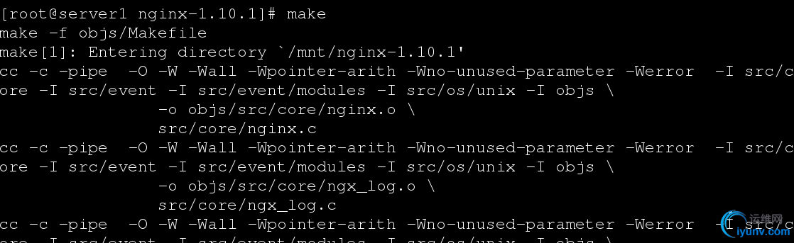

3.编译、链接、安装
[iyunv@server1 nginx-1.10.1]# make
[iyunv@server1 nginx-1.10.1]# make install

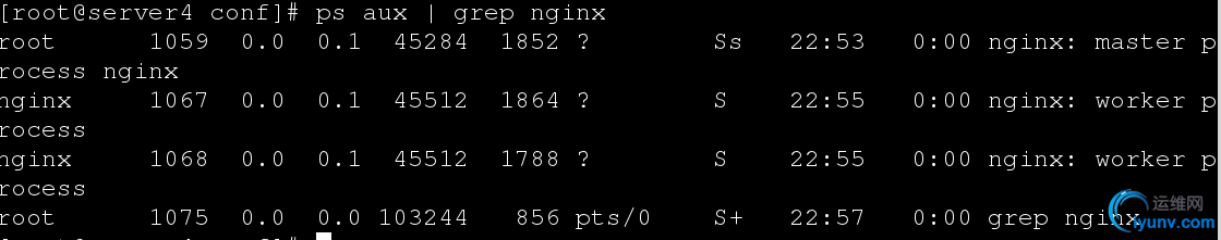

[iyunv@server1 conf]# vim nginx.conf
  2 user  nginx;    #修改nginx的用户
  3 worker_processes  2;   #工作进程,两块cpu
  4 worker_cpu_affinity01 10;  #绑定cpu
[iyunv@server1 conf]# nginx -t   #检测
nginx: the configuration file/usr/local/lnmp/nginx/conf/nginx.conf syntax is ok
nginx: configuration file /usr/local/lnmp/nginx/conf/nginx.conftest is successful
[iyunv@server1 conf]# nginx -s reload   #重载
测试
[iyunv@server1 conf]# ps aux | grep nginx

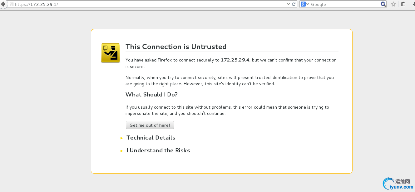

[iyunv@server4 conf]# vim nginx.conf    #访问加密
101     #
102     server {
103         listen       443 ssl;
104        server_name  localhost;
105
106        ssl_certificate      cert.pem;
107        ssl_certificate_key  cert.pem;
108
109         ssl_session_cache    shared:SSL:1m;
110        ssl_session_timeout  5m;
111
112        ssl_ciphers  HIGH:!aNULL:!MD5;
113        ssl_prefer_server_ciphers  on;
114
115         location / {
116             root   html;
117            index  index.html index.htm;
118         }
119     }
120
[iyunv@server1 conf]# cd /etc/pki/tls/certs/
[iyunv@server1 certs]# make cert.pem    #生成自定义签名证书
umask 77 ; \
    PEM1=`/bin/mktemp/tmp/openssl.XXXXXX` ; \
    PEM2=`/bin/mktemp/tmp/openssl.XXXXXX` ; \
    /usr/bin/openssl req-utf8 -newkey rsa:2048 -keyout $PEM1 -nodes -x509 -days 365 -out $PEM2-set_serial 0 ; \
    cat $PEM1 >  cert.pem ; \
    echo ""    >> cert.pem ; \
    cat $PEM2 >>cert.pem ; \
    rm -f $PEM1 $PEM2
Generating a 2048 bit RSA private key
writing new private key to '/tmp/openssl.9egbT2'
You are about to be asked to enter information that will beincorporated
into your certificate request.
What you are about to enter is what is called a DistinguishedName or a DN.
There are quite a few fields but you can leave some blank
For some fields there will be a default value,
If you enter '.', the field will be left blank.
Country Name (2 letter code) [XX]:CN
State or Province Name (full name) []:Shaanxi
Locality Name (eg, city) [Default City]:xi'an
Organization Name (eg, company) [Default Company Ltd]:wen
Organizational Unit Name (eg, section) []:linux
Common Name (eg, your name or your server's hostname)[]:server1.example.com
Email Address []:root@server1.example.com
[iyunv@server1 certs]# mv cert.pem /usr/local/lnmp/nginx/conf/
[iyunv@server1 certs]# nginx -t
[iyunv@server1 certs]# nginx -s reload
测试 https://172.25.29.1
选择 I Understand the Risks,确认
