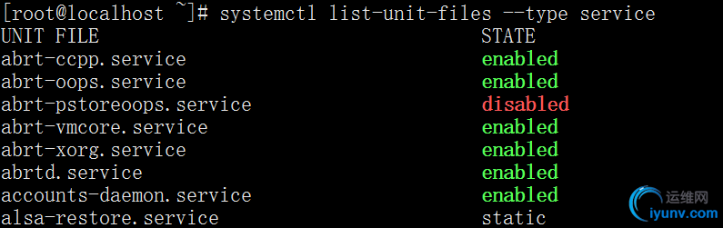

查看所有服务的开机自启状态:
chkconfig --list ==> systemctl list-unit-files --type service

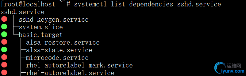

查看服务的依赖关系:
systemctl list-dependencies name.service
