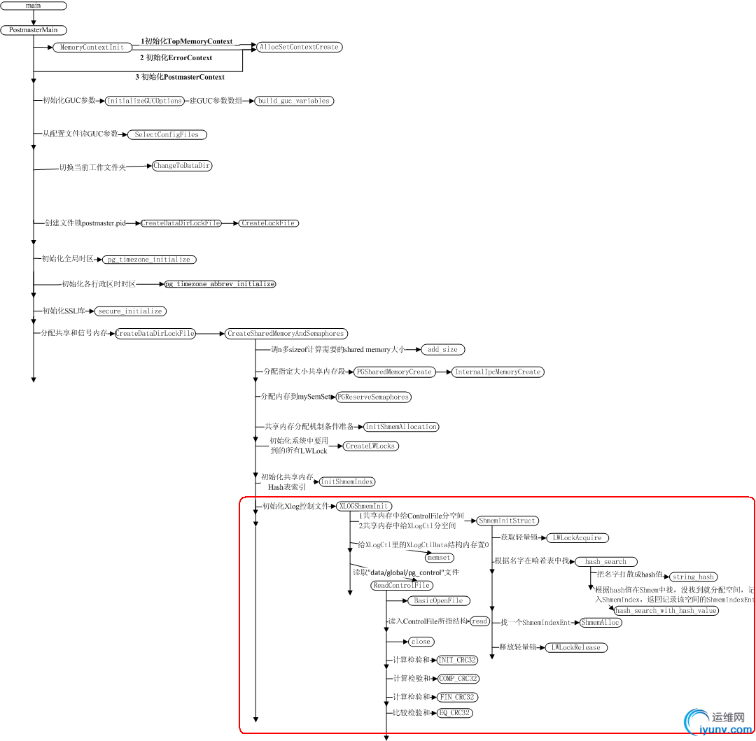

        pg初始化完shmem,给其加上索引"ShmemIndex"后,接着就在shmem里初始化xlog。
1先上个图,看一下函数调用过程梗概,中间略过部分细节
初始化xlog方法调用流程图
2初始化xlog相关结构
话说main()->…->PostmasterMain()->…->reset_shared() ->CreateSharedMemoryAndSemaphores()>…->XLOGSHmemInit(),初始化控制文件data/global/pg_control相关数据结构及事务日志xlog相关数据结构,相关结构定义在下面。

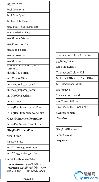

typedef struct ControlFileData
        * Unique system identifier --- to ensure wematch up xlog files with the
        * installation that produced them.
       uint64           system_identifier;
        * Version identifier information.   Keep these fields at the same offset,
        * especially pg_control_version; they won't bereal useful if they move
        * around.   (Forhistorical reasons they must be 8 bytes into the file
        * rather than immediately at the front.)
        * pg_control_version identifies the format ofpg_control itself.
        * catalog_version_no identifies the format ofthe system catalogs.
        * There are additional version identifiers inindividual files; for
        * example, WAL logs contain per-page magic numbersthat can serve as
        * version cues for the WAL log.
       uint32           pg_control_version;         /* PG_CONTROL_VERSION */
       uint32           catalog_version_no;        /* see catversion.h */
        * System status data
       DBState        state;                   /*see enum above */
       pg_time_t    time;                    /*time stamp of last pg_control update */
       XLogRecPtr  checkPoint;        /*last check point record ptr */
       XLogRecPtr  prevCheckPoint; /* previous check point recordptr */
       CheckPoint checkPointCopy; /* copy of last check pointrecord */
        * These two values determine the minimum pointwe must recover up to
        * before starting up:
        * minRecoveryPoint is updated to the latestreplayed LSN whenever we
        * flush a data change during archive recovery.That guards against
        * starting archive recovery, aborting it, andrestarting with an earlier
        * stop location. If we've already flushed datachanges from WAL record X
        * to disk, we mustn't start up until we reachX again. Zero when not
        * doing archive recovery.
        * backupStartPoint is the redo pointer of thebackup start checkpoint, if
        * we are recovering from an online backup andhaven't reached the end of
        * backup yet. It is reset to zero when the endof backup is reached, and
        * we mustn't start up before that. A booleanwould suffice otherwise, but
        * we use the redo pointer as a cross-checkwhen we see an end-of-backup
        * record, to make sure the end-of-backuprecord corresponds the base
        * backup we're recovering from.
       XLogRecPtr  minRecoveryPoint;
       XLogRecPtr  backupStartPoint;
        * Parameter settings that determine if the WALcan be used for archival
        * or hot standby.
       int                 wal_level;
       int                 MaxConnections;
       int                 max_prepared_xacts;
       int                 max_locks_per_xact;
        * This data is used to check for hardware-architecturecompatibility of
        * the database and the backendexecutable.  We need not check endianness
        * explicitly, since the pg_control versionwill surely look wrong to a
        * machine of different endianness, but we doneed to worry about MAXALIGN
        * and floating-point format.  (Note: storage layout nominally also
        * depends on SHORTALIGN and INTALIGN, but inpractice these are the same
        * on all architectures of interest.)
        * Testing just one double value is not a verybulletproof test for
        * floating-point compatibility, but it willcatch most cases.
       uint32           maxAlign;           /* alignment requirement for tuples */
       double         floatFormat;       /* constant 1234567.0 */
#define FLOATFORMAT_VALUE      1234567.0
        * This data is used to make sure that configurationof this database is
        * compatible with the backend executable.
       uint32           blcksz;                 /* data block size for this DB */
       uint32           relseg_size;   /* blocks per segment of large relation */
       uint32           xlog_blcksz; /* block size within WAL files */
       uint32           xlog_seg_size;     /* size of each WAL segment */
       uint32           nameDataLen;  /* catalog name field width */
       uint32           indexMaxKeys;   /* max number of columns in an index */
       uint32           toast_max_chunk_size;   /* chunk size in TOAST tables */
       /*flag indicating internal format of timestamp, interval, time */
       bool             enableIntTimes; /* int64 storageenabled? */
       /*flags indicating pass-by-value status of various types */
       bool             float4ByVal; /* float4 pass-by-value? */
       bool             float8ByVal; /* float8, int8, etc pass-by-value? */
       /*CRC of all above ... MUST BE LAST! */
       pg_crc32     crc;
} ControlFileData;
 * Bodyof CheckPoint XLOG records.  This isdeclared here because we keep
 * acopy of the latest one in pg_control for possible disaster recovery.
 *Changing this struct requires a PG_CONTROL_VERSION bump.
typedef struct CheckPoint
       XLogRecPtr  redo;                   /*next RecPtr available when we began to
                                                         * create CheckPoint (i.e. REDO start point) */
       TimeLineID    ThisTimeLineID; /* current TLI */
       uint32           nextXidEpoch;   /* higher-order bits of nextXid */
       TransactionIdnextXid;           /* next free XID */
       Oid               nextOid;             /* next free OID */
       MultiXactIdnextMulti;            /* next freeMultiXactId */
       MultiXactOffsetnextMultiOffset;  /* next free MultiXactoffset */
       TransactionIdoldestXid;  /* cluster-wide minimumdatfrozenxid */
       Oid               oldestXidDB;       /* database with minimum datfrozenxid */
       pg_time_t    time;                    /*time stamp of checkpoint */
        * Oldest XID still running. This is onlyneeded to initialize hot standby
        * mode from an online checkpoint, so we onlybother calculating this for
        * online checkpoints and only when wal_levelis hot_standby. Otherwise
        * it's set to InvalidTransactionId.
       TransactionIdoldestActiveXid;
} CheckPoint;

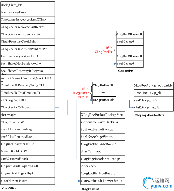

 * Total shared-memorystate for XLOG.
typedef struct XLogCtlData
    /* Protected byWALInsertLock: */
    XLogCtlInsertInsert;
    /* Protected byinfo_lck: */
    XLogwrtRqstLogwrtRqst;
    XLogwrtResultLogwrtResult;
    uint32      ckptXidEpoch;   /* nextXID & epoch of latest checkpoint */
    TransactionIdckptXid;
    XLogRecPtr  asyncXactLSN;   /*LSN of newest async commit/abort */
    uint32      lastRemovedLog; /* latest removed/recycledXLOG segment */
    uint32      lastRemovedSeg;
    /* Protected byWALWriteLock: */
    XLogCtlWrite Write;
     * These values do not change after startup,although the pointed-to pages
     * and xlblocks values certainly do.  Permission to read/write the pages
     * and xlblocks values depends on WALInsertLockand WALWriteLock.
    char      *pages;          /* buffers forunwritten XLOG pages */
    XLogRecPtr*xlblocks;       /* 1st byte ptr-s +XLOG_BLCKSZ */
    int         XLogCacheBlck;  /* highest allocated xlog buffer index */
    TimeLineID  RecoveryTargetTLI;
     * archiveCleanupCommand is read fromrecovery.conf but needs to be in
     * shared memory so that the bgwriter processcan access it.
    char        archiveCleanupCommand[MAXPGPATH];
     * SharedRecoveryInProgress indicates if we'restill in crash or archive
     * recovery. Protected by info_lck.
    bool        SharedRecoveryInProgress;
     * SharedHotStandbyActive indicates if we'restill in crash or archive
    bool        SharedHotStandbyActive;
     * recoveryWakeupLatch is used to wake up thestartup process to continue
     * WAL replay, if it is waiting for WAL toarrive or failover trigger file
     * to appear.
    Latch       recoveryWakeupLatch;
     * During recovery, we keep a copy of thelatest checkpoint record here.
     * Used by the background writer when it wantsto create a restartpoint.
     * Protected by info_lck.
    XLogRecPtr  lastCheckPointRecPtr;
    CheckPoint  lastCheckPoint;
    /* end+1 of the lastrecord replayed (or being replayed) */
    XLogRecPtr  replayEndRecPtr;
    /* end+1 of the lastrecord replayed */
    XLogRecPtr  recoveryLastRecPtr;
    /* timestamp of lastCOMMIT/ABORT record replayed (or being replayed) */
    TimestampTzrecoveryLastXTime;
    /* Are we requestedto pause recovery? */
    bool        recoveryPause;
    slock_t     info_lck;       /*locks shared variables shown above */
} XLogCtlData;
 * Shared state datafor XLogInsert.
typedef struct XLogCtlInsert
    XLogwrtResultLogwrtResult; /* a recent value of LogwrtResult */
    XLogRecPtr  PrevRecord;     /*start of previously-inserted record */
    int         curridx;        /* current block index in cache */
    XLogPageHeadercurrpage;    /* points to header of blockin cache */
    char      *currpos;        /* currentinsertion point in cache */
    XLogRecPtr  RedoRecPtr;     /*current redo point for insertions */
    bool        forcePageWrites;    /* forcing full-page writes for PITR? */
     * exclusiveBackup is true if a backup startedwith pg_start_backup() is
     * in progress, and nonExclusiveBackups is acounter indicating the number
     * of streaming base backups currently inprogress. forcePageWrites is set
     * to true when either of these is non-zero.lastBackupStart is the latest
     * checkpoint redo location used as a startingpoint for an online backup.
    bool        exclusiveBackup;
    int         nonExclusiveBackups;
    XLogRecPtr  lastBackupStart;
} XLogCtlInsert;
在XLOGSHmemInit()函数里,首先在shmem的哈希表索引"ShmemIndex"上给控制文件pg_control增加一个HashElementShmemIndexEntentry),在shmem里根据ControlFileData大小调用ShmemAlloc()分配内存空间,使ShmemIndexEnt的成员location指向该空间,size成员记录该空间大小。
XLOGSHmemInit()调用ShmemInitStruct(),在其中调用hash_search()在哈希表索引"ShmemIndex"中查找"XLOGCtl",如果没有,就在shmemIndex中给"XLOG Ctl"分一个HashElement和ShmemIndexEntentry),在其中的Entry中写上"XLOG Ctl"。返回ShmemInitStruct(),再调用ShmemAlloc()在共享内存上给"XLOG Ctl"相关结构(见下面“XLog相关结构图”)分配空间,设置entry(在这儿及ShmemIndexEnt类型变量)的成员location指向该空间,size成员记录该空间大小,最后返回XLOGShmemInit(),让XLogCtlData *类型静态全局变量XLogCtl指向在shmem里给"XLOG Ctl"相关结构分配的内存地址,设置其中XLogCtlData结构类型的成员值。初始化完成后数据结构如下图。
初始化完xlog的内存结构图

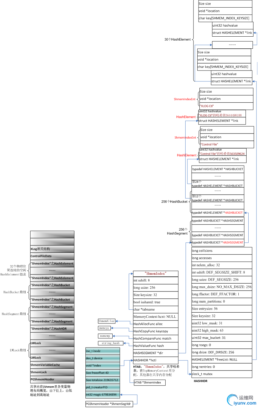

       为了精简上图,把创建shmem的哈希表索引"ShmemIndex"时创建的HCTL结构删掉了,这个结构的作用是记录创建可扩展哈希表的相关信息。增加了左边灰色底的部分,描述共享内存/shmem里各变量物理布局概览,由下往上,由低地址到高地址。其中的"Control File"即ControlFileDate和"XLOG Ctl"即xlog的相关结构图下面分别给出,要不上面的图太大了。
控制文件结构图
       上图中ControlFileData结构中的XLogRecPtr和CheckPoint不是指针,因此应该用右边的相应结构图代替,把这两个合进去有点费劲,将就着看吧。
XLog相关结构图
