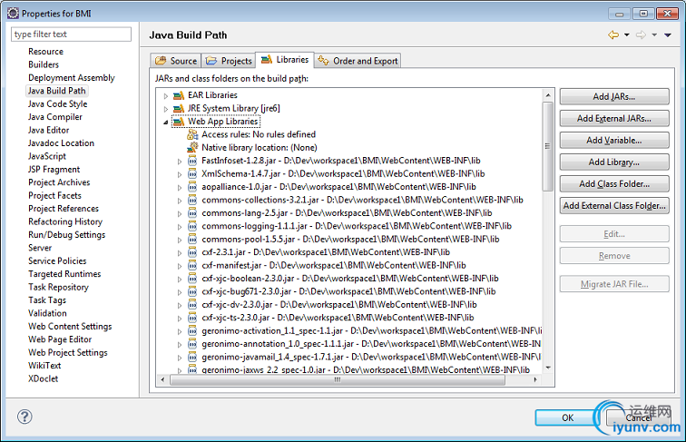

3) After unzipping the archive, I added to WEB-INF/lib all the libraries that are inside the apache-cxf-2.3.1\lib
folder. It is of course not a good habit to have since adding all sorts of libraries can produces conflicts.
I had to remove a few jars such as :
jaxb-xjc-2.2.1.1.jar, xalan-2.7.1.jar and serializer-2.7.1.jar
Anyways here is the list of jars that i have added to WEB-INF/lib :

There are probably a few extras jars that are not needed but at least they do not produce any error for that simple web service.

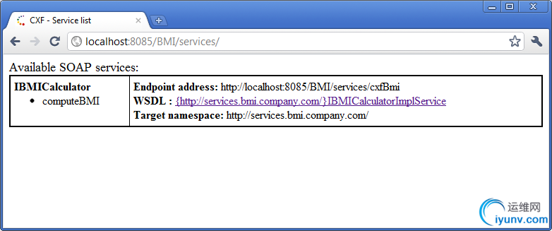

9) The available SOAP services are listed at the following URL :
http://localhost:8085/BMI/services/

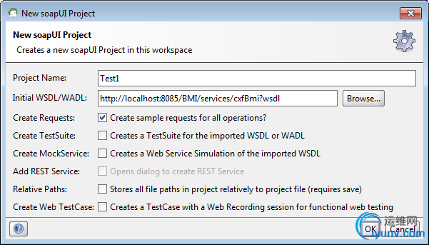

Another way to test the Web Service is by using soapUI. First create a new SoapUi project (Ctrl+n), give
the project a name and add the WSDL file or URL :
