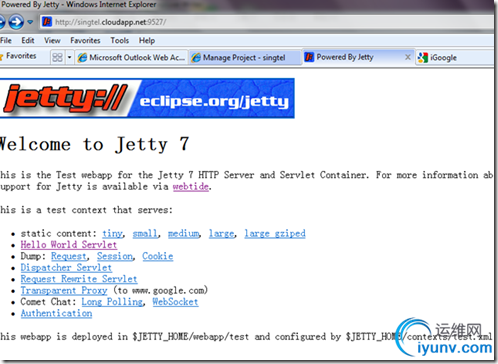

    效果:http://singtel.cloudapp.net:9527/

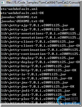

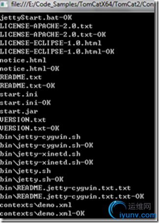

  这2个东西也可以打包到项目里面上传,但是那样文件太大了,这里先上传到 Blob里面.一个简单的上传程序:  ---
DSC0001.gif DSC0002.gif Upload to blobstatic void Main(string[] args)
const string config = @"*************";
CloudStorageAccount acct = CloudStorageAccount.Parse(config);
CloudBlobClient blobclient = acct.CreateCloudBlobClient();
var container = blobclient.GetContainerReference("jre6");
container.CreateIfNotExist();
Upload(container);
private static void Upload(CloudBlobContainer container)
List<string> failed = new List<string>();
string baseDir = @"C:\Temp\jre6\";
var files = GetFiles(baseDir);
foreach (string file in files)
try
string fileName = file.Replace(baseDir, string.Empty);
Console.WriteLine(fileName);
var blob = container.GetBlobReference(fileName);
blob.DeleteIfExists();
using (FileStream sr = File.Open(file, FileMode.Open))
blob.UploadFromStream(sr);
Console.WriteLine(fileName + "-OK");
Thread.Sleep(100);
catch
failed.Add(file);
foreach (var item in failed)
Console.WriteLine(item + "-Failed");
Console.WriteLine("All OK");
Console.ReadKey();

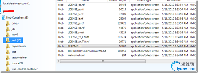

  上传jre和jetty到blob.
使用Azure Storage Explorer看看

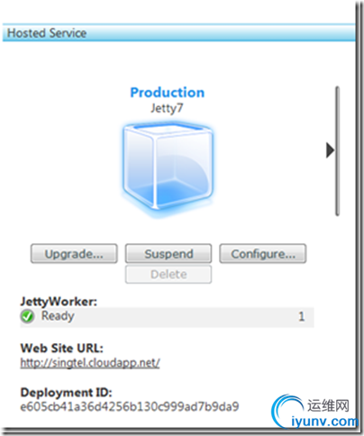

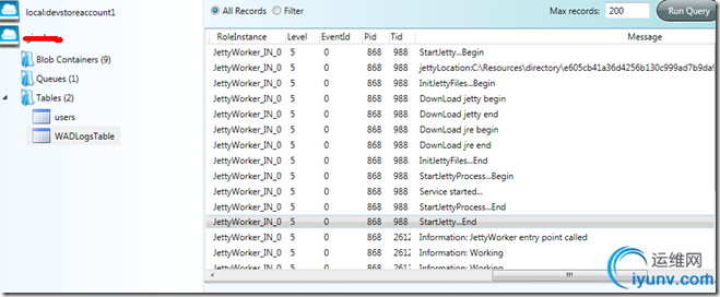

  4.发布程序,查看Trace信息和执行效果.
PS:这里仅仅是记录了一下在Windows azure平台上面运行jetty. demo的代码很乱,还有很多东西也没考虑,比如对jetty运行状况的监控等等.不过,有了Native Code Support ,LocalStorage  的支持,你可以在该平台上运行一些你想的程序了,比如mysql (http://microsoftpdc.com/Sessions/SVC51)
