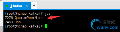

        Kafka用到了Zookeeper,所有首先启动Zookper
  [iyunv@hchao kafka]# cd kafka
  [iyunv@hchao kafka]# bin/zookeeper-server-start.sh  config/zookeeper.properties &
  查看下是否启动

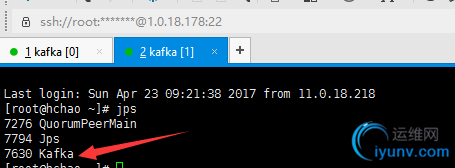

  然后启动Kafka:
  [iyunv@hchao kafka]# bin/kafka-server-start.sh config/server.properties
  这时候看下 kafka是否启动了

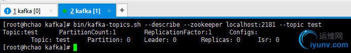

  查看主题详情
  [iyunv@hchao kafka]# bin/kafka-topics.sh --describe --zookeeper localhost:2181 --topic test

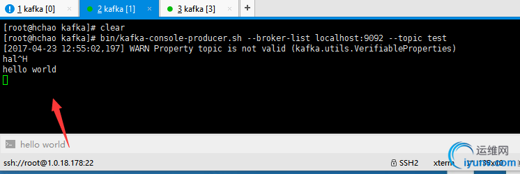

  ok,下面我们创建一个producer 创建完并发送hello
  [iyunv@hchao kafka]# bin/kafka-console-producer.sh --broker-list localhost:9092 --topic test

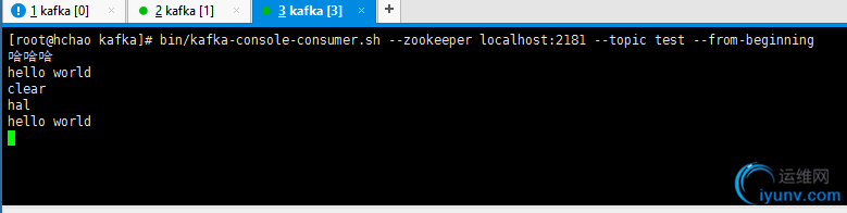

  有了producer ,下面来个consumer 可以看到刚才发的消息都过来了
  [iyunv@hchao kafka]# bin/kafka-console-consumer.sh --zookeeper localhost:2181 --topic test --from-beginning
