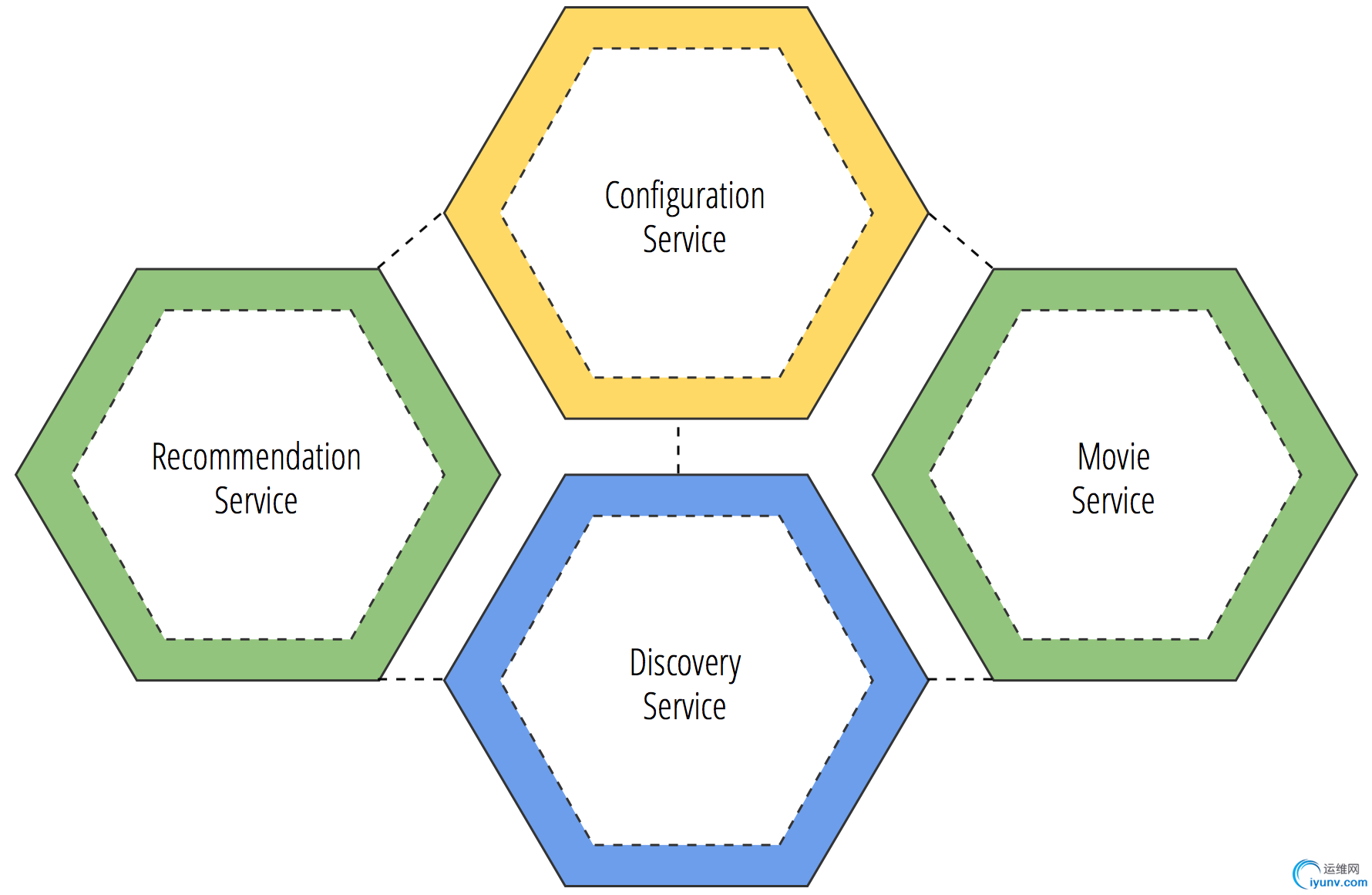

  Each service has a dedicated purpose in a microservices architecture. When building a microservices architecture on Spring Cloud, there are a few primary concerns to deal with first. The first two microservices you will want to create are the Configuration Service, and the Discovery Service.
  在微服务框架下,每个服务都只专注于一个目标。用Spring Cloud搭建微服务框架的时候,有几个先要处理的关键点。首先要创建的两个微服务是:配置服务(configuration service)和发现服务(discovery service)。
  The graphic above illustrates a 4-microservice setup, with the connections between them indicating a dependency.
  上面的图片演示了一个由4个微服务组成的系统,以及他们之间的依赖关系。
  The configuration service sits at the top, in yellow, and is depended on by the other microservices. The discovery service sits at the bottom, in blue, and also is depended upon by the other microservices.
  在最上面的黄色标记的配置服务(configuration service),被其他所有的微服务所依赖。最下面的蓝色标记的发现服务(discovery service),同样是被其他所有的微服务所依赖。
  In green, we have two microservices that deal with a part of the domain of the example application I will use throughout this blog series: movies and recommendations.
  绿色的两个微服务将会作为例子,贯穿整篇文章。他们分别提供电影播放和简介的服务。

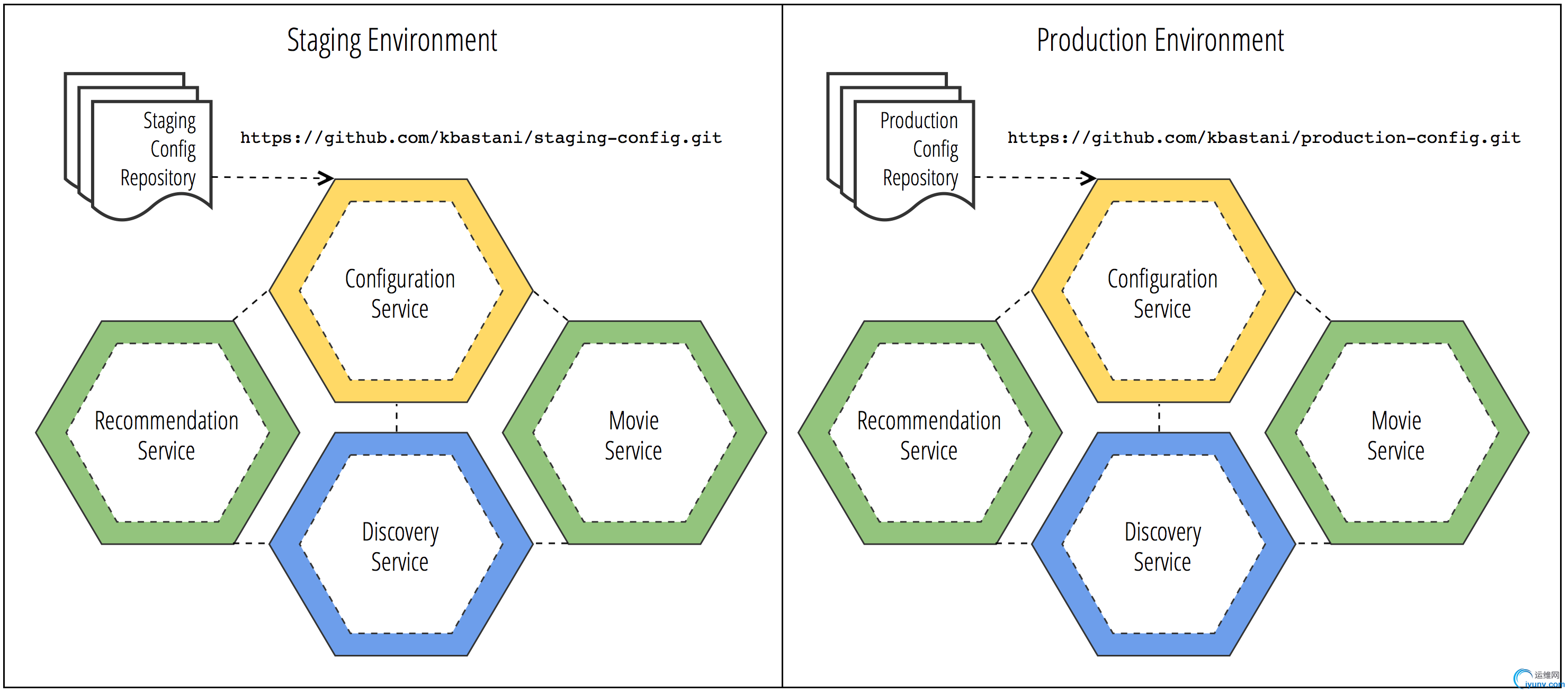

  Let's assume that we have multiple deployment environments. If we have a staging environment and a production environment, configurations for those environments will be different. A configuration service might have a dedicated Git repository for the configurations of that environment. None of the other environments will be able to access this configuration, it is available only to the configuration service running in that environment.
  假设我们有多个部署环境。一个测试环境,一个生产环境,他们的配置信息肯定是不一样的。配置服务(configuration service)会有一个独立的Git仓库,每个环境只会读取自己专属的配置信息。
  When the configuration service starts up, it will reference the path to those configuration files and begin to serve them up to the microservices that request those configurations. Each microservice can have their configuration file configured to the specifics of the environment that it is running in. In doing this, the configuration is both externalized and centralized in one place that can be version-controlled and revised without having to restart a service to change a configuration.
  当配置服务(configuration service)启动之后,他会根据路径为其他的微服务们提供读取配置文件的服务。每个微服务都拥有它正在运行的环境所使用的配置文件。实现了配置信息的外置化、集中化,并将它们置于版本控制下。这样一来,修改配置信息也就不用重启(配置)服务了。
  With management endpoints available from Spring Cloud, you can make a configuration change in the environment and signal a refresh to the discovery service that will force all consumers to fetch the new configurations.
  基于Spring Cloud对端点的管理,你可以在修改配置信息之后,刷新发现服务(discovery service),即实现了调用者(consumers)去提取新的配置信息。

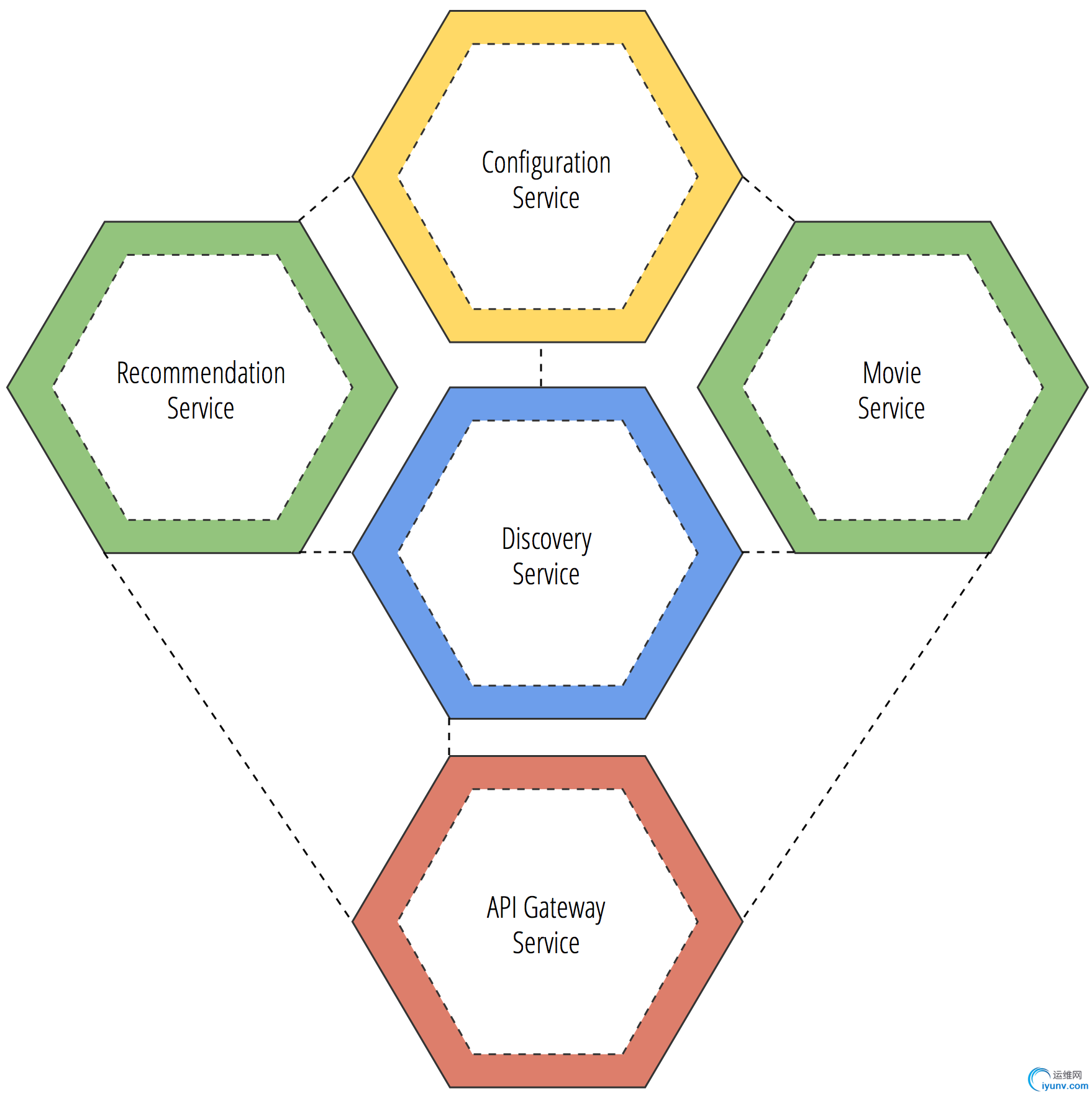

  API Gateway
  API 网关服务
  The API gateway service is another vital component if we are going to create a cluster of services managing their own domain entities. The green hexagons below are our data-driven services that manage their own domain entities and even their own databases. By adding an API gateway service, we can create a proxy of each API route that are exposed by the green services.
  如果我们想要创建一个服务集群来管理他们自己的域实体(注),那么,API网关服务(API Gateway)也是一个必不可少的组件。
  Let’s assume that both the recommendation service and the movie service expose their own REST API over the domain entities that they manage. The API gateway will discover these services through the discovery service and inject a proxy-based route of the API methods from the other services. In this way, both the recommendation and movie microservice will have a full definition of routes available locally from all the microservices that expose a REST API. The API Gateway will re-route the request to the service instances that own the route being requested through HTTP.
  让我们假设刚才介绍的两个服务和movie服务已经通过域实体暴露了REST API。API网关服务(API Gateway)会通过发现服务(discovery service)发现这些服务,并且将它们的接口函数,从其他服务那里注入基于代理的路由。这样,上面说的三个服务就具有了完整的REST API的路由(serviceID+apiUrl)。API网关服务(API Gateway)将接口调用重定向成HTTP请求到对应的服务实例上。
