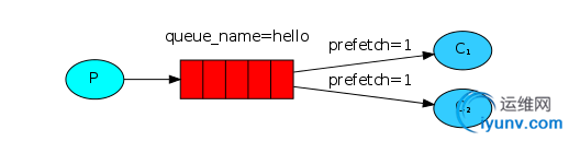

//修改分发机制(原先是轮询分发), prefetchCount = 1 变为 不向正在处理的worker发发任务,谁先有空就给谁
//In order to defeat that we can use the basicQos method with the prefetchCount = 1 setting.
//This tells RabbitMQ not to give more than one message to a worker at a time.
//Or, in other words, don't dispatch a new message to a worker until it has processed and acknowledged the previous one.
//Instead, it will dispatch it to the next worker that is not still busy.
channel.BasicQos(prefetchSize: 0, prefetchCount: 1, global: false);
