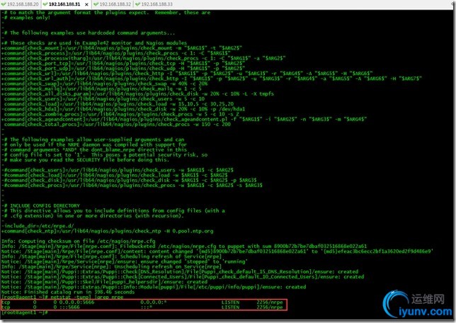

在clients上安装puppet客户端
1  [iyunv@agent1 ~]# yum install -y puppet
2  [iyunv@agent1 ~]# chkconfig puppet on
3  [iyunv@agent1 ~]# service puppet start

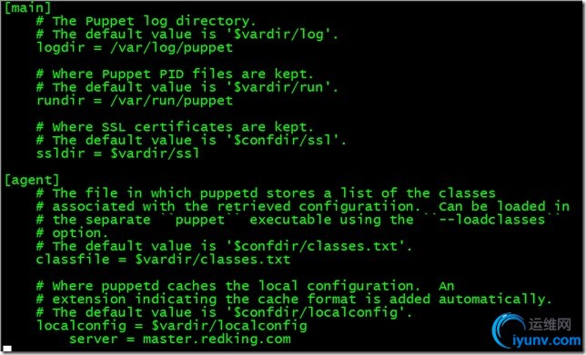

3.配置puppet
对于puppet 客户端,修改/etc/puppet/puppet.conf,指定master服务器
并重启puppet服务
1  [iyunv@agent1 ~]# service puppet restart

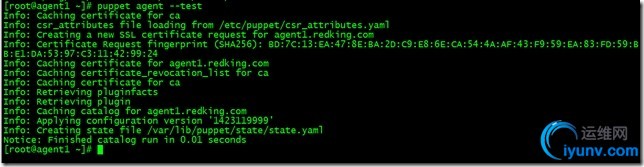

client需要向服务器端发出请求, 让服务器对客户端进行管理. 这其实是一个证书签发的过程. 第一次运行 puppet 客户端的时候会生成一个 SSL 证书并指定发给 Puppet 服务端, 服务器端如果同意管理客户端,就会对这个证书进行签发,可以用这个命令来签发证书,由于我们已经在客户端设置了server地址,因此不需要跟服务端地址
1  [iyunv@agent1 ~]# puppet agent --test

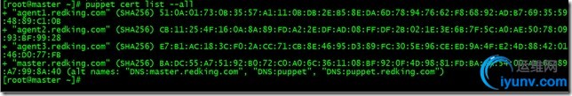

就可以申请证书了,由于我配置的自动签发证书,所以直接就签发了,在服务端执行
1  [iyunv@master ~]# puppet cert list --all

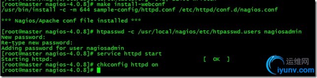

在Apache的conf.d目录中安装Nagios Web配置文件
1  [iyunv@master nagios-4.0.8]# make install-webconf
创建nagiosadmin帐号登录Nagios Web接口
1  [iyunv@master nagios-4.0.8]# htpasswd -c /usr/local/nagios/etc/htpasswd.users nagiosadmin
2  [iyunv@master nagios-4.0.8]# service httpd start
3  Starting httpd:                                            [  OK  ]
4  [iyunv@master nagios-4.0.8]# chkconfig httpd on
开启httpd服务使配置生效并设置开机自启

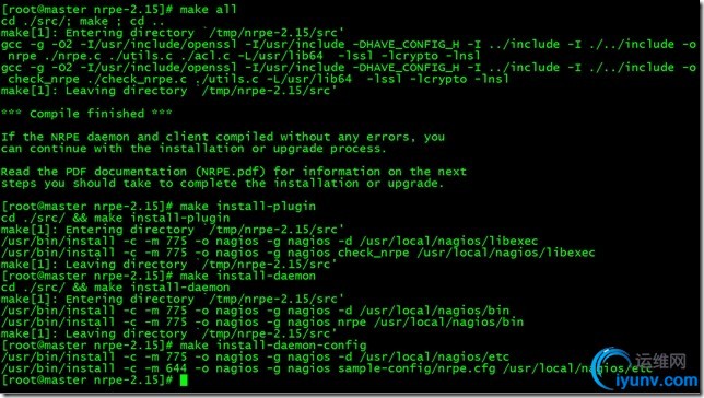

8.编译安装Nrpe
1  [iyunv@master tmp]# tar zxvf nrpe-2.15.tar.gz
2  [iyunv@master nrpe-2.15]# ./configure
3  [iyunv@master nrpe-2.15]# make all
4  [iyunv@master nrpe-2.15]# make install-plugin
5  [iyunv@master nrpe-2.15]# make install-daemon
6  [iyunv@master nrpe-2.15]# make install-daemon-config

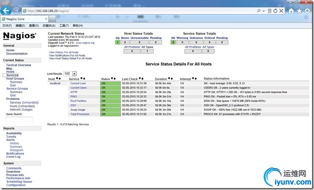

启动Nagios之前测试配置文件

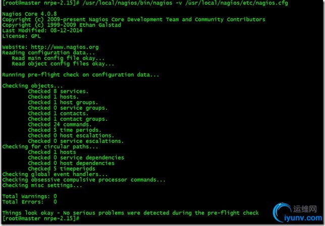

1  [iyunv@master ~]# /usr/local/nagios/bin/nagios -v /usr/local/nagios/etc/nagios.cfg
启动Nagios、nrpe并设置开机自启
1   [iyunv@master ~]# chkconfig nagios --add
2   [iyunv@master ~]# chkconfig --list |grep nagios
3   nagios          0:off   1:off   2:off   3:on    4:on    5:on    6:off
4   [iyunv@master ~]# chkconfig nagios on
5   [iyunv@master ~]# service nagios start
6   Starting nagios: done.
7   [iyunv@master ~]# echo "/usr/local/nagios/bin/nrpe -c /usr/local/nagios/etc/nrpe.cfg -d" >> /etc/rc.d/rc.local
8   [iyunv@master nrpe-2.15]# /usr/local/nagios/bin/nrpe -c /usr/local/nagios/etc/nrpe.cfg -d
9   [iyunv@master nrpe-2.15]# netstat -tunpl |grep nrpe
10  tcp 0 0 0.0.0.0:5666 0.0.0.0:* LISTEN 70100/nrpe
11  tcp 0 0 :::5666 :::* LISTEN 70100/nrpe
12  [iyunv@master nrpe-2.15]#

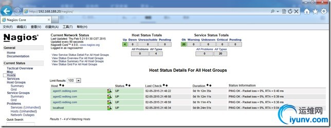

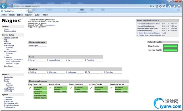

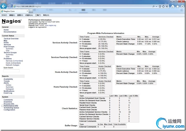

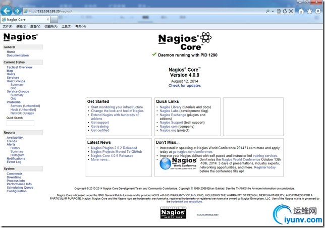

执行/usr/local/nagios/libexec/check_nrpe -H 127.0.0.1检查连接是否正常
使用之前定义的nagiosadmin帐号与密码登录Nagios,地址:http://192.168.188.20/nagios/

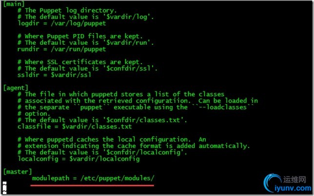

5  [iyunv@master ~]# vim /etc/puppet/puppet.conf
6  [master]
7  modulepath = /etc/puppet/modules/

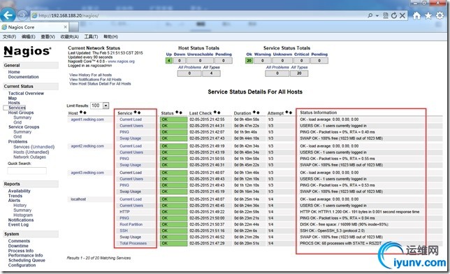

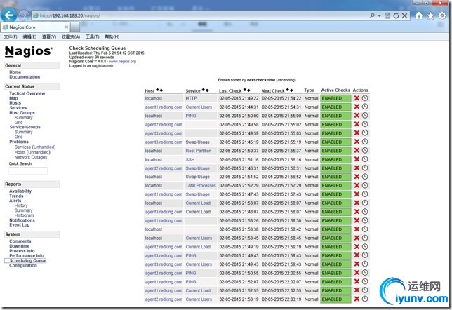

3.配置Nagios添加agent.redking.com主机监控
修改/usr/local/nagios/etc/objects/commands.cfg
command_name check_nrpe ——定义命令名称为check_nrpe,services.cfg必须使用
command_line $USER1$/check_nrpe -H $HOSTADDRESS$ -c $ARG1$ ——用$USER1$代替/usr/local/nagios/libexec
这是定义实际运行的插件程序.这个命令行的书写要完全按照check_nrpe这个命令的用法.不知道用法的就用check_nrpe –h查看; -c后面带的$ARG1$参数是传给nrpe daemon执行的检测命令,它必须是nrpe.cfg中所定义的5条命令中的其中一条。
1  [iyunv@master ~]# vim /usr/local/nagios/etc/objects/commands.cfg
2  # 'check_nrpe' command definition
3  define command{
4  command_name check_nrpe
5  command_line $USER1$/check_nrpe -H $HOSTADDRESS$ -c $ARG1$
6  }
修改/usr/local/nagios/etc/nagios.cfg
1  [iyunv@master ~]# vim /usr/local/nagios/etc/nagios.cfg
2  cfg_file=/usr/local/nagios/etc/objects/agent1.redking.com.cfg

检测Nagios服务并重启使配置生效
2  [iyunv@master ~]# service nagios restart
3  [iyunv@master ~]# service puppetmaster restart
客户端测试
客户端自动部署nrpe

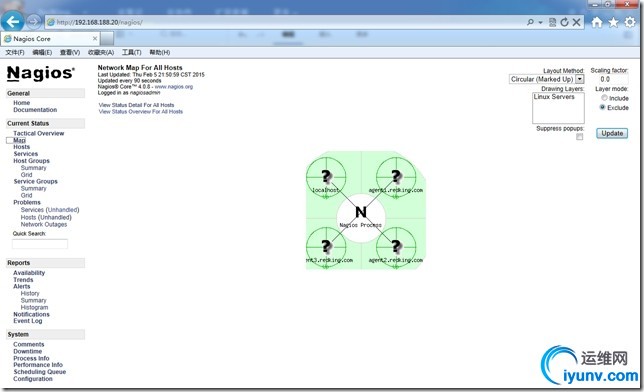

下面我们来看下客户端自动化部署nrpe后采集信息的nagios监控界面
NRPE模块中定义的nrpe.cfg包含大量脚本,我们可以直接拿来使用当然也可以自己修改nrpe.cfg.erb模板内容。在批量部署时可以分别采用自己编写的模块或者现有模块来实现,利用现有模块几乎能实现系统管理日常工作中90%任务,剩余的10%我们可以根据生产业务来自己定制。
