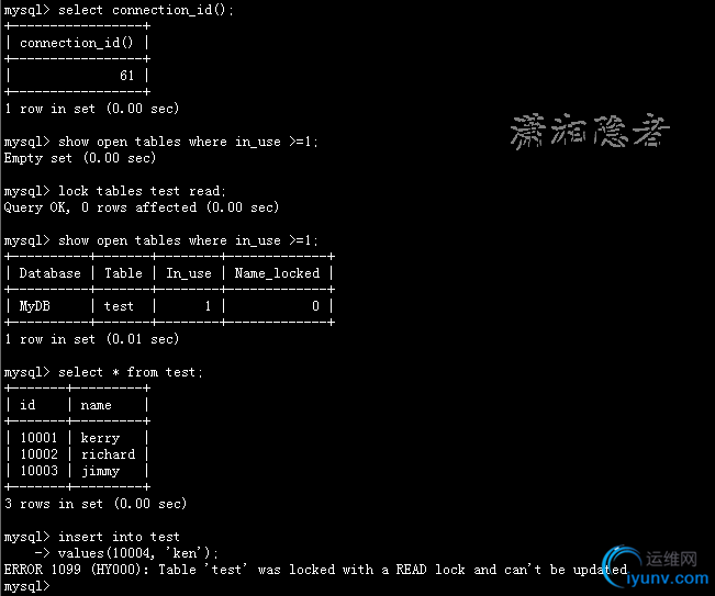

当前会话(会话ID为61)持有test表的READ锁后,那么当前会话只可以读该表,而不能往表中写入数据,否则就会报“Table 'test' was locked with a READ lock and can't be updated”这样的错误。
mysql> select connection_id();+-----------------+| connection_id() |+-----------------+|              61 |+-----------------+1 row in set (0.00 sec) mysql> show open tables where in_use >=1;Empty set (0.00 sec) mysql> lock tables test read;Query OK, 0 rows affected (0.00 sec) mysql> show open tables where in_use >=1;+----------+-------+--------+-------------+| Database | Table | In_use | Name_locked |+----------+-------+--------+-------------+| MyDB     | test  |      1 |           0 |+----------+-------+--------+-------------+1 row in set (0.01 sec) mysql> select * from test;+-------+---------+|>+-------+---------+| 10001 | kerry   || 10002 | richard || 10003 | jimmy   |+-------+---------+3 rows in set (0.00 sec) mysql> insert into test    -> values(10004, 'ken');ERROR 1099 (HY000): Table 'test' was locked with a READ lock and can't be updatedmysql>

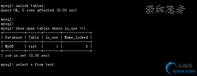

其它会话无法读写表TEST,都会被阻塞,当然也无法获取表TEST的READ锁或WRITE锁。也就是说当一个会话获得一个表上的一个WRITE锁后,那么只有持锁的会话READ或WRITE表,其他会话都会被阻止。
mysql> unlock tables;Query OK, 0 rows affected (0.00 sec) mysql> mysql> mysql> show open tables where in_use >=1;+----------+-------+--------+-------------+| Database | Table | In_use | Name_locked |+----------+-------+--------+-------------+| MyDB     | test  |      1 |           0 |+----------+-------+--------+-------------+1 row in set (0.00 sec) mysql> select * from test;

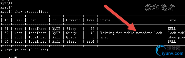

mysql> select connection_id();+-----------------+| connection_id() |+-----------------+|              63 |+-----------------+1 row in set (0.00 sec) mysql> show processlist;+----+------+-----------+------+---------+------+---------------------------------+--------------------+|>+----+------+-----------+------+---------+------+---------------------------------+--------------------+| 61 | root | localhost | MyDB | Sleep   |   86 |                                 | NULL               || 62 | root | localhost | MyDB | Query   |   40 | Waiting for table metadata lock | select * from test || 63 | root | localhost | MyDB | Query   |    0 | init                            | show processlist   || 64 | root | localhost | MyDB | Sleep   | 2551 |                                 | NULL               |+----+------+-----------+------+---------+------+---------------------------------+--------------------+4 rows in set (0.00 sec)

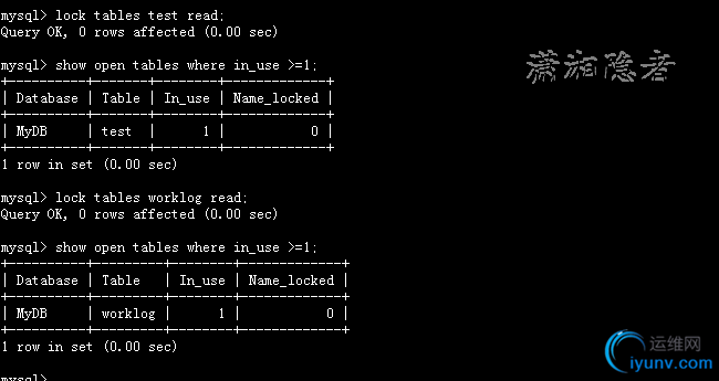

UNLOCK TABLES释放被当前会话持有的任何锁,但是当会话发出另外一个LOCK TABLES时,或当服务器的连接被关闭时,当前会话锁定的所有表会隐式被解锁。下面我们也可以测试看看
mysql> lock tables test read;Query OK, 0 rows affected (0.00 sec) mysql> show open tables where in_use >=1;+----------+-------+--------+-------------+| Database | Table | In_use | Name_locked |+----------+-------+--------+-------------+| MyDB     | test  |      1 |           0 |+----------+-------+--------+-------------+1 row in set (0.00 sec) mysql> lock tables worklog read;Query OK, 0 rows affected (0.00 sec) mysql> show open tables where in_use >=1;+----------+---------+--------+-------------+| Database | Table   | In_use | Name_locked |+----------+---------+--------+-------------+| MyDB     | worklog |      1 |           0 |+----------+---------+--------+-------------+1 row in set (0.00 sec) mysql>
