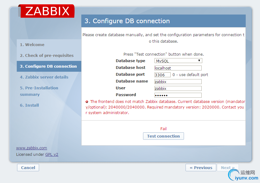

  3.The frontend does not match Zabbix database
[问题原因]  Zabbix的数据库版本号不正确(由于导入的是Zabbix-2.4中的sql)
[解决的方法]  先查看当前Zabbix的版本号号:
root@kallen:~# dpkg -l | grep zabbix
ii  zabbix-agent            1:2.2.2+dfsg-1ubuntu1   i386 network    monitoring solution - agent
ii  zabbix-frontend-php     1:2.2.2+dfsg-1ubuntu1   all     network monitoring solution - PHP front-end
ii  zabbix-server-mysql     1:2.2.2+dfsg-1ubuntu1   i386    network monitoring solution - server (using MySQL)
  确认后又一次导入一下Zabbix数据库的sql
( 源代码包下的路径:zabbix –> database –> mysql –> *.sql )
mysql
|-- data.sql
|-- images.sql
`-- schema.sql
root@kallen:~# mysql -uzabbix -pzabbix zabbix < schema.sql
root@kallen:~# mysql -uzabbix -pzabbix zabbix < images.sql
root@kallen:~# mysql -uzabbix -pzabbix zabbix < data.sql

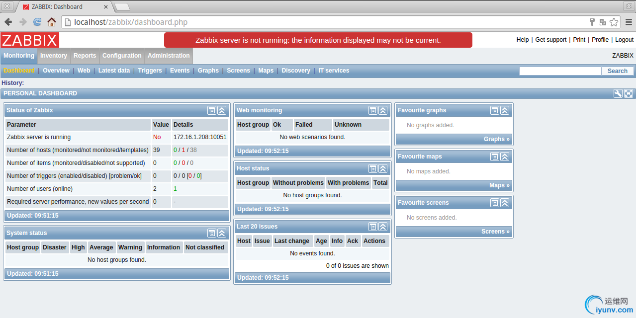

  4.zabbix-server stop/waiting
root@kallen:/etc/default# vim zabbix-server
# defaults file for zabbix-server-mysql
# Start the Zabbix server from the init.d script?
# (Possible values:"yes"or"no")
# This is by default set to"no" because a MySQL database needs to be prepared
# and configured before you can start the Zabbix server for the first time.
# Instructions on how to set up the database can be found in
# /usr/share/doc/zabbix-server-mysql/README.Debian
START=no
# Absolute path to the configuration file
CONFIG_FILE="/etc/zabbix/zabbix_server.conf"
  被设成no了。 当然启动不了。 改成yes, 重新启动就可以:
root@kallen:/etc/default# service zabbix-server start

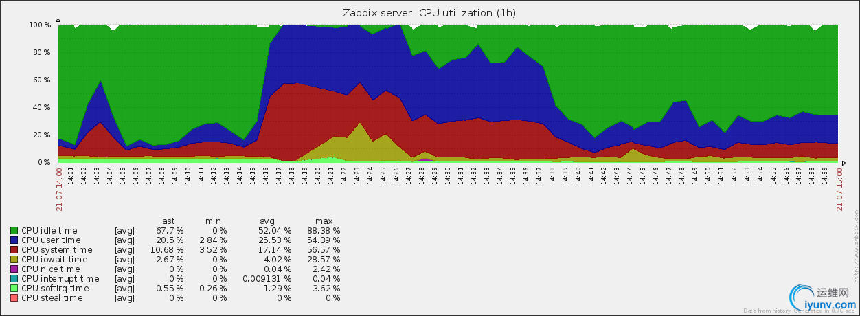

  [附-2]Zabbix监控样图

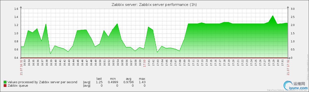

  (1) Server Perfermance

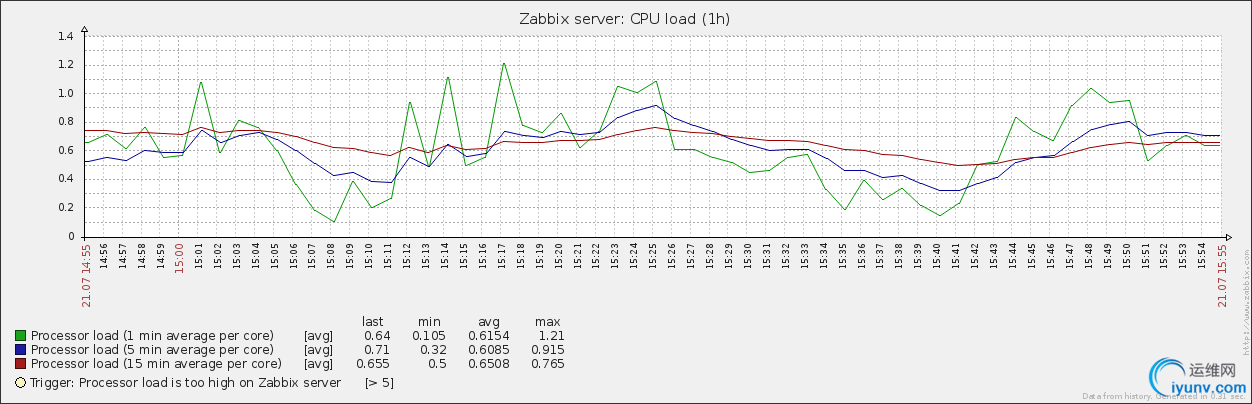

  (2) CPU Load
  (3) Disk Space Usage

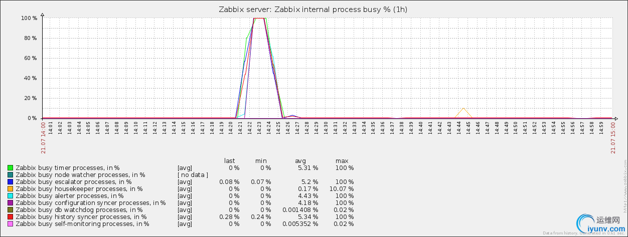

  (4) Internal Process Busy
  (5) Value Cache Effectiveness

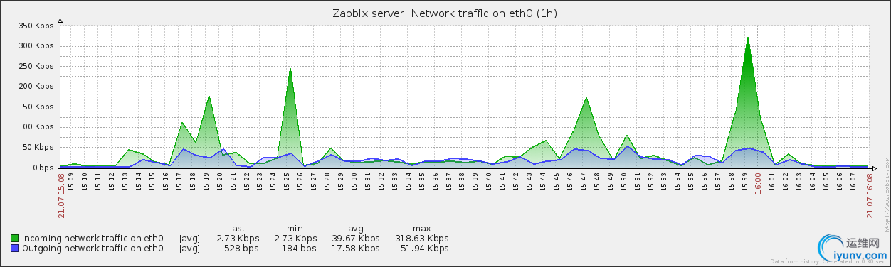

  (6) Network Traffic
  (7) CPU Utilization
  (8) CPU Jumps
  (9) Apache Access
  (10) Apache Processes
  (11) Apache Volume
  【总结】
  结合上述图形及自己对Zabbix使用过程中的体验。个人感觉Zabbix的画图(事实上应该是PHP的画图模块PHP gdd)能力以及效果表现不错。优于Cacti & Nagios (其画图模块为RRD Tools);另外,Zabbix的DashBoard体验也比較好。
