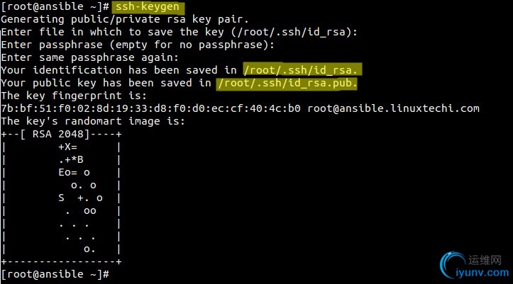

  Generate keys on the Ansible server and copy public key to the nodes.
  在Ansible服务器上生成密钥并复制公钥到节点上。
root@ansible ~]# ssh-keygen

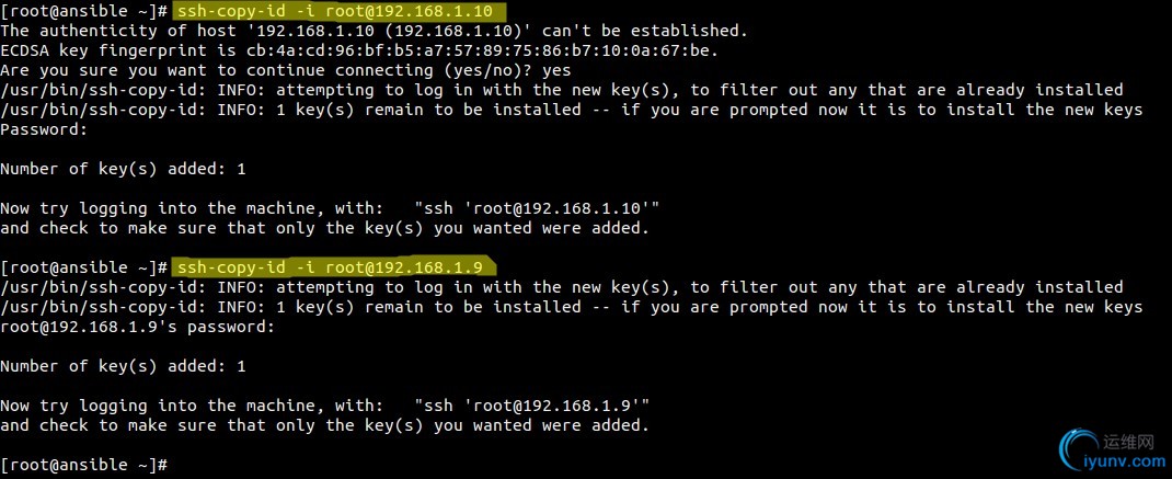

  Use ssh-copy-id command to copy public key of Ansible server to its nodes.
  使用ssh-copy-id命令复制Ansible服务器的公钥到节点服务器上。

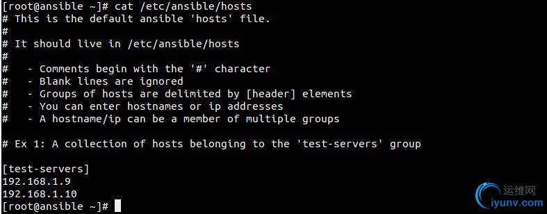

Step:4 Define the nodes or inventory of servers for Ansible.
  为Ansible定义节点或服务器清单列表
  File ‘/etc/ansible/hosts‘ maintains the inventory of servers for Ansible.
  文件‘/etc/ansible/hosts‘保存着Ansible的服务器清单。
[root@ansible ~]# vi /etc/ansible/hosts
[test-servers]
192.168.1.9
192.168.1.10
  Save and exit the file.
  保存退出文件
  Sample output of hosts file.
  hosts文件的简单输出

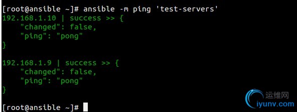

  Check the connectivity of ‘test-servers’ or ansible nodes using ping
  使用ping检查ansible节点和测试服务器的连通性
[root@ansible ~]# ansible -m ping 'test-servers'

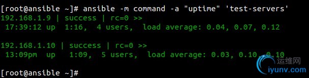

  Example :1 Check the uptime of Ansible nodes
  检查Ansible节点的运行时间
[root@ansible ~]# ansible -m command -a "uptime" 'test-servers'

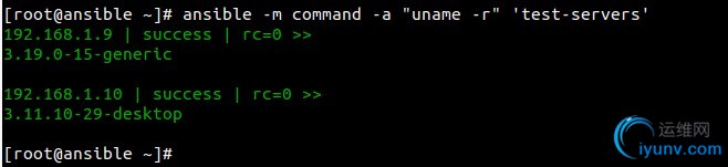

  Example:2 Check Kernel Version of nodes
  检查节点的内核版本号
[root@ansible ~]# ansible -m command -a "uname -r" 'test-servers'

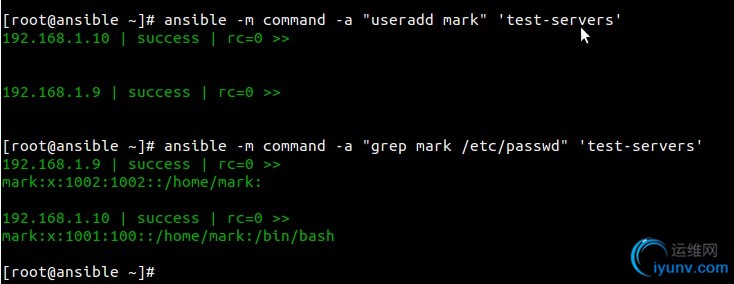

  Example:3 Adding a user to the nodes
  为节点添加一个用户
[root@ansible ~]# ansible -m command -a "useradd mark" 'test-servers'
[root@ansible ~]# ansible -m command -a "grep mark /etc/passwd" 'test-servers'

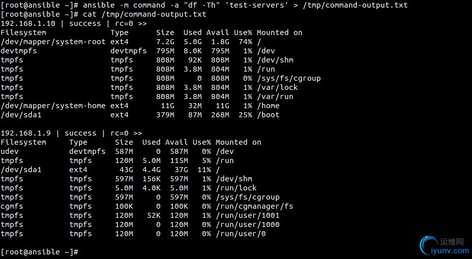

  Example:4 Redirecting the output of command to a file
  把命令重定向输出到一个文件
[root@ansible ~]# ansible -m command -a "df -Th" 'test-servers' > /tmp/command-output.txt
