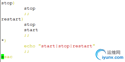

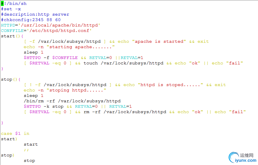

接下来就要去做apache的脚本了,并把其拷贝到/etc/init.d/目录下,并附加其可执行的权限
root@localhost ~]# cp httpd /etc/init.d/
[root@localhost ~]# chmod a+x /etc/init.d/httpd
service httpd start
chkconfig --add httpd
chkconfig httpd on

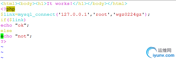

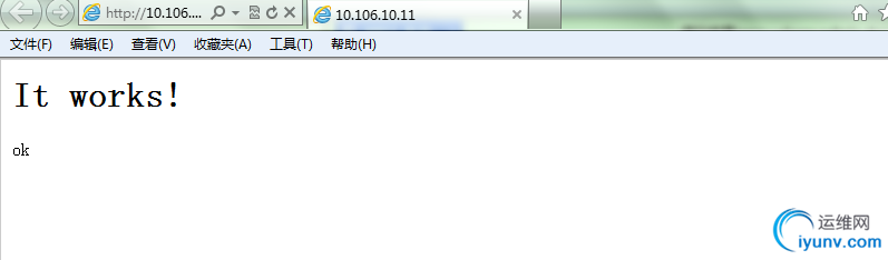

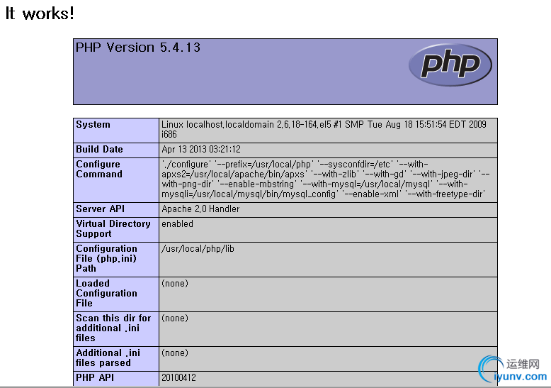

测试

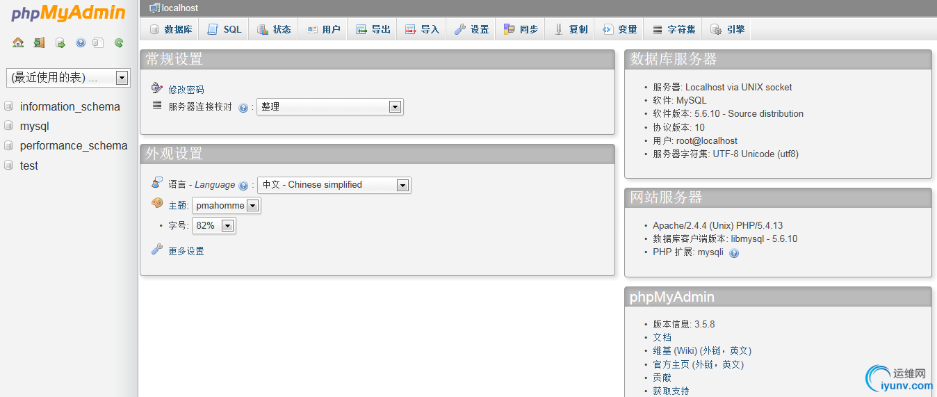

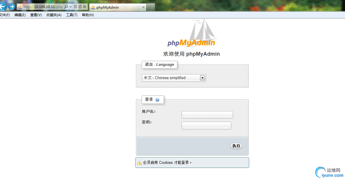

配置phpmyadmin
unzip phpMyAdmin-3.5.8-all-languages.zip
mv  phpMyAdmin-3.5.8-all-languages /usr/local/apache/htdocs/phpmyadmin
然后在/etc/httpd/httpd.conf中添加

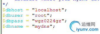

修改admin.php中的数据库
cd /usr/local/apache/htdocs/
[root@localhost htdocs]# vim admin.php

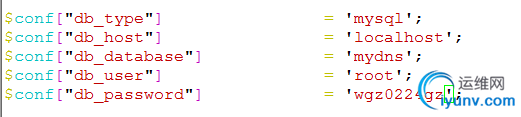

编辑mydnsconfig的配置文件
vim /usr/share/mydnsconfig/lib/config.inc.php
