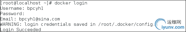

可以通过命令行执行 docker login 命令来输入用户名、密码和邮箱来完成注册和登录。注册
  成功后,本地用户目录的 .docker/config.json 中将保存用户的认证信息。

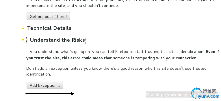

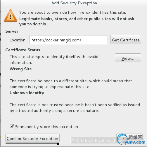

用浏览器输入: https://docker.nmgkj.com
  或者:curl -i -k curl -i -k https://docker.nmgkj.com
[root@localhost ~]# curl -i -k https://docker.nmgkj.com  HTTP/1.1 200 OK
  Server: nginx/1.11.2
  Date: Sun, 13 Aug 2017 03:24:08 GMT
  Content-Type: application/json
  Content-Length: 28
  Connection: keep-alive
  Expires: -1

   登录: docker login -u duyuheng -p pwd123 -e "duyuheng@nmgkj.com" https://docker.nmgkj.com
[root@localhost ~]# docker login  https://docker.nmgkj.com
Username: duyuheng
Password:Login Succeeded
