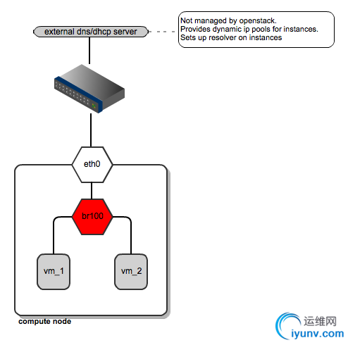

FlatManager
  FlatManager provides the most primitive set of operations. Its role boils down just to attaching the instance to the bridge on the compute node. By default, it does no IP configuration of the instance. This task is left for the systems administrator and can be done using some external DHCP server or other means.

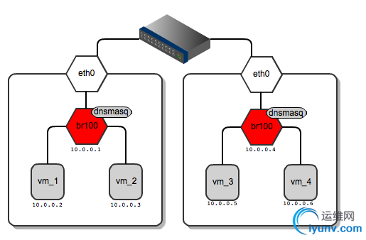

  FlatDHCPManager plugs  a given instance into the bridge, and on top of that provides a DHCP server to boot up from.
  On each compute node:
  •   the network bridge is given an address from the “flat” IP pool
  •   a dnsmasq DHCP server process is spawned and listens on the bridge interface IP
  •   the bridge acts as the default gateway for all the instances running on the given compute node
DSC0002.png FlatDHCPManager – network topology

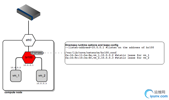

  As for dnsmasq, FlatDHCPManager creates a static lease file per compute node to guarantee the same IP address for the instance over time. The lease file is constructed based on instance data from the Nova database, namely MAC, IP and hostname. The dnsmasq server is supposed to hand out addresses only to instances running locally on the compute node.  To achieve this, instance data to be put into DHCP lease file  are filtered by the ‘host’ field from the ‘instances’ table.  Also, the default gateway option in dnsmasq is set to the bridge’s IP address. On the diagram below you san see that it will be given a different default gateway depending on which compute node the instance lands.
DSC0003.png Network gateways for instances running on different compute nodes
  Below I’ve shown the routing table from vm_1 and for vm_3 – each of them has a different default gateway:
  root@vm_1:~# route -n
Kernel IP routing table
Destination    Gateway     Genmask Flags Metric Ref Use Iface
0.0.0.0        10.0.0.1     0.0.0.0 UG     0   0   0 eth0
  root@vm_3:~# route -n
0.0.0.0        10.0.0.4     0.0.0.0 UG     0   0   0 eth0
