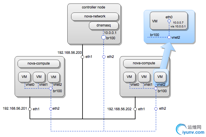

  With single-host FlatDHCP, there’s just one instance of nova-network; dnsmasq, typically running on the controller node, is shared by all the VMs.
  Contrast that to multi-host FlatDHCP networking,
where each compute node also hosts its own instance of the nova-network
service, which provides the DHCP server (dnsmasq) and default gateway
for the VMs on that node.
  In this setup, the br100 interface and an associated physical
interface eth2 on the compute nodes don’t have an assigned IP address atall; they merely serve as an L2 interconnect that allows the VMs to
reach nova-network and each other. Nova-network essentially functions asan L2 switch.
  VM virtual interfaces are attached to br100 as well. The VMs
have their default gateway set (in the guest OS configuration) to
10.0.0.1, which means that all external traffic from VMs is routed
through the controller node.
Traffic within 10.0.0.0/24 is not routed through the controller, however.
Network Configuration
  Let us consider an actual example:
  •   1 controller node
  •   2 compute nodes,
  •   eth1 hosting the management network (the one through which compute nodes can communicate with the controller and nova services)
  •   eth2 hosting the VM network (the one to which VMs will be attached).
  We’ll start with a look at all aspects of the network configuration
on the controller and one of the compute nodes: before and after
starting a VM.

How packets flow at L2 level
  We need to first consider how packets are routed in our network at the lowest level – namely ethernet packets, addressing devices by their MAC address – because we’ll need this to understand how they flow at a higher level.
  Thankfully, this is simple.
  All machines (all compute nodes and the controller) are connected viathe physical network fabric attached to their eth2 interface (rememberthat we have two physical networks in this setup: eth1 for the
management network and eth2 for the VM network, and for security we keepthem physically separate)
. They all have the br100 bridge connected to eth2. A bridge is essentially a virtual L2 switch.
  Compute nodes also have the VM virtual interfaces vnetX bridged to br100.
  So, ethernet broadcast packets reach all the machines’ eth2 and
br100, as well as all the VM’s vnetX (and consequently all the guest OS
interfaces).
  Ethernet unicast packets flow in a similar fashion through physical
switches forming this network and through the virtual switches
implemented by br100 (read How LAN switches work and Linux bridge docs; further details aren’t important in this context).

  So, when the VM is booting, it sends a DHCPDISCOVER UDP broadcast
packet via the guest OS’s eth0, which is connected by libvirt to the
host machine’s vnet0. This packet reaches the controller node and
consequently our DHCP server dnsmasq which listens on br100, etc.

    (compute-1) receives the ARP packet on eth2, and, as it is bridged to
    br100 together with vnet0, the packet reaches the VM. Note that this
    does not involve iptables on the compute node, as ARP packets are L2 and iptables operate above that, on L3.
  •   The VM’s OS kernel sees the ARP packet “who has 10.0.0.2?” and replies to 10.0.0.1 with an ARP reply packet, “That’s me!”Italready knows the MAC address of 10.0.0.1 because it’s specified in theARP packet. This ARP reply packet is sent through the guest side of
    vnet0, gets bridged to the host side, then to br100 and, via eth2, landson controller. We can see that in the tcpdump:
    01:38:47.872036 ARP, Reply 10.0.0.2 is-at fa:16:3e:2c:e8:ec (oui Unknown), length 46

  •   Now we know the VM’s mac address. Now we send an ICMP echo-request packet:
    01:38:47.872044 IP 10.0.0.1 > 10.0.0.2: ICMP echo request, id 4654, seq 1, length 64  This successfully reaches the VM as a result of the following sequence of iptables rules firing on the compute node:
    -A FORWARD -j nova-filter-top
    -A nova-filter-top -j nova-compute-local
    -A nova-compute-local -d 10.0.0.2/32 -j nova-compute-inst-9
    -A nova-compute-inst-9 -s 10.0.0.0/24 -j ACCEPT
  •   This packet reaches the VM as already described, and the VM’s OS replies with an ICMP echo-reply packet:
    01:38:47.872552 IP 10.0.0.2 > 10.0.0.1: ICMP echo reply, id 4654, seq 1, length 64  As the VM’s routing table includes 10.0.0.0/24 via 0.0.0.0 dev eth0,
    the packet does not get routed through the controller and is instead
    sent “as is” to VM’s eth0 and routed the usual way.
      This concludes the roundtrip and we get a nice message:
    openstack@controller-1:~$ ping 10.0.0.2
    PING 10.0.0.2 (10.0.0.2) 56(84) bytes of data.
    64 bytes from 10.0.0.2: icmp_req=1 ttl=64 time=1.33 ms
