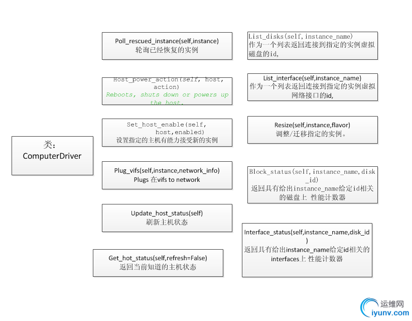

  •     #此处为了让大家看的明白 将 ComputerDriver的类图 列出来

  •     def resume(self, instance, callback):
  •         """resume the specified instance"""
  •         # TODO(Vek): Need to pass context in for access to auth_token
  •         raise NotImplementedError()
  •     def rescue(self, context, instance, callback, network_info):
  •         #恢复指定的实例
  •         """Rescue the specified instance"""
  •     def unrescue(self, instance, callback, network_info):
  •         """Unrescue the specified instance"""
  •     def update_available_resource(self, ctxt, host):
  •         #在computeNode表中更新电脑资源管理的信息
  •         """Updates compute manager resource info on ComputeNode table.
  •         This method is called when nova-compute launches, and
  •         whenever admin executes "nova-manage service update_resource".
  •         :param ctxt: security context
  •         :param host: hostname that compute manager is currently running
  •     def live_migration(self, ctxt, instance_ref, dest,
  •                        post_method, recover_method):
  •         #分发处理高负荷,当有高负荷操作时候,大量生成 live_mirgration
  •         """Spawning live_migration operation for distributing high-load.
  •         :param instance_ref:
  •             nova.db.sqlalchemy.models.Instance object
  •             instance object that is migrated.
  •         :param dest: destination host
  •         :param post_method:
  •             post operation method.
  •             expected nova.compute.manager.post_live_migration.
  •         :param recover_method:
  •             recovery method when any exception occurs.
  •             expected nova.compute.manager.recover_live_migration.
  •     def refresh_security_group_rules(self, security_group_id):
  •         #改变安全组之后调用
  •         """This method is called after a change to security groups.
  •         All security groups and their associated rules live in the datastore,
  •         and calling this method should apply the updated rules to instances
  •         running the specified security group.
  •         An error should be raised if the operation cannot complete.
  •     def refresh_security_group_members(self, security_group_id):
  •         #当一个安全组被添加到一个实例,这个方法被调用
  •         """This method is called when a security group is added to an instance.
  •         This message is sent to the virtualization drivers on hosts that are
  •         running an instance that belongs to a security group that has a rule
  •         that references the security group identified by `security_group_id`.
  •         It is the responsiblity of this method to make sure any rules
  •         that authorize traffic flow with members of the security group are
  •         updated and any new members can communicate, and any removed members
  •         cannot.
  •         Scenario:
  •             * we are running on host 'H0' and we have an instance 'i-0'.
  •             * instance 'i-0' is a member of security group 'speaks-b'
  •             * group 'speaks-b' has an ingress rule that authorizes group 'b'
  •             * another host 'H1' runs an instance 'i-1'
  •             * instance 'i-1' is a member of security group 'b'
  •             When 'i-1' launches or terminates we will recieve the message
  •             to update members of group 'b', at which time we will make
  •             any changes needed to the rules for instance 'i-0' to allow
  •             or deny traffic coming from 'i-1', depending on if it is being
  •             added or removed from the group.
  •         In this scenario, 'i-1' could just as easily have been running on our
  •         host 'H0' and this method would still have been called.  The point was
  •         that this method isn't called on the host where instances of that
  •         group are running (as is the case with
  •         :method:`refresh_security_group_rules`) but is called where references
  •         are made to authorizing those instances.
  •     def refresh_provider_fw_rules(self, security_group_id):
  •         #这触发一个基于数据库改变的防火墙的更新
  •         """This triggers a firewall update based on database changes.
  •         When this is called, rules have either been added or removed from the
  •         datastore.  You can retrieve rules with
  •         :method:`nova.db.api.provider_fw_rule_get_all`.
  •         Provider rules take precedence over security group rules.  If an IP
  •         would be allowed by a security group ingress rule, but blocked by
  •         a provider rule, then packets from the IP are dropped.  This includes
  •         intra-project traffic in the case of the allow_project_net_traffic
  •         flag for the libvirt-derived classes.
  •     def reset_network(self, instance):
  •         """reset networking for specified instance"""
  •         pass
  •     def ensure_filtering_rules_for_instance(self, instance_ref, network_info):
  •         #设置过滤规则,并等待它完成
  •         """Setting up filtering rules and waiting for its completion.
  •         To migrate an instance, filtering rules to hypervisors
  •         and firewalls are inevitable on destination host.
  •         ( Waiting only for filtering rules to hypervisor,
  •         since filtering rules to firewall rules can be set faster).
  •         Concretely, the below method must be called.
  •         - setup_basic_filtering (for nova-basic, etc.)
  •         - prepare_instance_filter(for nova-instance-instance-xxx, etc.)
  •         to_xml may have to be called since it defines PROJNET, PROJMASK.
  •         but libvirt migrates those value through migrateToURI(),
  •         so , no need to be called.
  •         Don't use thread for this method since migration should
  •         not be started when setting-up filtering rules operations
  •         are not completed.
  •         :params instance_ref: nova.db.sqlalchemy.models.Instance object
  •     def unfilter_instance(self, instance, network_info):
  •         """Stop filtering instance"""
  •     def set_admin_password(self, context, instance_id, new_pass=None):
  •         Set the root password on the specified instance.
  •         The first parameter is an instance of nova.compute.service.Instance,
  •         and so the instance is being specified as instance.name. The second
  •         parameter is the value of the new password.
  •     def inject_file(self, instance, b64_path, b64_contents):
  •         """在指定的实例上写文件
  •         Writes a file on the specified instance.
  •         parameter is the base64-encoded path to which the file is to be
  •         written on the instance; the third is the contents of the file, also
  •         base64-encoded.
  •     def agent_update(self, instance, url, md5hash):
  •         #在指定的实例中更新代理
  •         Update agent on the specified instance.
  •         parameter is the URL of the agent to be fetched and updated on the
  •         instance; the third is the md5 hash of the file for verification
  •         purposes.
  •     def inject_network_info(self, instance, nw_info):
  •         #为指定的实例注入网络信息
  •         """inject network info for specified instance"""
  •         pass
  •     def poll_rescued_instances(self, timeout):
  •         #轮询已经恢复的实例
  •         """Poll for rescued instances"""
  •     def host_power_action(self, host, action):
  •         """Reboots, shuts down or powers up the host."""
  •     def set_host_enabled(self, host, enabled):
  •         #设置指定的主机有能力接受新的实例
  •         """Sets the specified host's ability to accept new instances."""
  •     def plug_vifs(self, instance, network_info):
  •         """Plugs in VIFs to networks."""
  •     def update_host_status(self):
  •         """Refresh host stats"""
  •     def get_host_stats(self, refresh=False):
  •         """Return currently known host stats"""
  •     def list_disks(self, instance_name):
  •         Return the IDs of all the virtual disks attached to the specified
  •         instance, as a list.  These IDs are opaque to the caller (they are
  •         only useful for giving back to this layer as a parameter to
  •         disk_stats).  These IDs only need to be unique for a given instance.
  •         Note that this function takes an instance ID.
  •     def list_interfaces(self, instance_name):
  •         Return the IDs of all the virtual network interfaces attached to the
  •         specified instance, as a list.  These IDs are opaque to the caller
  •         (they are only useful for giving back to this layer as a parameter to
  •         interface_stats).  These IDs only need to be unique for a given
  •         instance.
  •     def resize(self, instance, flavor):
  •         Resizes/Migrates the specified instance.
  •         The flavor parameter determines whether or not the instance RAM and
  •         disk space are modified, and if so, to what size.
  •     def block_stats(self, instance_name, disk_id):
  •         Return performance counters associated with the given disk_id on the
  •         given instance_name.  These are returned as [rd_req, rd_bytes, wr_req,
  •         wr_bytes, errs], where rd indicates read, wr indicates write, req is
  •         the total number of I/O requests made, bytes is the total number of
  •         bytes transferred, and errs is the number of requests held up due to a
  •         full pipeline.
  •         All counters are long integers.
  •         This method is optional.  On some platforms (e.g. XenAPI) performance
  •         statistics can be retrieved directly in aggregate form, without Nova
  •         having to do the aggregation.  On those platforms, this method is
  •         unused.
  •     def interface_stats(self, instance_name, iface_id):
  •         Return performance counters associated with the given iface_id on the
  •         given instance_id.  These are returned as [rx_bytes, rx_packets,
  •         rx_errs, rx_drop, tx_bytes, tx_packets, tx_errs, tx_drop], where rx
  •         indicates receive, tx indicates transmit, bytes and packets indicate
  •         the total num
  • ber of bytes or packets transferred, and errs and dropped
  •         is the total number of packets failed / dropped.
  •         unused.
