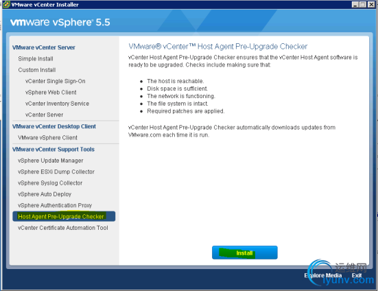

  Run Host Agent Pre-Upgrade Checker
  Download the latest version from VMware (click here)
  Run the installed by attaching the ISO onto vCenter 5.1 (virtualised).
Next
Depending on your setup choose the correct credential option

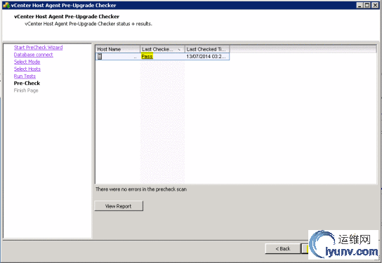

I only wanted to scan and check my host in my lab environment. If you want to scan all hosts choose standard mode.
Select default option until you get pass on your hosts and the press finish.

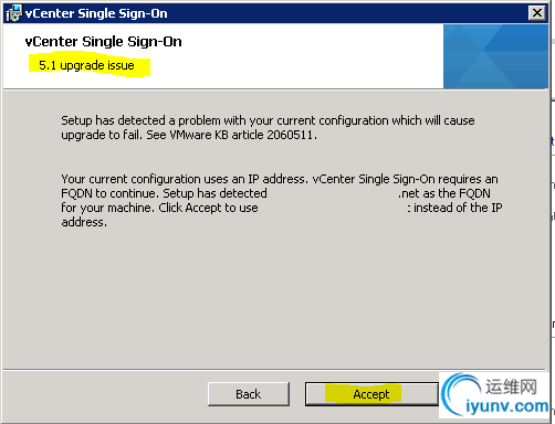

Important! SSO now relies heavily on DNS. As my previous installation was via IP it will prompt the warning message but also identify the FQDN for the virtual machine. To use this press “accept”
Enter SSO credentials
Select “install”

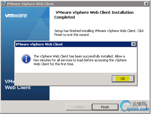

  VMware vSphere Web Client Upgrade
Lookup Service URL: https://vcenter_server(FQDN):7444/lookupservice/sdk

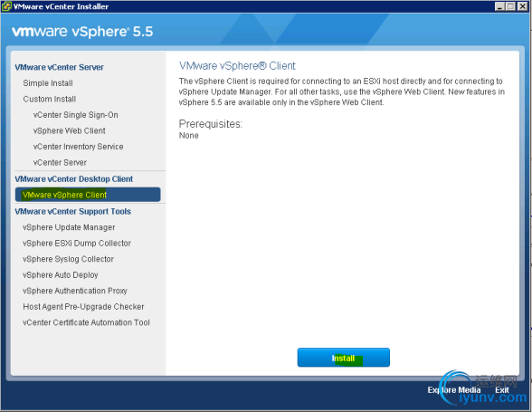

  VMware vSphere Client Upgrade

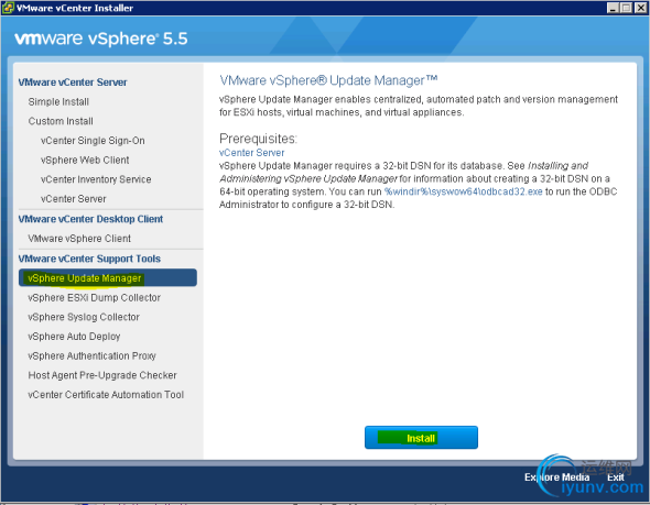

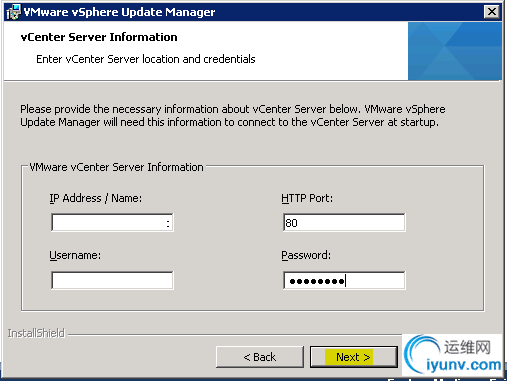

  VMware vSphere Update Manager Upgrade
Earlier version detected. Select “OK” to upgrade (backup)
