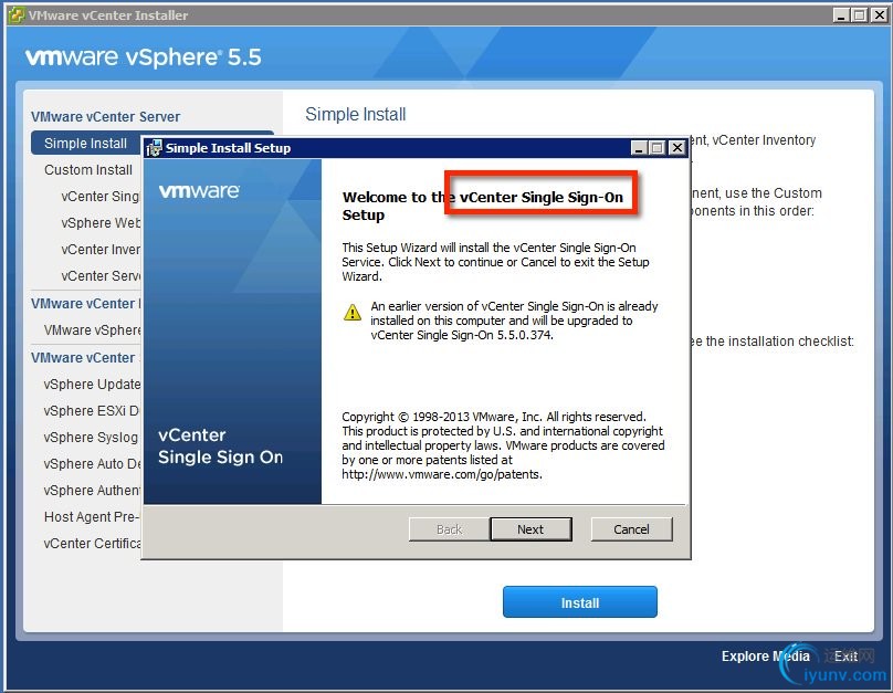

  To get things rolling I have mounted the vCenter 5.5 ISO and started the installer app. The following image shows the welcome screen for the vCenter install. As mentioned earlier, we are going to choose the Simple Install, which will install the components listed on the right on our single server. Since we already have vSphere 5.1 installed those components will be upgraded to 5.5
  The different vCenter components will be installed or upgrade in the order listed in the previous image. This means that SSO will be the first part to be upgraded. The image below shows the installer starting and it has recognized that we have a previous version installed and will upgrade it.
  As the installer gets started with the SSO upgrade it will check the server name and make sure that it resolves properly in DNS.
  With the SSO install already detecting a previous version and preparing for the upgrade, it is now warning you that it will move forward all of the users and groups. This is important: Since SSO was a complete rewrite of code from 5.1, it needs to keep your data so that you don’t have to start all over.

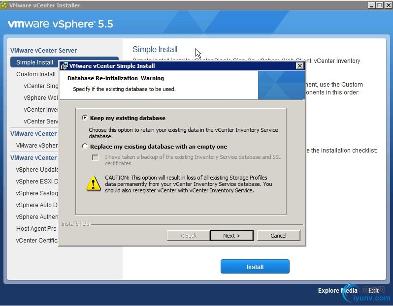

  The next phase of the upgrade is starting the process of upgrading the vCenter Inventory Service. It is asking whether it should upgrade the existing database or whether a new one was created for it. Since we want to upgrade in place and maintain all of our data, choose the option to keep the existing database.

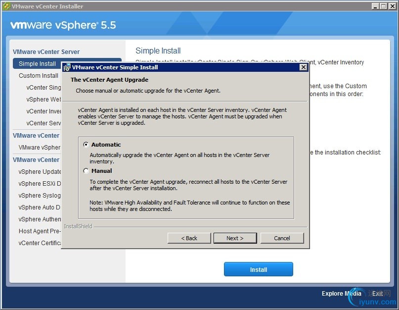

  Next, you’ll be asked whether the installer should auto-upgrade the vCenter agent on the ESXi hosts that are managed by this vCenter. If you do not do this now you will have to do them manually later. I’m all about saving time, so we are choosing the Automatic method.

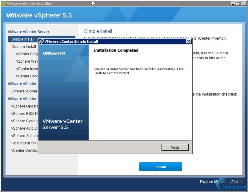

  This upgrade is now ready to rock, so lets click Install and get the vCenter Server upgraded to vCenter 5.5.
  So we have finished out the long and fairly easy process. The installer shows our completed confirmation, and the newly minted vCenter 5.5 server is ready for action.
