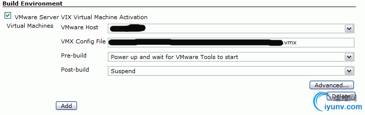

  •   Enable the "VMware Server VIX Virtual Machine Activation" option in the Build Environment for your Job.
  •   Configure the required options
Meaning of parameters:
  •   Path to VMware VIX Libraries - this is the path to the directory containing the vix shared libraries / DLL
  •   Host - This is the IP address or DNS name of the machine running VMware Server
  •   Username - This is the username used to login to the machine running VMware Server
  •   Password - This is the password used to login to the machine running VMware Server
  •   Port - This is normally 902.  It is the port on the machine running VMware Server that VMware VIX should attempt to connect on
  •   VMX Config File - This is the virtual machine to control.  Note: it must be registered in VMware Server in order to control it.
  •   Pre-build - What to do with this virtual machine before starting the build.
  •   Post-build - What to do with this virtual machine after the build completes.

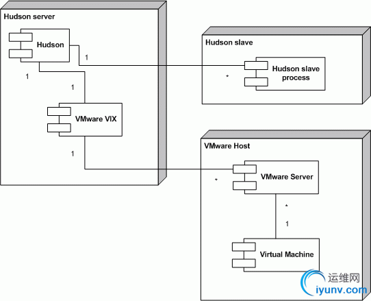

Deployment
Here is an example deployment diagram:
