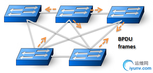

  参考:https://blogs.vmware.com/vsphere/2012/11/vsphere-5-1-vds-new-features-bpdu-filter.html
  http://rickardnobel.se/esxi-5-1-bdpu-guard/
  BPDU包

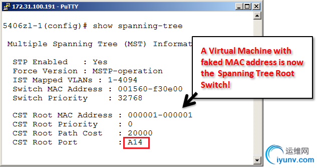

  BPDU包就是STP协议的一些交换包。没有验证机制信任所有的BPDU包,所以可能有假冒的BPDU包。
  虚拟交换机不支持STP,自身也不会发送任何BPDU包,也不会处理任何来自物理交换机的BPDU包。
  虚拟机上如果生成和传播BPDU包会将整个cluster瘫痪掉。例如发送一个假冒的包以便赢得ROOT bridge角色。

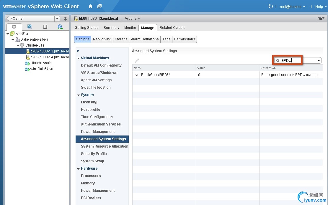

  为防止特定端口接收BPDU包,发明了BPDU Guard in Cisco and BPDU Protection on HP network device.
  一旦发现某端口有BPDU包就关闭该端口。
  由此引出BPDU filter,适用于VDS和VSS两种交换机。需要每个主机一个一个的去修改
  设置:

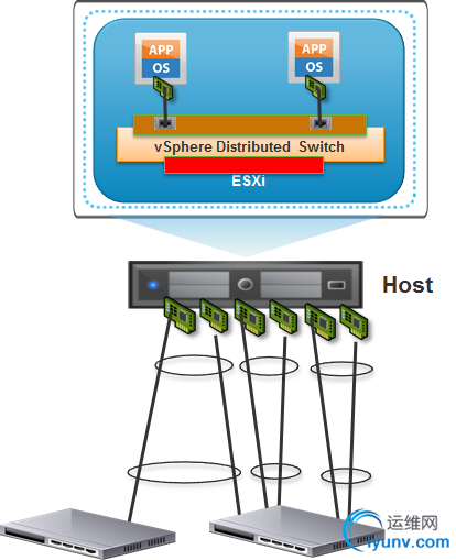

9.LACP是否可以绑定2个不同的交换机端口。
  LACP itself doesn't provide the ability to bond across multiple switches; it bonds across multiple ports on a single ethernet switch, and depending on the vendor there might even be restrictions on which ports on a switch can be bonded together.
  Some vendors have proprietary protocols (typically called MLAG) that allow for bonded ethernet channels across different ethernet switches; this may not be helpful when working with a server's ethernet ports.

11.总体图

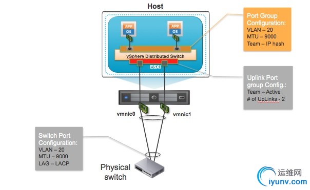

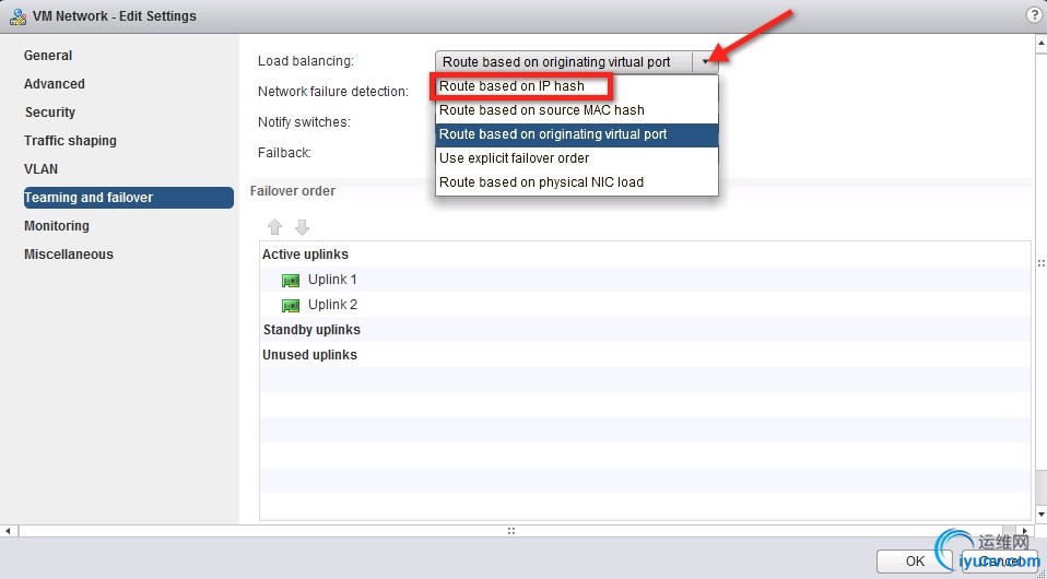

12.LACP+nic teaming实例
  虚拟交换机上的配置:

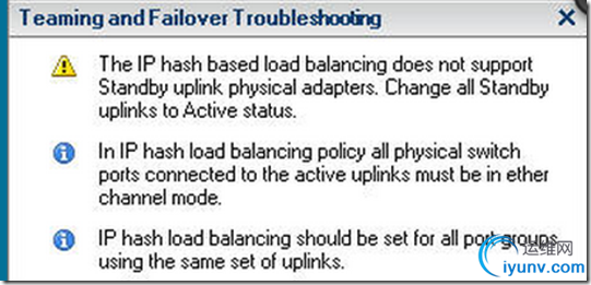

  uplink port group上设置LACP Active or Passive mode
  port group上设置IP hash
  物理交换机上要正确配置LACP和Vlan(组内的vlan要相同)
  参考:http://stretch-cloud.info/2013/09/lacp-primer-vsphere-5-5/

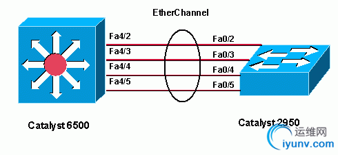

  1、以太网通道最多可以捆绑8条物理链路
  2、捆绑遵循以下规则:
  (1)相同VLAN
  (2)端口中继模式
  (3)相同speed和duplex

  • Dynamic – Detects link failures and cabling mistakes and automatically reconfigures the links
LACP limitations on a vSphere Distributed Switch
  • vSphere supports only one LACP group (Uplink Port Group with LACP enabled) per distributed switch and only one LACP group per host (5.1版本)
  • LACP does not support Port mirroring
  • LACP settings do not exist in host profiles
  • LACP only works with IP Hash load balancing and Link Status Network failover detection
  • LACP between two nested ESXi hosts is not possible

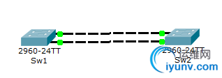

18.cisco 链路聚合范例
  Etherchannel 分为二层和三层etherchannel
以太网链路捆绑用来增加带宽和负载均衡。拓扑如下:
SW1的配置:
interface FastEthernet0/1
channel-group 1 mode desirable
switchport mode trunk
interface FastEthernet0/2
interface Port-channel 1
SW2的配置:
show etherchannel summary 查看以太网通道的状态

另外要注意以太网通道的模式
etherchannel 的模式:
1、PAGP的模式:
on:不进行协商,没有协商traffic。类似nonegotiate
auto:passive negotiat state。可接受对端发出的协商,但不会主动申请。(默认)
desirable:active negotiat state。主动协商状态。主动发送PAGP包。
2、LACP的模式:
passive:passive negotiating state。被动状态,可接受。但不会主动申请(默认)
active:active negotiating state。主动状态,主动申请。
注意:
  on        on          OK
  desirable desirable   OK
  desirable auto        OK
  auto      auto       形成不了
  auto      on         形成不了
  active    active      OK
  passive   active      OK
  passive   passive     形成不了
S1(config)# interface range f0/13 -15
S1(config-if-range)# channel-group 1 mode ?
active     Enable LACP unconditionally
auto       Enable PAgP only if a PAgP device is detected
desirable  Enable PAgP unconditionally
on         Enable Etherchannel only
passive    Enable LACP only if a LACP device is detected
S1(config-if-range)# channel-group 1 mode active

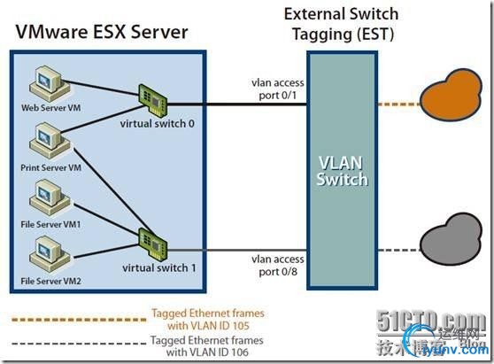

1) EST - External Switch Tagging
通过将交换机的端口划分到不同的vlan实现虚拟机的vlan分配.
优点: 与管理物理环境相似,无需在ESXi服务器上配置vlan
缺点: 绑定在同一物理端口的虚拟机只能属于同一vlan
物理交换机配置: switchport mode access
switchport access vlan xx
虚拟交换机(vSwitch)配置: 无
虚拟机(vm)配置: 无
所以的VLAN标志数据包在物理交换机上执行处理。
ESX主机的网络适配器连接到物理交换机的端口。
连接到虚拟交换机的端口组必须有自己的设置为0的VLAN ID。
用户可以使用外部交换机标记VLAN。这类似于物理网络,VLAN的配置对于单独的物理服务器一般是透明的。当一个数据包到达交换机端口标记被加上,当数据包离开交换机端口去往服务器时标签被剥离。
