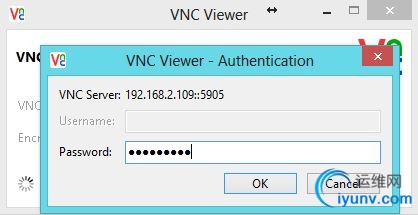

  ipaddress:5905 or ipaddress:5
CentOS 7 – VNC Connection  You will be asked to enter the password, enter the password that you have created earlier.
DSC0001.jpg CentOS 7 – VNC Authendication
