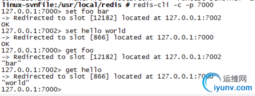

  linux-svnfile:/usr/local/cluster #redis-cli -p 7000
  127.0.0.1:7000>

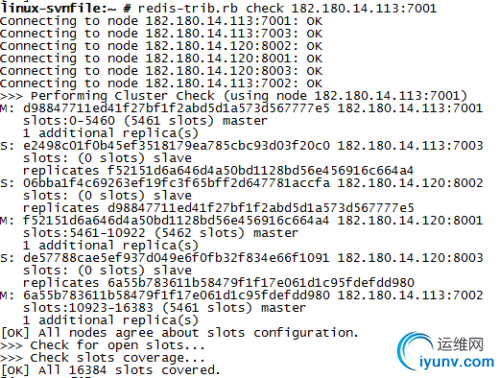

  上面是在单台机器上做的集群,下面展示两台机器上做集群,其实也很简单。
  参考之前的环境编译源码到另一台机器
  在两台机器上编辑配置文件
  /usr/local/redis # vi redis.conf
  daemonize yes
  port 7000
  cluster-enabled yes
  cluster-config-file nodes.conf
  cluster-node-timeout 5000
  appendonly yes
  cluster-config-file nodes-7001.conf

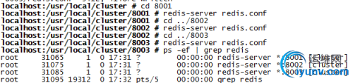

  分别创建目录和文件
  linux-svnfile:/usr/local/redis # mkdir -p/usr/local/cluster/{7001..7003}
  localhost:/usr/local/redis # mkdir -p/usr/local/cluster/{8001..8003}
  linux-svnfile:/usr/local/redis # cpredis.conf ../cluster/7001
  linux-svnfile:/usr/local/redis # cpredis.conf ../cluster/7002
  linux-svnfile:/usr/local/redis # cpredis.conf ../cluster/7003
  localhost:/usr/local/redis # cp redis.conf../cluster/8001
  localhost:/usr/local/redis # cp redis.conf../cluster/8002
  localhost:/usr/local/redis # cp redis.conf../cluster/8003
  修改对应目录的配置文件其中port 和cluster-config-file分别对应各自的目录名,可使用sed命令做修改
  sed -i "s/7001/7002/g"
  启动服务
