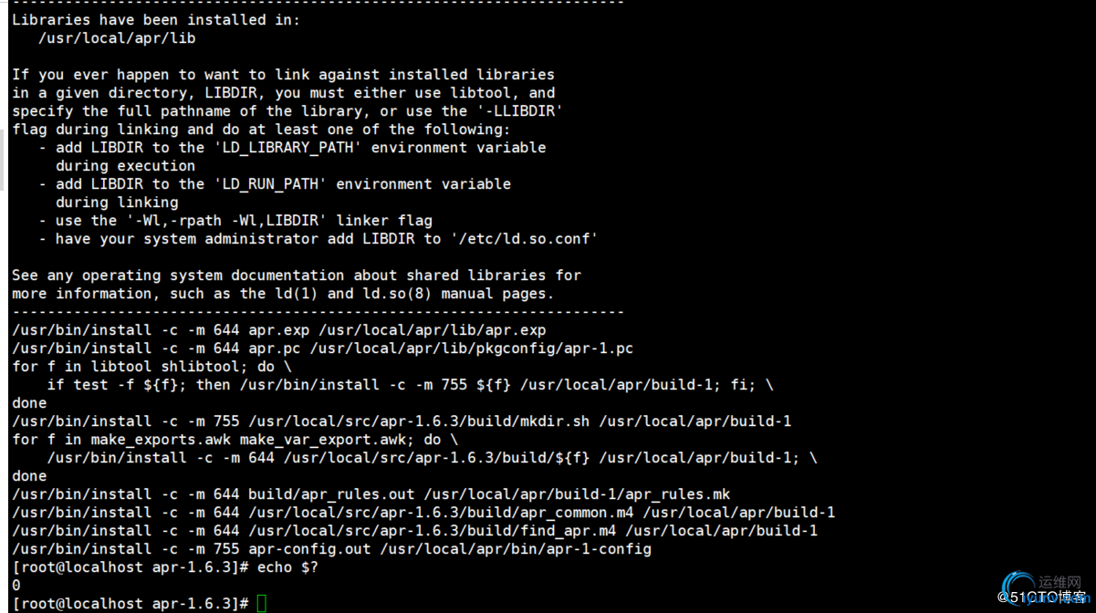

  3.编译安装 apr-1.6.3
cd apr-1.6.3
./configure --prefix=/usr/local/apr
  报错01:
[root@server-1 apr-1.6.3]# ./configure --prefix=/usr/local/apr
checking build system type... x86_64-pc-linux-gnu
checking host system type... x86_64-pc-linux-gnu
checking target system type... x86_64-pc-linux-gnu
Configuring APR library
Platform: x86_64-pc-linux-gnu
checking for working mkdir -p... yes
APR Version: 1.6.3
checking for chosen layout... apr
checking for gcc... no
checking for cc... no
checking for cl.exe... no
configure: error: in `/usr/local/apr-1.6.3':
configure: error: no acceptable C compiler found in $PATH
See `config.log' for more details
[root@server-1 apr-1.6.3]# echo $?
  解决办法:安装gcc
yum install gcc -y
  再次config编译成功
[root@localhost apr-1.6.3]# ./configure --prefix=/usr/local/apr
[root@server-1 apr-1.6.3]#make && make install
0

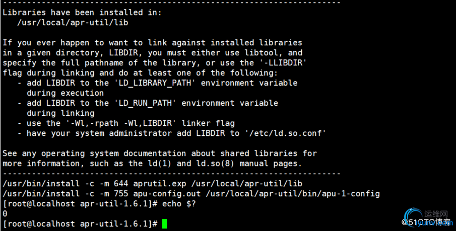

  4.编译安装apr-util-1.6.1
cd /usr/local/src/apr-util-1.6.1
./configure --prefix=/usr/local/apr-util --with-apr=/usr/local/apr

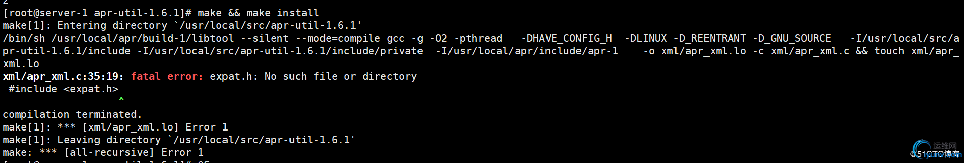

  编译安装报错
  解决报错:安装expat库
yum install expat-devel -y
  再次执行make && make install,报错解决

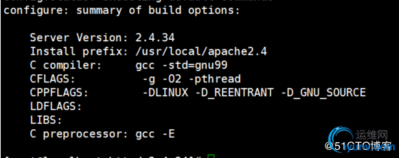

./configure \
--prefix=/usr/local/apache2.4 \
--with-apr=/usr/local/apr\
--with-apr-util=/usr/local/apr-util \
--enable-so \   ##支持动态扩展模块,apache支持以一个动态模块存在,Apache本身就是一个进程服务
--enable-mods-shared=most

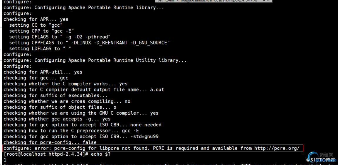

  编译报错01:configure: error: pcre-config for libpcre not found. PCRE is required and available from http://pcre.org/
解决办法:
yum install pcre-devel -y
  再次执行./configure --prefix=/usr/local/apache2.4 --with-apr=/usr/local/apr --with-apr-util=/usr/local/apr-util --enable-so --enable-mods-shared=most返回如下界面,表示configure编译成功

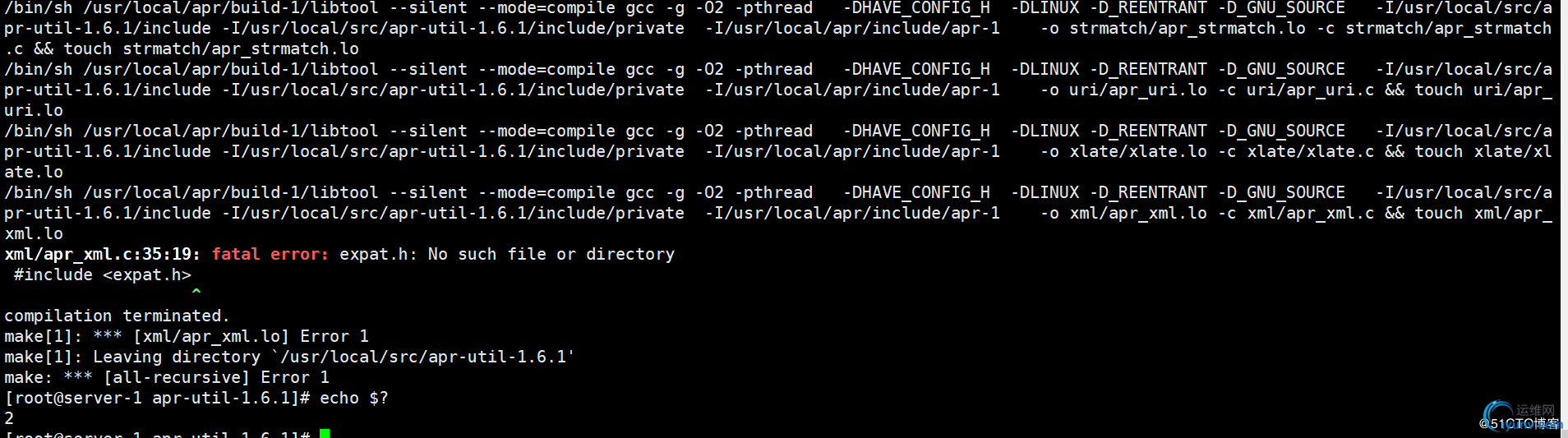

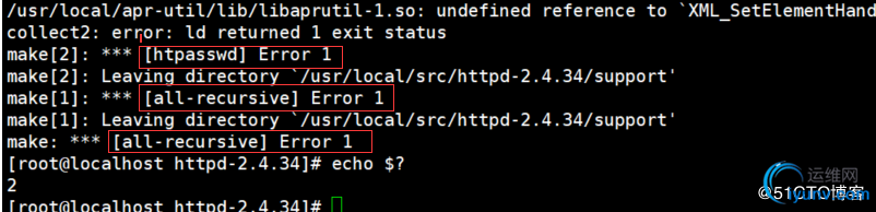

  make && make install 编译安装报错
  说明:缺少了xml相关的库,需要安装libxml2-devel包。直接安装并不能解决问题,因为httpd调用的apr-util已经安装好了,但是apr-util并没有libxml2-devel包支持
  解决办法:
参考https://blog.csdn.net/MrDing991124/article/details/78829184
  重新安装libxml2-devel
yum install -y libxml2-devel
  删除apr-util软件包
rm -rf /usr/local/src/apr-util-1.6.1
cd /usr/local/src/

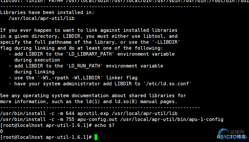

  重新编译安装apr-util
tar zxvf apr-util-1.6.1.tar.gz
cd apr-util-1.6.1/

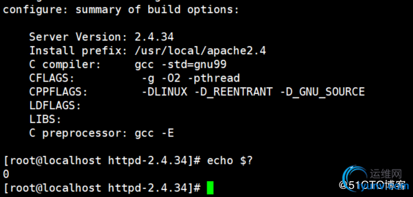

[root@localhost httpd-2.4.34]# ./configure --prefix=/usr/local/apache2.4 --with-apr=/usr/local/apr --with-apr-util=/usr/local/apr-util --enable-so --enable-mods-shared=most
返回下面界面说明configure这步编译成功
返回下面界面说明make && make install 执行成功

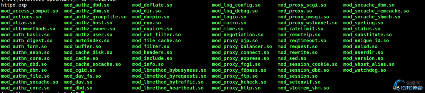

modules目录:存放apache需要的模块
[root@server-1 apache2.4]# ls ./modules/
[root@server-1 apache2.4]# ls ./htdocs/
index.html
[root@server-1 apache2.4]# ls ./bin/
[root@server-1 apache2.4]# ls ./logs/
[root@server-1 apache2.4]# ls ./conf/
extra  httpd.conf  magic  mime.types  original

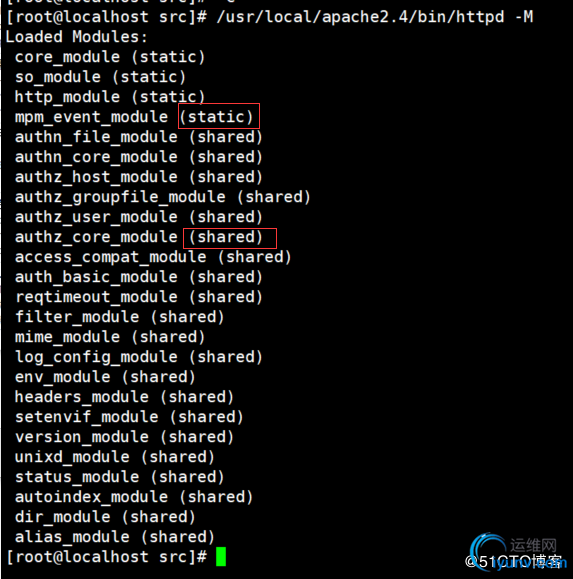

  查看apache加载的模块
/usr/local/apache2.4/bin/httpd -M
说明: apache会加载两种类型的模块
static:静态模块
shared:动态模块
两者的区别在于,static模块是已经编译安装到/usr/local/apache2.4/bin/httpd配置文件中,而shared表示apache动态加载的模块
