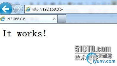

  4、启动&测试
  # /usr/local/apache/bin/apachectl start
  如果成功,可以停止 Apache 服务器并继续安装 PHP:
/usr/local/apache2/bin/apachectl stop
OR
/usr/local/apache/bin/apachectl -k stop(推荐)
