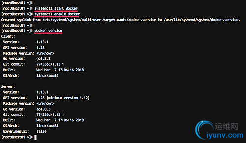

  yum -y install docker
  After the installation is complete, start the service and add it to the boot time.
  systemctl start docker
  systemctl enable docker
  Docker installed on the rancher host server - check it using commands below.
  systemctl status docker
  docker --version
  And you will get the result as shown below.

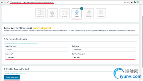

  Move your cursor to the 'ADMIN' menu drop-down and click the 'Access Control'.
  Now we want to use the 'Local Authentication' method. Click 'LOCAL' on the page, then type your username and password.

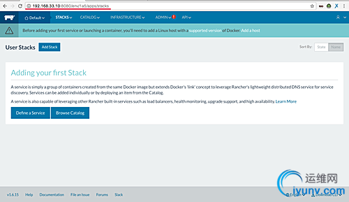

  Click 'Enable Local Auth' button and you will be redirected to the Rancher admin dashboard.
  Access Control for the Rancher server has been setup with Local Authentication enabled.

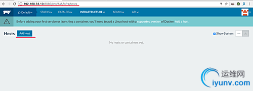

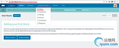

  Open the Rancher Dashboard, move your cursor to the 'INFRASTRUCTURE' menu and click 'Hosts'.
  Now click the 'Add Host' button.

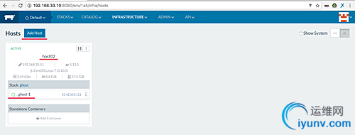

  Now back to the Rancher Dashboard Host Add page and click the 'Close' button.
  And you will see the 'host02' on the page as shown below.
  host02 has been added to the Rancher server, and we're now ready to run container managed by Rancher server.

  Now move your cursor to the 'INFRASTRUCTURE' menu and click 'Host'. Now make sure you get the 'ghost' container is running on the 'host2' server.
