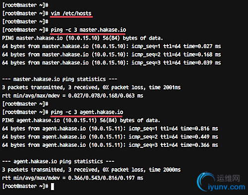

  Now edit the hosts using vim editor.
  vim /etc/hosts
  Add the following configuration to the end of the line.
10.0.15.10      master.hakase.io
10.0.15.11      agent.hakase.io
  Save and exit.
  Now test using the ping command.
  ping master.hakase.io
  ping agent.hakase.io
  And make sure you get the server IP address 10.0.15.10 and 10.0.15.11.

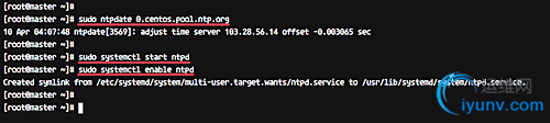

- Configure NTP Server
  It's very important to keep in synchronization the time between master and agent server.
  Install the NTP packages on both servers using the yum command.
  yum -y install ntp ntpdate
  After the installation is complete, choose the NTP pool as you want by running the command as below.
  sudo ntpdate 0.centos.pool.ntp.org
  Now start the NTP service and enable it to launch everytime at system boot.
  sudo systemctl start ntpd
  sudo systemctl enable ntpd
  NTP installation and configuration has been completed.

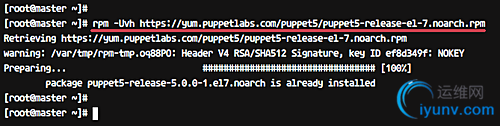

- Add Puppet Repository
  Now add the puppet repository to the system using the rpm command below.
  rpm -Uvh https://yum.puppetlabs.com/puppet5/puppet5-release-el-7.noarch.rpm
  When it is complete, reboot both servers.
  reboot

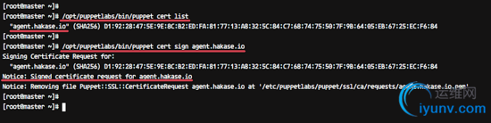

  Now back to the puppet master shell and run the command below.
  /opt/puppetlabs/bin/puppet cert list
  And you will get the pending Certificate Signing Request (CSR) from the puppet agent server 'agent.hakase.io'.
  Sign the certificate using the command below.
  /opt/puppetlabs/bin/puppet cert sign agent.hakase.io
  And the result should be similar to the following:
  The puppet agent is now running on the system, and the certificate for the agent has been signed by the puppet master.

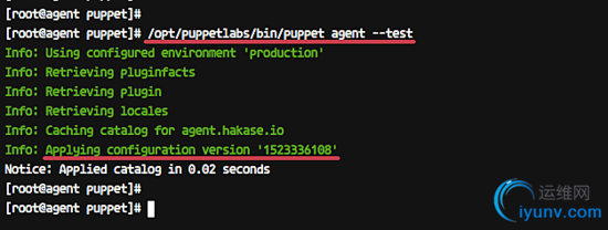

Step 4 - Verify the Puppet Agent Configuration
  After the puppet master signed the certificate file for the agent, run command below on the puppet agent to verify the configuration.
  /opt/puppetlabs/bin/puppet agent --test
  And you will get the result as shown below.
  The Puppet agent pulled the configuration from the puppet master and applied to the server without any error.

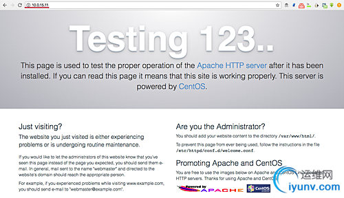

  Open your web browser and type the IP address of the puppet agent.
  http://10.0.15.11/
  And you will get the default HTTP page as below.
  The httpd web server has been installed using the puppet manifest.
