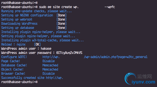

  Install WordPress with basic Nginx cache and W3 Total Cache using the ee command below.
  sudo ee site create wp.hakase-labs.io --wpfc
  And the following is the result.

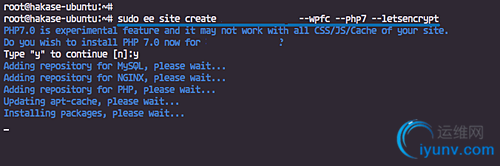

Install WordPress with PHP 7.0
  By default, the ee command will force to install PHP-FPM 5.6 for our WordPress installation. And if you want to install the site with the newest version PHP-FPM 7.0, use the '--php7' option.
  Run the ee command below.
  sudo ee site create wp.hakase-labs.io --wpfc --php7
  Now check the stack details info.
  sudo ee site info wp.hakase-labs.io

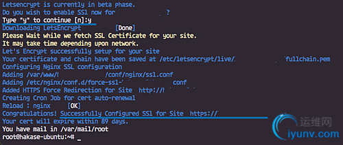

  sudo ee site create wp.hakase-labs.io --wpfc --php7 --letsencrypt
  And you will be asked about the SSL Letsencrypt configuration for the domain name.
  Type 'y' for yes and then press Enter.
  Following is the result.
  The WordPress installation with the PHP-FPM 7.0, SSL Letsencrypt, and Nginx Cache enabled has been completed successfully.

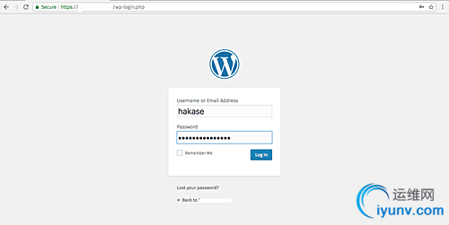

  Now open the WordPress login page, mine is: http://hakase-labs.io/wp-login.php
  Type the username and password given during the installation.
  And you will get the WordPress dashboard.
