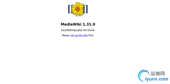

  Now, open your web browser and type the URL http://example.com. You will be redirected to the following page:
  Now, click on the set up the wiki button. You should see the following page:

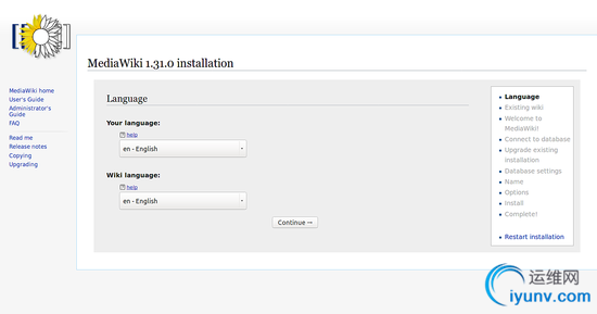

  Here, choose your wiki language and click on the Continue button. You should see the following page:

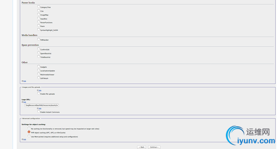

  Now, mark all your required settings and click on the Continue button. You should see the following page:
