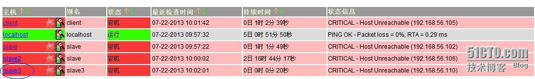

运行结果如下:(注意:下面蓝色部分为交互式输入部分)添加主机:[iyunv@localhost nagios]# ./autochost.sh
Please input the infomations of the server you want to set.
hostname:slave3
alias:slave3
IP:192.168.56.110
Running configuration check...done.
Reloading nagios configuration...done
[iyunv@localhost nagios]# cat etc/hosts/slave3.cfg
define host{
        use     linux-server,hosts-pnp
        host_name       slave3
        alias           slave3
        address         192.168.56.110
} 100332748.jpg 添加服务:[iyunv@localhost nagios]# ./autocservice.sh
