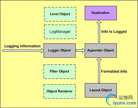

    Apache log4j的官方介绍是“log4j is a reliable, fast and flexible logging framework (APIs) written in Java, which is distributed under the Apache Software License. log4j is highly configurable through external configuration files at runtime. It views the logging process in terms of levels of priorities and offers mechanisms to direct logging information to a great variety of destinations, such as a database, file, console, UNIX Syslog, etc.”,翻译过来就是:log4j是基于Apache Software License发行的可靠、快速、可扩展的日志框架。log4j具有高可配置性,可以在运行的过程中通过外部文件配置它。log4j能够根据不同的级别优先权来过滤日志,并且提供了一种机制,能够将日志记录直接写到控制台,文件,数据库,UNIX系统日志等。
    上面的官方介绍,不光对log4j进行了定义,也对log4j的特点性能进行了阐述。log4j主要由logger(记录器),appender(输出源),layout(布局模式)三部分组成,其中logger用来捕获日志信息,layout用来对日志信息进行格式化,appender用来定义日志的输出源。具体的架构可以参加下图:
