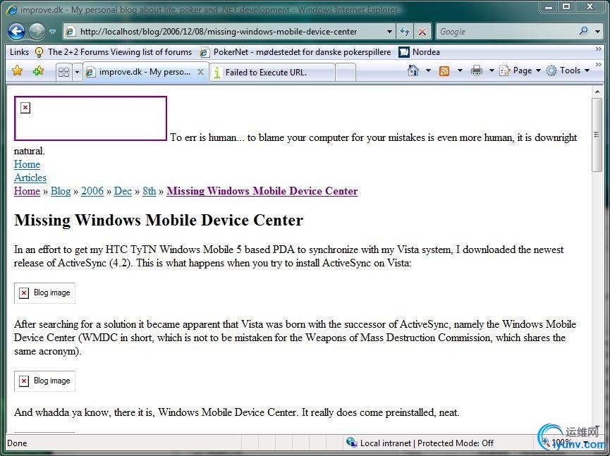

  I didn't really expect this to be a problem when I first requested http://localhost for the first time after setting up my site on IIS 7 (all default settings).
  Unfortunately this was what I was presented with. Anyone having worked with wildcard mappings from IIS 6 will recognize this, this is the result you'll get after adding a wildcard mapping without having created your URL rewriting functionality. After adding a wildcard map the IIS will not automatically find a default file (by design).
  This however, is not the problem cause here. I already have my URL rewriting functionality written in my global.asax BeginRequest method and I'd really like to just reuse my current code. Although the new IIS has a whole new bunch of features - one of them being a new "more correct" way of doing URL rewriting -, I really just wan't to get my website up and running again so I can continue my work.

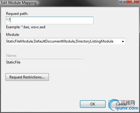

  Notice the "StaticFile" handler. Currently it's set to match * and catch both File and Directory requests. If you look back at the first image, you'll notice that the error message details that the handler causing the 404 error is the StaticFile handler. As I know that all my static files will have a file extension (also I don't care for directory browsing), I'll simply change my StaticFile handler so it only matches *.* - and only files.
  Your StaticFile handler should now look like this:

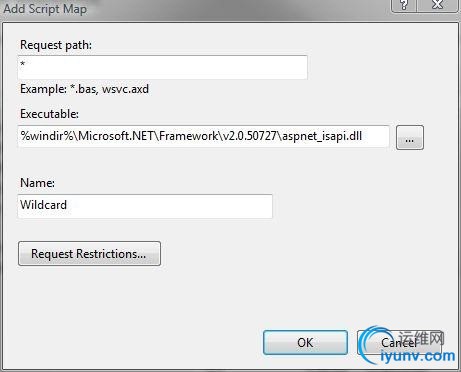

  What needs to be done now is that we need to map any and all requests to the aspnet_isapi.dll isapi file - just like we would usually do in IIS 6.

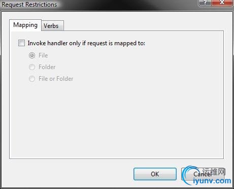

  Add a new Script Map to the list of Handler Mappings and set it up like this:
  Click OK and click Yes at the confirmation dialog:

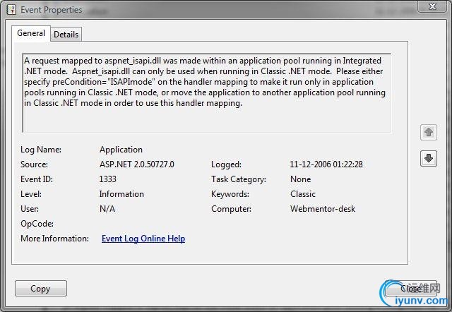

  Now if you make a request to either http://localhost or any other file you'll get the following error:
  Looking throug the Event log reveals the cause of the error:

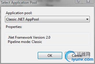

  The aspnet_isapi.dll file cannot be used as a Handler for websites running in the new IIS 7 Integrated Mode, thus we will need to make our website run in classic .NET mode. Right click your website node in the IIS Manager and select Advanced Settings. Select the "Classic .NET AppPool" and close the dialog boxes:

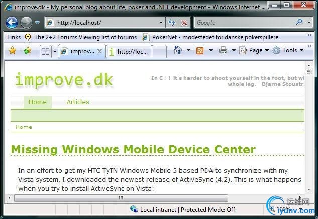

  Now you should be able to make a request to http://localhost and see it work. Your URL rewriting should work as a charm aswell:

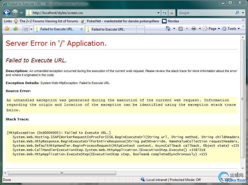

  But obviously somethings wrong. Making a request to any static file will reveal the problem:
  "Failed to Execute URL", what a great descriptive error. Fortunately you won't have to spend hours ripping out hair... As I have already done that - at least I'll save a trip or two to the barber.
  The problem is that the static files are being processed by the aspnet_isapi.dll file instead of simply sending the request along to the StaticFile handler. If you click the "View Ordered List..." link in the IIS Manager from the Handler Mappings view, you'll see the order in which the handlers are being executed for each request:
  When you add a new Script Map it'll automatically get placed at the very top of the line taking precedence over any other handlers, including the StaticFile one.
  What we have to do is to move our Wildcard handler to the very bottom, below the StaticFile handler. By letting the StaticFile handler have precedence over our Wildcard handler we ensure that any static files (matching *.*) gets processed correctly while any other URL's gets passed along to our own Wildcard handler that'll do the URL rewriting and make business work as usual:
  After doing so, both static files as well as your custom URL's should execute as they would under IIS 6:
