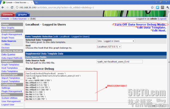

3、Cacti 搭建完成后,发现图像显示不出,如下图:
解决办法:
(1)检查以下包是否都已经安装
yum -y install zlib libpng freetype libart_lgpl libart_lgpl-devel libxml* pango*
(2)检查rra 目录下是否已经生成rrd 文件
Console -> Data Source -> 选择没有图像的数据源 -> Turn On Data Source Debug MTurnode
复制调试命令到监控端以cacti用户执行
执行后会生成rrd文件
localhost_load_1min_5.rrd    localhost_mem_swap_4.rrd  localhost_users_6.rrdTechnical]4、RRDTool]date.timezone =Asia/Shanghai

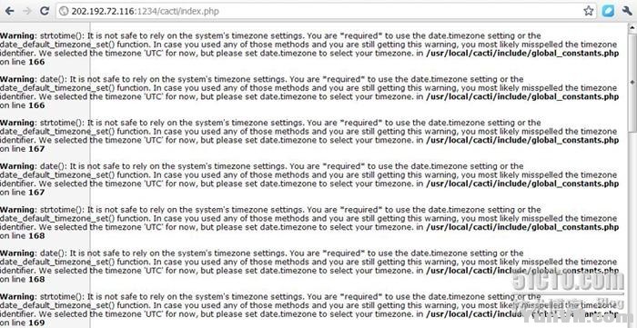

7、有以下错误提示:
      网上资料大部分说只要设置php.ini 中的date.timezone = Asia/Shanghai 即可。但是在Php5.3版本下,这个方法并没有作用
解决办法:
根据错误提示
Warning: strtotime(): It is not safe to rely on the system's timezone settings. You are *required* to use the date.timezone setting or the date_default_timezone_set() function. In case you used any of those methods and you are still getting this warning, you most likely misspelled the timezone identifier. We selected the timezone 'UTC' for now, but please set date.timezone to select your timezone. in /usr/local/cacti/include/global_constants.phpon line 166
[iyunv@localhost install]# vim /usr/local/cacti/include/global_constants.php
根据提示,在166行加入了一下内容:
date_default_timezone_set('Asia/Shanghai');
页面即恢复正常
