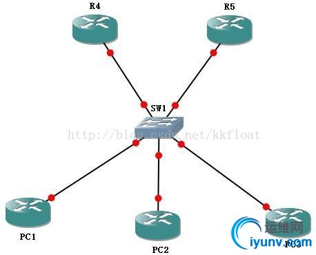

实验一、组播中的IGMP
PC1配置
Router>en
Router#conf t
PC2(config)#no ip routing //禁止路由功能,让路由器作为主机
Router#hostname PC1
PC1(config)#ip default-gateway192.168.1.1 //指定网关
PC1(config)#int fa0/0
PC1(config-if)#ip add 192.168.1.3255.255.255.0
PC1(config-if)#ip igmp join-group224.1.1.1 //利用IGMP协议指定加入组播组的地址
PC1(config-if)#no sh
PC1(config-if)#exit
PC2配置:
Router>en
Router#conf t
Router(config)#hostname PC2
PC2(config)#ip default-gateway192.168.1.1
PC2(config)#int fa0/0
PC2(config-if)#ip add 192.168.1.2255.255.255.0
PC2(config-if)#ip igmp join-group224.1.1.1
PC2(config-if)#no sh
PC2(config-if)#exit
PC3配置:
Router>en
Router#conf t
Router(config)#hostname PC3
PC3(config)#no ip routing
PC3(config)#ip default-gateway192.168.1.1
PC3(config)#int fa0/0
PC3(config-if)#ip add 192.168.1.4 255.255.255.0
PC3(config-if)#ip igmp join-group224.1.1.1
PC3(config-if)#no sh
PC3(config-if)#exit
SW配置:
R4配置:
Router>en
Router#conf t
Router(config)#hostname R4
R4(config)#ip multicast-routing //开启组播路由协议
R4(config)#int fa0/0
R4(config-if)#ip add 192.168.1.1255.255.255.0
R4(config-if)#ip pim sparse-mode //端口下指定组播路由协议的模式为密集型
R4(config-if)#no sh
R5配置:
Router>en
Router#conf t
Router(config)#hostname R5
R5(config)#ip multicast-routing
R5(config)#int fa0/0
R5(config-if)#ip add 192.168.1.5255.255.255.0
R5(config-if)#ip pim sparse-mode
R5(config-if)#no sh
第一完成配置后查看,主机是否加入了组播组,路由器是否正常
R4#sh ip igmp groups    //R4查看组播组
IGMP Connected Group Membership
Group Address    Interface                Uptime    Expires  Last Reporter   Group Accounted
224.1.1.1        FastEthernet0/0          00:02:06  00:02:51 192.168.1.3
224.0.1.40       FastEthernet0/0          00:14:31  00:02:52 192.168.1.5
R4#sh ip igmp interface  //查看谁是查询器,谁是DR。IP地址小的成为DR
FastEthernet0/0 is up, line protocol isup
Internet address is 192.168.1.1/24
IGMP is enabled on interface
Current IGMP host version is 2
  Current IGMP router version is 2
  IGMP query interval is 60 seconds
  IGMP querier timeout is 120 seconds
  IGMP max query response time is 10 seconds
  Last member query count is 2
Last member query response interval is 1000 ms
Inbound IGMP access group is not set
IGMP activity: 2 joins, 0 leaves
Multicast routing is enabled on interface
Multicast TTL threshold is 0
  Multicast designatedrouter (DR) is 192.168.1.5   //R5是D5
  IGMP querying routeris 192.168.1.1 (this system)     //R4是查询器发送查询报文
Multicast groups joined by this system (number of users):
     224.0.1.40(1)
R4#debug ip igmp//调试IGMP报文
IGMP debugging is on
*Mar  1 00:22:00.683: IGMP(0): Send v2 generalQuery on FastEthernet0/0 // 发送查询报文
*Mar 1 00:22:00.683: IGMP(0): Set report delay time to 9.8 seconds for224.0.1.40 on FastEthernet0/0
*Mar  1 00:22:03.663: IGMP(0): Received v2 Reporton FastEthernet0/0 from 192.168.1.3 for 224.1.1.1 //主机发送加入组播组的报文
*Mar 1 00:22:03.667: IGMP(0): Received Group record for group 224.1.1.1, mode2 from 192.168.1.3 for 0 sources
*Mar  100:22:03.667: IGMP(0): Updating EXCLUDE group timer for 224.1.1.1
*Mar 1 00:22:03.671: IGMP(0): MRT Add/Update FastEthernet0/0 for(*,224.1.1.1) by 0
*Mar 1 00:22:09.403: IGMP(0): Received v2 Report on FastEthernet0/0 from192.168.1.5 for 224.0.1.40
*Mar 1 00:22:09.403: IGMP(0): Received Group record for group 224.0.1.40,mode 2 from 192.168.1.5 for 0 sources
*Mar 1 00:22:09.403: IGMP(0): Cancel report for 224.0.1.40 on FastEthernet0/0
*Mar 1 00:22:09.403: IGMP(0): Updating EXCLUDE group timer for 224.0.1.40
*Mar 1 00:22:09.403: IGMP(0): MRT Add/Update FastEthernet0/0 for(*,224.0.1.40) by 0
第二先把PC3离开组播组,观察R4变化
PC3#conf t
PC3(config-if)#no ip igmp join-group224.1.1.1 //PC3离开组播组224.1.1.1
R4#conf t
R4#debug ip igmp //调试R4的IGMP包
*Mar  1 01:27:24.091: IGMP(0): Received Leave from192.168.1.4 (FastEthernet0/0) for 224.1.1.1//PC3发给R4离开组播组的报文
*Mar 1 01:27:24.095: IGMP(0): Received Group record for group 224.1.1.1, mode3 from 192.168.1.4 for 0 sources
*Mar  1 01:27:24.095: IGMP(0): Lower expirationtimer to 2000 msec for 224.1.1.1 on FastEthernet0/0//将组播组224.1.1.1的超时时间设置为2000msec,
*Mar  1 01:27:24.095: IGMP(0): Send v2 Query onFastEthernet0/0 for group 224.1.1.1
*Mar  1 01:27:25.099: IGMP(0): Send v2 Query onFastEthernet0/0 for group 224.1.1.1
*Mar  1 01:27:26.099: IGMP(0): Switching to INCLUDEmode for 224.1.1.1 on FastEthernet0/0
//R4连续发了两个特定组查询消息(Group-Specific Query),试图通过这种方式确认224.1.1.1组中是否有其他组员了,并且将组播组转换到收录模式
*Mar  1 01:27:26.575: IGMP(0): Received v2 Reporton FastEthernet0/0 from 192.168.1.3 for 224.1.1.1
*Mar  1 01:27:26.575: IGMP(0): Received Grouprecord for group 224.1.1.1, mode 2 from 192.168.1.3 for 0 sources
*Mar  1 01:27:26.579: IGMP(0): WAVL Insert group:224.1.1.1 interface: FastEthernet0/0Successful
*Mar  1 01:27:26.579: IGMP(0): Switching to EXCLUDEmode for 224.1.1.1 on FastEthernet0/0
*Mar  1 01:27:26.583: IGMP(0): Updating EXCLUDEgroup timer for 224.1.1.1
*Mar  1 01:27:26.583: IGMP(0): MRT Add/UpdateFastEthernet0/0 for (*,224.1.1.1) by 0
//一个成员回复了查询以便通告自己的存在。R4知道组224.1.1.1里仍有组成员存在,马上回复组播组到正常状态。

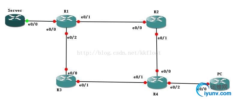

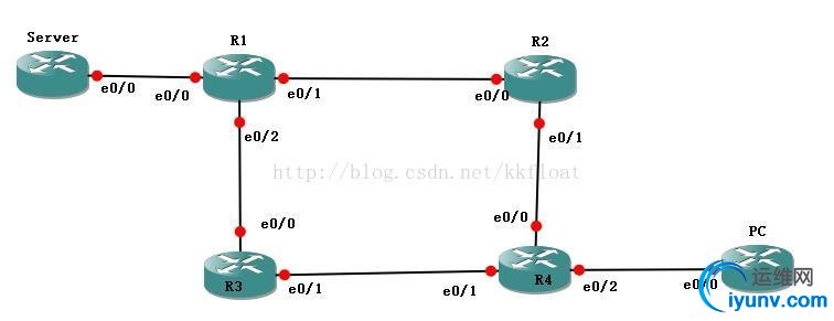

实验二、组播的PIM-DM模式(Dense-mode)
Server配置:
Server#conf t
Server(config)#no ip routing
Server(config)#ip default-gateway 192.168.5.1
Server(config)#int e0/0
Server(config-if)#ip add 192.168.5.2255.255.255.0
Server(config-if)#no sh
Server(config-if)#exit
R5配置:
R5#conf t
R5(config)#int e0/0
R5(config-if)#ip add 12.168.5.1 255.255.255.0
R5(config-if)#ippim dense-mode
R5(config-if)#no sh
R5(config-if)#exit
R5(config)#int e0/1
R5(config-if)#ip add 192.168.51.5255.255.255.0
tR5(config-if)#ip pim dense-mode

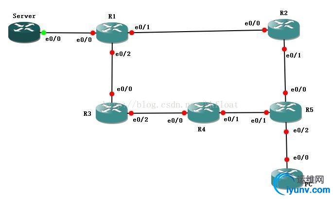

R1配置:
R1#conf t
R1(config)#ip multicast-routing
R1(config)#int e0/0
R1(config-if)#ip add 192.168.51.1255.255.255.0
R1(config-if)#ip pim dens
R1(config-if)#ip pim dense-mode
R1(config-if)#no sh
R1(config-if)#exit
R1(config)#int e0/1
R1(config-if)#ip add 192.168.13.1255.255.255.0
R1(config-if)#no sh
R1(config-if)#exit
R1(config)#router ospf 1
R1(config-router)#net 0.0.0.0 0.0.0.0 area 0
R1(config-router)#exit
R2配置:
R2#conf t
R2(config)#ip multicast-routing
R2(config)#int e0/0
R2(config-if)#ip add 192.168.52.2255.255.255.0
R2(config-if)#ip pim den
R2(config-if)#ip pim dense-mode
R2(config-if)#no sh
R2(config-if)#exit
R2(config)#int e0/1
R2(config-if)#ip add 192.168.24.2255.255.255.0
R2(config-if)#no sh
R2(config-if)#exit
R2(config)#router ospf 1
R2(config-router)#net 0.0.0.0 0.0.0.0 area 0
R2(config-router)#exit
R3配置:
R3#conf t
R3(config)#ip multicast-routing
R3(config)#int e0/1
R3(config-if)#ip add 192.168.13.3255.255.255.0
R3(config-if)#ip pim dense-mode
R3(config-if)#no sh
R3(config-if)#exit
R3(config)#int e0/0
R3(config-if)#ip add 192.168.0.1255.255.255.0
R3(config-if)#no sh
R3(config-if)#exit
R3(config)#router ospf 1
R3(config-router)#net 0.0.0.0 0.0.0.0 area 0
R3(config-router)#exit
配置R4
R4#conf t
R4(config)#int e0/0
R4(config-if)#ip add 192.168.0.2255.255.255.0
R4(config-if)#ip pim dense-mode
R4(config-if)#no sh
R4(config-if)#exit
R4(config)#int e0/1
R4(config-if)#ip add 192.168.24.4255.255.255.0
R4(config-if)#no sh
R4(config-if)#exit
R4(config)#int e0/2
R4(config-if)#ip add 192.168.46.4255.255.255.0
R4(config-if)#no sh
R4(config-if)#exit
R4(config)#router ospf 1
R4(config-router)#net 0.0.0.0 0.0.0.0 area 0
R4(config-router)#exit
配置R6
R6#conf t
R6(config)#ip multicast-routing
R6(config)#int e0/0
R6(config-if)#ip add 192.168.46.6255.255.255.0
R6(config-if)#ip pim dense-mode
R6(config-if)#no sh
R6(config-if)#exit
R6(config)#router ospf 1
R6(config-router)#net 0.0.0.0 0.0.0.0 area 0
R6(config-router)#exit
PC1配置:
PC1#conf t
PC1(config)#no ip routing
PC1(config)#ip default-gateway 192.168.0.1
PC1(config)#int e0/0
PC1(config-if)#ip add 192.168.0.5255.255.255.0
PC1(config-if)#ip igmp join-group 224.1.1.1
PC1(config-if)#exit
完成以上配置后:所有路由器的多播路由表如下:
R2#sh ip mroute //PIM-DM需要有组播流才形成树
IP Multicast Routing Table
Flags: D - Dense, S - Sparse, B - BidirGroup, s - SSM Group, C - Connected,
      L - Local, P - Pruned, R - RP-bit set, F - Register flag,
      T - SPT-bit set, J - Join SPT, M - MSDP created entry,
       X - Proxy Join Timer Running, A - Candidatefor MSDP Advertisement,
      U - URD, I - Received Source Specific Host Report,
      Z - Multicast Tunnel, z - MDT-data group sender,
      Y - Joined MDT-data group, y - Sending to MDT-data group
Outgoing interface flags: H - Hardwareswitched, A - Assert winner
Timers: Uptime/Expires
Interface state: Interface, Next-Hop or VCD,State/Mode
(*, 224.0.1.40), 00:33:39/00:02:51, RP0.0.0.0, flags: DCL
Incoming interface: Null, RPF nbr 0.0.0.0
  Outgoinginterface list:
   Ethernet0/1, Forward/Dense, 00:27:46/00:00:00
   Ethernet0/0, Forward/Dense, 00:33:39/00:00:00
接着在Server端Ping 224.1.1.1  组播组,发现变化
Server#ping224.1.1.1 repeat 100 //注意有了组播源才有路,ping结束后路也消失
Type escapesequence to abort.
Sending 100,100-byte ICMP Echos to 224.1.1.1, timeout is 2 seconds:
Reply torequest 45 from 192.168.0.5, 264 ms
Reply torequest 46 from 192.168.0.5, 248 ms
Reply torequest 47 from 192.168.0.5, 204 ms
R1#sh ipmroute //R1没有SPT
IP MulticastRouting Table
Flags: D -Dense, S - Sparse, B - Bidir Group, s - SSM Group, C - Connected,
       L - Local, P - Pruned, R - RP-bit set, F- Register flag,
       T - SPT-bit set, J - Join SPT, M - MSDPcreated entry,
       X - Proxy Join Timer Running, A -Candidate for MSDP Advertisement,
       U - URD, I - Received Source SpecificHost Report,
       Z - Multicast Tunnel, z - MDT-data groupsender,
       Y - Joined MDT-data group, y - Sendingto MDT-data group
Outgoinginterface flags: H - Hardware switched, A - Assert winner
(*,224.0.1.40), 00:39:13/00:02:24, RP 0.0.0.0, flags: DCL
  Outgoing interface list:
    Ethernet0/1, Forward/Dense,00:33:20/00:00:00
Ethernet0/0,Forward/Dense, 00:39:13/00:00:00
R2#sh ipmroute //R2生成了SPT
       Z- Multicast Tunnel, z - MDT-data group sender,
(*, 224.1.1.1), 00:06:24/stopped,RP 0.0.0.0, flags: D
   Ethernet0/1, Forward/Dense, 00:06:24/00:00:00
Ethernet0/0,Forward/Dense, 00:06:24/00:00:00
(192.168.5.2, 224.1.1.1), 00:06:24/00:00:09,flags: T
Incoming interface: Ethernet0/0, RPF nbr 192.168.52.5
   Ethernet0/1, Forward/Dense, 00:06:27/00:00:00
(*,224.0.1.40), 00:32:25/00:02:34, RP 0.0.0.0, flags: DCL
    Ethernet0/1, Forward/Dense,00:25:04/00:00:00
Ethernet0/0,
Forward/Dense, 00:32:25/00:00:00
R4#sh ipmroute //R4链接R6的接口会剪枝
(*,224.1.1.1), 01:25:39/stopped, RP 0.0.0.0, flags: D
    Ethernet0/2, Forward/Dense,01:25:39/00:00:00
    Ethernet0/1, Forward/Dense,01:25:39/00:00:00
    Ethernet0/0, Forward/Dense,01:25:39/00:00:00
(192.168.5.2,224.1.1.1), 00:00:04/00:02:55, flags: T
  Incoming interface: Ethernet0/1, RPF nbr192.168.24.2
    Ethernet0/0, Forward/Dense,00:00:08/00:00:00
    Ethernet0/2, Prune/Dense, 00:00:08/00:02:54
(*,224.0.1.40), 01:32:39/00:02:37, RP 0.0.0.0, flags: DCL
    Ethernet0/2, Forward/Dense,01:28:28/00:00:00
    Ethernet0/1, Forward/Dense,01:32:08/00:00:00
    Ethernet0/0, Forward/Dense,01:32:39/00:00:00

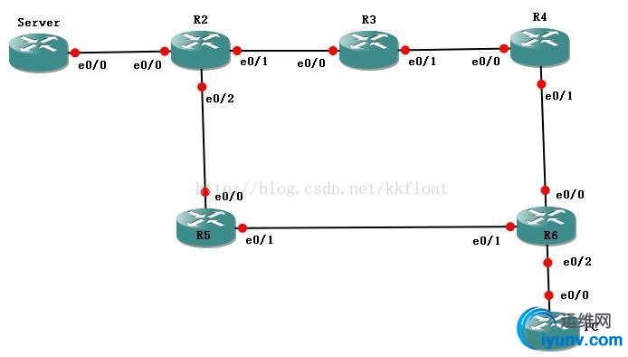

实验三、组播PIM-SM(静态RP、SPT自动切换RPT)
Server配置:
Server#conft
Server(config)#noip routing
Server(config)#ipdefault-gateway 192.168.0.1
Server(config)#inte0/0
Server(config-if)#ipadd 192.168.0.2 255.255.255.0
Server(config-if)#nosh
R2配置:
R2#conf t
R2(config)#ipmulticast-routing
R2(config)#ippim rp-address 3.3.3.3
R2(config)#inte0/0
R2(config-if)#ipadd 192.168.0.1 255.255.255.0
R2(config-if)#ippim sparse-mode
R2(config-if)#nosh
R2(config-if)#exit
R2(config)#inte0/1
R2(config-if)#ipadd 192.168.23.2 255.255.255.0
R2(config-if)#nosh
R2(config-if)#exit
R2(config)#inte0/2
R2(config-if)#ipadd 192.168.25.2 255.255.255.0
R2(config-if)#nosh
R2(config-if)#exit
R2(config)#routerospf 1
R2(config-router)#net0.0.0.0 0.0.0.0 area 0
R3配置:
R3#conf t
R3(config)#ipmulticast-routing
R3(config)#ippim rp-address 3.3.3.3
R3(config)#intlo0
R3(config-if)#ipadd 3.3.3.3 255.255.255.0
R3(config-if)#ippim sparse-mode
R3(config-if)#exit
R3(config)#inte0/0
R3(config-if)#ipadd 192.168.23.3 255.255.255.0
R3(config-if)#nosh
R3(config-if)#exit
R3(config)#inte0/1
R3(config-if)#ipadd 192.168.34.3 255.255.255.0
R3(config-if)#nosh
R3(config-if)#exit
R3(config)#routerospf 1
R3(config-router)#net0.0.0.0 0.0.0.0 area 0
R4配置:
R4#conf t
R4(config)#ipmulticast-routing
R4(config)#ippim rp-address 3.3.3.3
R4(config)#inte0/0
R4(config-if)#ipadd 192.168.34.4 255.255.255.0
R4(config-if)#ippim sparse-mode
R4(config-if)#nosh
R4(config-if)#exit
R4(config)#inte0/1
R4(config-if)#ipadd 192.168.46.4 255.255.255.0
R4(config-if)#nosh
R4(config-if)#exit
R4(config)#routerospf 1
R4(config-router)#net0.0.0.0 0.0.0.0 area 0
R5配置:
R5#conf t
R5(config)#ipmulticast-routing
R5(config)#ippim rp-address 3.3.3.3
R5(config)#inte0/0
R5(config-if)#ipadd 192.168.25.5 255.255.255.0
R5(config-if)#nosh
R5(config-if)#exit
R5(config)#inte0/1
R5(config-if)#ipadd 192.168.56.5 255.255.255.0
R5(config-if)#nosh
R5(config-if)#exit
R5(config)#routerospf 1
R5(config-router)#net0.0.0.0 0.0.0.0 area 0
R5(config-router)#exit
R6配置:
R6#conf t
R6(config)#ipmulticast-routing
R6(config)#ippim rp-address 3.3.3.3
R6(config)#inte0/1
R6(config-if)#ipadd 192.168.56.6 255.255.255.0
R6(config-if)#nosh
R6(config-if)#exit
R6(config)#inte0/0
R6(config-if)#ipadd 192.168.46.6 255.255.255.0
R6(config-if)#ippim sparse-mode
R6(config-if)#nosh
R6(config-if)#exit
R6(config)#inte0/1
R6(config-if)#exit
R6(config)#inte0/2
R6(config-if)#ipadd 192.168.2.1 255.255.255.0
R6(config-if)#nosh
R6(config-if)#exit
R6(config)#routerospf 1
R6(config-router)#net0.0.0.0 0.0.0.0 area 0
PC配置:
PC#conf t
PC(config)#noip routing
PC(config)#ipdefault-gateway 192.168.2.1
PC(config)#inte0/0
PC(config-if)#ipadd 192.168.2.2 255.255.255.0
PC(config-if)#ipigmp join-group 224.1.1.1
PC(config-if)#nosh
PC(config-if)#
完成以上配置后,在Server端ping 224.1.1.1的组播组地址,进行RP注册,然后查看R3与R6的多播路由:
Reply torequest 0 from 192.168.2.2, 168 ms
Reply torequest 1 from 192.168.2.2, 180 ms
R3#sh ip mr //RP中的注册信息
(*, 224.1.1.1), 00:17:50/stopped,RP 3.3.3.3, flags: S
   Ethernet0/1, Forward/Sparse, 00:06:51/00:02:35
(192.168.0.2, 224.1.1.1),00:17:50/00:03:24, flags: T
Incoming interface: Ethernet0/0, RPF nbr 192.168.23.2
(192.168.46.6, 224.1.1.1),00:00:37/00:02:52, flags: PTX
Incoming interface: Ethernet0/1, RPF nbr 192.168.34.4
Outgoing interface list: Null
(*,224.0.1.40), 00:55:31/00:02:46, RP 3.3.3.3, flags: SJCL
    Ethernet0/1, Forward/Sparse,00:06:53/00:02:55
    Ethernet0/0, Forward/Sparse,00:31:20/00:02:43
Loopback0,Forward/Sparse, 00:55:33/00:02:44
R6#sh ip mroute //得到RPT表项,收到第一个组播数据后,就切换了自动切换到SPT
(*, 224.1.1.1), 00:44:24/stopped,RP 3.3.3.3, flags: SJCF   //RPT 次优路径

实验四、思科私有协议PIM-Spare-Dense-Mode(动态Auto-RP)
CISCO Auto-RP可以解决静态RP选择不灵活且没有冗余的问题(有备份RP)。要配置Auto-RP的有需要两个角色:candidate RP(RP候选者)、mapping agents收集RP地址信息并向外发送。 RP候选者以224.0.0.39的多播地址向外宣告自己为RP。mapping agents监听这个地址。mapping agents以224.0.0.40向外宣告究竟谁是RP。在3分钟之内如果没有收到任何 rp announce,则认为这个网络没有RP或者RP不可用。过程:
  • candidate rp 宣告自己要做某个组的rp,通告出去采用的ip地址224.0.1.39(默认每60s泛洪一次)(只有MA监听224.0.1.39这个组播地址)
  • MA (mapping agents) 它去决定那个做那个组的rp(看ip地址那个大,但是MA本身没有选举机制,可以存在多个,因为他们选出的RP是一致的,不会影响。),再 以224.0.1.40 的多播组地址通告候选 RP 的信息。末端路由器接收到这个 224.0.1.40 多播组的信息后就可以知道有哪些 RP,并且这些 RP 对应哪些多播组,从而可以自动发现 RP。 (所有运行组播的路由器都监听224.0.1.40这个组,默认每60S一次, holdtime=3x interval)
  • 候选 RP 和 RP 映射代理可以相互独立,不一定属于同一台路由器。但为了可靠起见,而通常将它们合为一体。
  • Auto-rp中没有对丢失数据包的检测和重传机制,所以auto-rp发现消息的传输是不可靠的。所以一般可以使用多个MA来提供冗余。
    RP的选举规则
  • 如果RP服务的组播地址完全冲突,(不同RP服务的组播地址范围完全一样)选举ip地址大的为RP。
  • 如果RP服务的组播地址不完全冲突,(不同RP服务的组播地址范围不完全一样)此时acl定义的服务范围小的RP 优先。
  • 对于多个RP MA,不用选举主MA,对于普通路由器,来自MA的消息可以相互覆盖。反正都是一样的。
  • auto rp 必须运行在sparse-dense-mode模式下,这是cisco的私有标准,如果运行在sparse-mode需要配置ip pim autorp listener。
Server配置:
Server#conft
Server(config)#ipdefault-gateway 192.168.1.1
Server(config-if)#ipadd 192.168.1.2 255.255.255.0
R1配置:
R1#conf t
R1(config)#int e0/0
R1(config-if)#exit
R1(config)#int e0/0
R1(config-if)#ip add 192.168.1.1 255.255.255.0
R1(config-if)#ip pim sparse-dense-mode
R1(config-if)#no sh
R1(config-if)#exit
R1(config)#int e0/1
R1(config-if)#ip add 192.168.12.1 255.255.255.0
R1(config-if)#no sh
R1(config-if)#exit
R1(config)#int e0/2
R1(config-if)#ip add 192.168.13.1 255.255.255.0
R1(config-if)#no sh
R1(config-if)#exit
R2配置:
R2#conf t
R2(config)#int e0/0
R2(config-if)#ip add 192.168.12.2 255.255.255.0
R2(config-if)#ip pim sparse-dense-mode
R2(config-if)#no sh
R2(config-if)#exit
R2(config)#int e0/1
R2(config-if)#ip add 192.168.24.2 255.255.255.0
R2(config-if)#no sh
R2(config-if)#exit
R2(config)#int lo0
R2(config-if)#ip add 2.2.2.2 255.255.255.0
R2(config-if)#exit
R2(config)#ip pim send-rp-announce loopback 0scope 20
R2(config)#ip pim send-rp-discovery loopback 0scope 20
R3配置:
R3#conf t
R3(config)#int e0/0
R3(config-if)#ip add 192.168.13.3 255.255.255.0
R3(config-if)#ip pim sparse-dense-mode
R3(config-if)#no sh
R3(config-if)#exit
R3(config)#int e0/1
R3(config-if)#ip add 192.168.34.3 255.255.255.0
R3(config-if)#no sh
R3(config-if)#exit
R3(config-if)#ip add 3.3.3.3 255.255.255.0
R3(config-if)#exit
R3(config)#ip pim send-rp-announce loopback 0scope 20
R3(config)#ip pim send-rp-discovery loopback 0scope 20
R4配置:
R4#conf t
R4(config)#int e0/0
R4(config-if)#ip add 192.168.24.4 255.255.255.0
R4(config-if)#ip pim sparse-dense-mode
R4(config-if)#no sh
R4(config-if)#exit
R4(config)#int e0/1
R4(config-if)#ip add 192.168.34.4 255.255.255.0
R4(config-if)#no sh
R4(config-if)#exit
R4(config)#int e0/2
R4(config-if)#ip add 192.168.0.1 255.255.255.0
R4(config-if)#no sh
R4(config-if)#exit
PC配置:
PC#conf t
PC(config)#no ip routing
PC(config)#ip default-gateway 192.168.0.1
PC(config)#int e0/0
PC(config-if)#ip add 192.168.0.2 255.255.255.0
PC(config-if)#ip igmp join-
PC(config-if)#ip igmp join-group 224.1.1.1
PC(config-if)#no sh
配置完成检查全网互通,查看R2、R3、R4

实验五、Bootstrap Router  (BSR业界标准协议)
在采用自举路由器(BootStrap Router)方式配置汇集点(Rendezvous Point)的方法中,一组路由器被配置为候选自举路由器(C-BSRs),一组路由器被配置为候选汇集点(C-RPs),通常建议这两组路由器是同样的路由器。候选汇集点会定期把候选汇集点通告消息(C-RP-Advs)以单播的形式发送到自举路由器;汇集点通告消息是一种PIM消息,它包括通告候选汇集点的地址、可选的组播组地址和一个掩码长度域(组的前缀);
自举路由器收集这些通告消息并产生相应的自举消息,自举消息也是一种PIM消息,它包括候选RP和相应的组前缀(ip为224.0.0.13即所有使能pim的路由器,每60s泛洪一次。让其他路由器知道 BSR的位置。 同时也是通过这样的方式把RP信息发送出去),自举消息主要用于自举路由器的选择和分发RP点信息。自举消息支持一个简单的机制以便于侯选自举路由器之间选择出活跃的自举路由器,一般是优先级最高的自举路由器被选择为活跃的自举路由器。BSR不决定RP,只是收集RP候选信息并通告这些信息。多个BSR存在选举原则
  • 优先级默认为0,值越小越优先,越有可能成为Active BSR
  • 优先级相同(默认0),ip地址值越大越优,越可能成为active BSR
    为获得RP信息,所有普通路由器都要收集自举(Bootstrap)消息,即普通路由器接收并保存由自举路由器发送来的自举消息,它采用在自举消息中发布的一组可用汇集点来获得合适的组播组到汇集点的映射。所有路由器采用散列函数来计算组播组和汇集点的映射关系,散列函数的算法是把组播组地址和候选汇集点的地址作为输入值,从而得到一个组播组的实际RP地址。 其他路由器收到信息后会选择自己的RP,依据原则选择RP为:
    • 最长匹配组(acl覆盖的范围小的优先)
    • RP优先级数值低的
    • bsr的哈希值,可以做到冗余处理
    • ip地址大的
      Server配置:
      Server#conft
      R1配置:
      R1#conf t
      R1(config)#int e0/0
      R1(config-if)#ip add 192.168.1.1255.255.255.0
      R1(config-if)#ip pim sparse-mode
      R1(config-if)#no sh
      R1(config-if)#exit
      R1(config)#int e0/1
      R1(config-if)#ip add 192.168.12.1255.255.255.0
      R1(config-if)#no sh
      R1(config-if)#exit
      R1(config)#int e0/2
      R1(config-if)#no sh
      R1(config-if)#exit
      R1(config-router)#net 0.0.0.0 0.0.0.0area 0
      R2配置:
      R2#conf t
      R2(config)#int e0/0
      R2(config-if)#ip add 192.168.12.2255.255.255.0
      R2(config-if)#ip pim sparse-mode
      R2(config-if)#no sh
      R2(config-if)#exit
      R2(config)#int e0/1
      R2(config-if)#ip add 192.168.25.2255.255.255.0
      R2(config-if)#no sh
      R2(config-if)#exit
      R2(config)#int lo0
      R2(config-if)#ip add 2.2.2.2255.255.255.255
      R2(config-if)#exit
      R2(config)#ip pim bsr-candidate loopback0
      R2(config)#ip pim rp-candidate loopback0
      R2(config-router)#net 0.0.0.0 0.0.0.0area 0
      R3配置:
      R3#conf t
      R3(config)#ip multi
      R3(config)#int e0/0
      R3(config-if)#ip pim sparse-mode
      R3(config-if)#no sh
      R3(config-if)#exit
      R3(config)#int e0/1
      R3(config-if)#ip add 192.168.34.3255.255.255.0
      R3(config-if)#no sh
      R3(config-if)#exit
      R3(config-router)#net 0.0.0.0 0.0.0.0area 0
      R4配置;
      R4#conf t
      R4(config)#int e0/0
      R4(config-if)#ip add 192.168.34.4255.255.255.0
      R4(config-if)#no sh
      R4(config-if)#exit
      R4(config)#int e0/1
      R4(config-if)#ip add 192.168.45.4255.255.255.0
      R4(config-if)#no sh
      R4(config-if)#exit
      R4(config)#int lo0
      R4(config-if)#ip add 4.4.4.4255.255.255.255
      R4(config-if)#exit
      R4(config)#ip pim bsr-candidate loopback0
      R4(config)#ip pim rp-candidate loopback0
      R4(config-router)#net 0.0.0.0 0.0.0.0area 0
      R5配置:
      R5#conf t
      R5(config)#int e0/0
      R5(config-if)#ip add 192.168.25.5255.255.255.0
      R5(config-if)#no sh
      R5(config-if)#exit
      R5(config)#int e0/1
      R5(config-if)#ip add 192.168.45.5255.255.255.0
      R5(config-if)#no sh
      R5(config-if)#exit
      R5(config-if)#exit
      R5(config)#int e0/2
      R5(config-if)#ip add 192.168.0.1255.255.255.0
      R5(config-if)#no sh
      R5(config-if)#exit
      R5(config)#router ospf 1
      R5(config-router)#net 0.0.0.0 0.0.0.0area 0
      PC配置:
      PC#conf t
      PC(config)#ip default-gateway192.168.0.1
      PC(config)#int e0/0
      PC(config-if)#ip add 192.168.0.2255.255.255.0
      PC(config-if)#ip igmp join-group224.1.1.1
      PC(config-if)#no sh
      PC(config-if)#exit
      完成以上配置查看R5、R2、R4
      R5#sh ip pim bsr-router //活动BSR为R4
      PIMv2 Bootstrap information
      BSR address: 4.4.4.4 (?)
      Uptime:      00:00:32, BSRPriority: 0, Hash mask length: 0
      Expires:     00:01:37
      R2#sh ip mroute //R2不是RP没有收到注册信息
            X - Proxy Join Timer Running, A - Candidate for MSDP Advertisement,
      (*, 224.0.1.40), 00:27:56/00:02:40, RP0.0.0.0, flags: DCL
      Ethernet0/0,Forward/Sparse, 00:27:56/00:02:40
      R4#sh ip mroute //R4有注册信息,说明它被选为RP
      Outgoing interface flags: H - Hardware switched,A - Assert winner
      (*, 224.1.1.1),00:12:29/00:02:49, RP 4.4.4.4, flags: S
         Ethernet0/1, Forward/Sparse, 00:12:29/00:02:49
      (*, 224.0.1.40), 00:22:23/00:02:35, RP0.0.0.0, flags: DCL
         Ethernet0/0, Forward/Sparse, 00:22:23/00:02:35
      从Server端ping 224.1.1.1,检查变化:

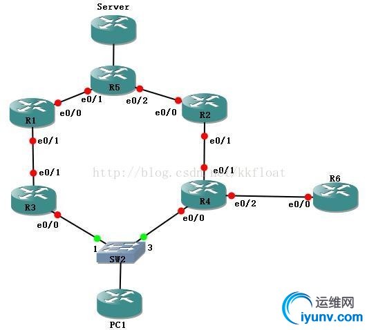

      实验六、组播双向树
    • PIM Sparse-Mode (PIM-SM)是单向树的转发,初始组播流量从源发送到RP,然后由RP使用共享树转发给接收者;如果RP不在最短路径树上,会发生自动的从源到接受者的最短路径树的计算,进而生成源树路由条目(S,G);这样的行为可能导致路由器维护比较多的源树路由条目(S,G),造成一定的系统和网络资源的占用。Bidirectional PIM (Bidir-PIM)即双向PIM属于PIM-SM的一个分支和扩展技术,能够优化PIM-SM单向树所导致的资源占用问题。
      在Bidir-PIM运行模式下,无需建立任何源树条目(S,G),所有的组播流量都使用共享树转发(*,G),在该模式下,没有任何源注册消息,组播源和接收者都加入到同一棵共享树。 Bidir-PI基本術語
    • MulticastRouting Information Base (MRIB)pim协议根据单播路由表计算的到RP的组播共享树路径。
    • RendezvousPoint Address (RPA)
    • RendezvousPoint Link (RPL),即RP的直连链路
    • DesignatedForwarder (DF)   替代了DR,同时也是一种防环机制 除了RPL外(RPL不选举DF),在组播域中的每条链路都会自动选举一个唯一的DF路由器,选举原则为对比同一条链路的每个接口到RP的单播路径, 具有最佳路径的接口的路由器被选为DF。DF负责转发该链路 的组播流量,也负责处理来自下游路由器的共享树加入消息
    • RPFInterface  :每个路由器去往RP的最佳路径的接口,是与DF直连的接口。
      Bidir-PIM组播路由的状态对于每个特定的组和RP,在每个路由器建立以下的组播转发路径:
    • 从组播源到RP的转发路径,沿着RPF接口转发到RP。
    • 从RP到组播接收者的转发路径,或者从组播源直接转发到接收者的路径
      按照以上方法建立转发路径,组播路由表项:
  • 仅仅有(*,G),falg为B
  • 没有入接口,只有Bidir-Upstream,去往RP
  • 出站接口列表:forward代表把流量转发给接收者;Bidir-Upstream代表拷贝自上行流量接口。
    Bidir-PIM的对组播包的转发
    • 仅仅当一个数据包是来自RPF接口(从源到RP方向),或者来自DF路由器的接口(从RP到接收者方向);路由器才会接收该数据包。
    • 路由器开始构建数据包的转发出口,从所有的出站接口列表中删除入站接口,如果出站接口列表不为空,将数据包转发给其它所有的出站接口。
    • 如果源与RP在同一侧,直接发送给接受者
      Server1配置:
      Server#conf t
      Server(config)#no ip routiiing
      Server(config)#ip default-gateway 192.168.1.1
      Server(config-if)#ip add 192.168.1.2 255.255.255.0
      R1配置:
      R1#conf t
      R1(config)#ip pim bidir-enable
      R1(config)#ip pim rp-address 3.3.3.3 bidir
      R1(config)#int e0/0
      R1(config-if)#no sh
      R1(config-if)#exitp
      R1(config)#int e0/1
      R1(config-if)#no sh
      R1(config-if)#exit
      R1(config)#int e0/2
      R1(config-if)#no sh
      R1(config-if)#exit
      R2配置:
      R2#conf t
      R2(config)#ip pim bidir-enable
      R2(config)#ip pim rp-address 3.3.3.3 bidir
      R2(config)#int e0/0
      R2(config-if)#no sh
      R2(config-if)#exit
      R2(config)#int e0/1
      R2(config-if)#no sh
      R2(config-if)#exit
      R3配置:
      R3#conf t
      R3(config)#ip pim bidir-enable
      R3(config)#ip pim rp-address 3.3.3.3 bidir
      R3(config)#int e0/0
      R3(config-if)#no sh
      R3(config-if)#exit
      R3(config)#int e0/1
      R3(config-if)#no sh
      R3(config-if)#exit
      R3(config)#int lo0
      R3(config-if)#ip add 3.3.3.3 255.255.255.255
      R3(config-if)#exit
      R4配置:
      R4#conf t
      R4(config)#ip pim bidir-enable
      R4(config)#ip pim rp-address 3.3.3.3 bidir
      R4(config)#int e0/0
      R4(config-if)#no sh
      R4(config-if)#exit
      R4(config)#int e0/1
      R4(config-if)#no sh
      R4(config-if)#exit
      R4(config)#int e0/2
      R4(config-if)#ip add 192.168.0.1255.255.255.0
      R4(config-if)#no sh
      R4(config-if)#exit
      PC配置:
      PC#conf t
      PC(config)#int e0/0
      PC(config-if)#no sh
      PC(config-if)#exit
配置完成后观察R3
R3# debug ip pim
*Mar 1 00:09:36.027: PIM(0): Join-list: (*, 224.1.1.1), RPT-bit set, WC-bitset
*Mar 1 00:09:36.031: PIM(0): Check RP 3.3.3.3 into the (*, 224.1.1.1) entry
*Mar 1 00:09:36.031: PIM(0): Add Ethernet0/1/192.168.34.4 to (*, 224.1.1.1),Forward state, by PIM *G Join
*Mar 1 00:12:38.171: PIM(0): Received v2 Join/Prune on Ethernet0/0 from192.168.13.1, to us
*Mar 1 00:12:38.171: PIM(0): Join-list: (*, 224.0.1.40), RPT-bit set, WC-bitset, S-bit set
*Mar 1 00:12:38.171: PIM(0): Update Ethernet0/0/192.168.13.1 to (*,224.0.1.40), Forward state, by PIM *G Join
*Mar 1 00:10:34.471: PIM(0): Received v2 Join/Prune on Ethernet0/1 from192.168.34.4, to us
*Mar 1 00:10:34.471: PIM(0): Join-list: (*, 224.1.1.1), RPT-bit set, WC-bitset, S-bit set
*Mar 1 00:10:34.475: PIM(0): Update Ethernet0/1/192.168.34.4 to (*,224.1.1.1), Forward state, by PIM *G Join
*Mar 1 00:10:34.795: PIM(0): Building Periodic Join/Prune message for224.1.1.1
R3#ship mroute
IPMulticast Routing Table
Flags:D - Dense, S - Sparse, B - Bidir Group, s - SSM Group, C - Connected,
(*, 224.1.1.1),00:05:49/00:02:35, RP 3.3.3.3, flags: B
  Bidir-Upstream: Null, RPF nbr 0.0.0.0
    Ethernet0/1, Forward/Sparse,00:05:49/00:02:35
(*,224.0.1.40), 00:14:17/00:02:41, RP 3.3.3.3, flags: BCL
    Ethernet0/1, Forward/Sparse,00:09:11/00:02:41
Ethernet0/0, Forward/Sparse,00:13:16/00:02:38
R4#ship mroute
(*, 224.1.1.1),00:07:23/00:02:35, RP 3.3.3.3, flags: BC
  Bidir-Upstream: Ethernet0/1, RPF nbr192.168.34.3
    Ethernet0/2, Forward/Sparse,00:07:23/00:02:35
    Ethernet0/1, Bidir-Upstream/Sparse,00:07:23/00:00:00
(*,224.0.1.40), 00:12:13/00:02:25, RP 3.3.3.3, flags: BCL
    Ethernet0/0, Forward/Sparse,00:10:48/00:02:22
Ethernet0/1, Bidir-Upstream/Sparse,00:10:49/00:00:00
Typeescape sequence to abort.
Sending100, 100-byte ICMP Echos to 224.1.1.1, timeout is 2 seconds:
Replyto request 2 from 192.168.0.2, 104 ms
Replyto request 3 from 192.168.0.2, 144 ms
Replyto request 4 from 192.168.0.2, 164 ms
Replyto request 5 from 192.168.0.2, 128 ms
在Bidir-PIM模式下,所有的组播路由器首先以RP为根构建一棵共享树,连接组播接收者的路由器动态的沿着RPF路径向RP发送加入或修剪消息,将动态的生成一个用于流量转发的子树(是共享树的一个子集),任何的组播源都可以直接将流量转发给RP,或者一个下游邻居(下游邻居必须先加入到共享树),除了RP路由器外,其它路由器都在每条链路上选举DF路由器,最终每个路由器都根据流量的入站接口,动态计算一个出站接口列表,实现准确的组播数据包的转发。 在所有的组播路由器上,不使用也不建立任何的源树转发条目(S,G),减少了组播路由协议对系统和网络资源的占用。

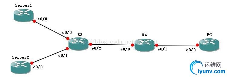

实验七、PIM-SSM(指定信源组播)
SSM(Source-Specific Multicast,指定信源组播)模型和ASM(Any-Source Multicast,任意信源组播)模型是两个完全对等的模型。目前,ASM模型包括PIM-DM和PIM-SM两种模式;SSM模型能够借助PIM-SM的部分技术来实现。SSM模型为指定源组播提供了解决方案,通过IGMPv3来维护主机与路由器之间的关系。鉴于PIM-DM模式以扩散/剪枝方式构建以组播源为根的SPT,虽然SPT的路径最短,但是分发树的建立过程效率较低,不适合大中型网络。在实际应用中,通常采用PIM-SM模式的一部分技术来实现SSM模型。由于接收者已经通过其它渠道(如广告咨询等)知道了组播源的具体位置,因此在SSM模型中无需RP,无需构建RPT,无需源注册过程,也无需通过MSDP(Multicast Source Discovery Protocol,组播源发现协议)来发现其它PIM域内的组播源。因此PIM-SSM适合于点到多点的服务
与ASM模型相比,SSM模型仅需要IGMPv3和PIM-SM部分子集的支持。构建为PIM-SM服务的RPT,还是构建为PIM-SSM服务的SPT,关键在于接收者准备加入的组播组是否属于SSM组地址范围(默认为232.0.0.0~232.255.255.255)。如果用户对组播源S的信息感兴趣,则借助IGMPv3的报告报文向最近的DR路由器报告自己对特定源S的信息感兴趣,标记为(include S,G);或报告对除特定源S外的其它组播源的信息感兴趣,则标记为(exclude S,G)。无论如何描述,都表示特定源S的位置对接收者是明确指定的。接收到该报文的DR先判断该报文中的组地址是否在SSM组地址范围内:如果在范围内则构建PIM-SSM,并向特定源S逐跳发送通道的订阅报文。沿途所有路由器上都创建(Include S,G)或(ExcludeS,G)表项,从而在网络内构建了一棵以指定组播源S为根,以接收者为叶子节点的SPT,该树就是PIM-SSM中的传输通道;如果不在范围内,则仍旧按照PIM-SM的流程进行后续处理,此时DR需要向RP发送(*,G)加入报文,同时需要进行组播源的注册。在配置过程中,请注意以下几点:
  • 如果没有配置SSM的组地址,默认为232.0.0.0~232.255.255.255;
  • 必须使用IGMPv3指定源加入;
  • 目前不支持以exclude模式加入组
    Server1配置:
    Server1#conf t
    Server1(config)#no ip routing
    Server1(config)#int e0/0
    Server1(config-if)#ip add 192.168.1.2255.255.255.0
    Server1(config-if)#no sh
    Server1(config-if)#exit
    Server1(config)#ip default-gateway192.168.1.1
    Server2配置:
    Server2#conf
    Server2(config)#no ip routing
    Server2(config)#ip default-gateway192.168.2.1
    Server2(config)#int e0/0
    Server2(config-if)#ip add 192.168.2.2255.255.255.0
    Server2(config-if)#no sh
    Server2(config-if)#exit
    R3配置:
    R3#conf t
    R3(config)#ip pim ssm default
    R3(config)#int e0/0
    R3(config-if)#ip add 192.168.1.1255.255.255.0
    R3(config-if)#ip igmp version 3
    R3(config-if)#no sh
    R3(config-if)#exit
    R3(config)#int e0/1
    R3(config-if)#ip add 192.168.2.1255.255.255.0
    R3(config-if)#ip igmp ver 3
    R3(config-if)#no sh
    R3(config-if)#exit
    R3(config)#int e0/2
    R3(config-if)#ip add 192.168.34.1255.255.255.0
    R3(config-if)#no sh
    R3(config-if)#exit
    R4配置:
    R4#conf t
    R4(config)#ip pim ssm default //开启指定信源组播模式
    R4(config)#access-list 1 permit232.1.1.1 //标记组播组地址
    R4(config)#ip igmp ssm-map enable //开启SSM映射功能
    R4(config)#ip igmp ssm-map static 1192.168.1.2//建立组播组与信源的映射
    R4(config-if)#ip igmp ver 3
    R4(config-if)#no sh
    R4(config-if)#exit
    R4(config)#int e0/1
    R4(config-if)#ip pim sparse-moder
    R4(config-if)#no sh
    R4(config-if)#exit
    PC配置:
    PC#conf t
    PC(config)#int e0/0
    PC(config-if)#ip igmp join-group232.1.1.1 source 192.168.1.2 //加入组播组,并指定组播信源
    PC(config-if)#no sh
    PC(config-if)#exit
    检查网络联通性,然后观察R4
    R4#sh ip mroute
    (192.168.1.2,232.1.1.1), 00:04:04/00:02:57, flags: sTI
      Incoming interface: Ethernet0/0, RPF nbr192.168.34.1
        Ethernet0/1, Forward/Sparse,00:04:04/00:02:57
    (*, 224.0.1.40), 00:16:11/00:02:28, RP0.0.0.0, flags: DCL
       Ethernet0/0, Forward/Sparse, 00:16:11/00:02:28
    232.1.1.1        Ethernet0/1              00:03:04  00:02:03 192.168.0.2
    224.0.1.40       Ethernet0/0              00:09:16  00:02:31 192.168.34.4
    接着在Server1 和Server2分别ping 232.1.1.1组播组地址观察结果:
    Server1#ping 232.1.1.1 repeat 100 //Server1 可以通信
    Type escape sequence to abort.
    Sending 100, 100-byte ICMP Echos to232.1.1.1, timeout is 2 seconds:
    Reply to request 0 from 192.168.0.2, 76ms
    Reply to request 1 from 192.168.0.2, 56ms
    Server2#ping 232.1.1.1 repeat 100 //Server2不可以
    实验八、域间组播PIM-SM结合MSDP与MBGP
      当网络跨越了公网,或者网络需要各自独立时,如果每个独立的网络,或者是每个AS之间都需要组播通信的情况下,我们需要在不影响网络独立的前提下连通网络间的组播。各个独立的网络中,又希望自己的组播路由器可以由自己完全控制,那么就需要将各个网络配置成独立的PIM-SM域。要将不同的PIM-SM域之间连通组播,就必须先有正常的组播树,而PIM-SM组播树的建立,必须了解到网络中的RP信息,以及组播源的位置。   此时MSDP出现了,MSDP组播源发现协议(MulticastSourceDiscoveryProtocol)描述了一种连接多PIM-SM(PIM-SM:PIMSparseMode)域的机制。每种PIM-SM域都使用自己独立的RP,它并不依赖于其它域内的RP。PIM-SM域内的MSDP发话路由器与其它域内的MSDP对等设备之间存在一种MSDP对等关系,这种关系通过TCP连接形成,在其中控制信息进行交换。每个域都有一个或多个连接到这个虚拟拓扑结构。这种拓朴结构使得域能从其它域发现组播源。如果组播源想知道含有接收端的域,那么PIM-SM中的标准源树建立机制就会被用于在域内分配树上传送组播数据。MSDP使用TCP639端口建立对等连接(高ip侦听,低ip连接),和BGP一样,对等间连接必须明确配置,当PIMDR在RP注册源时,RP向所有的MSDP对等体发送源激活消息,然后其他MSDP路由器将SA泛洪。域内的组播路由和组播源信息收集工作由 PIM-SM 完成, MBGP  负责域间传播具有组播拓扑的信息,MSDP 负责传播组播源信息。这种方案要求所有的自治域都支持  PIM-SM、MBGP和MSDP。在PIM-SM  /  MBGP  /  MSDP  组合方案中,自治域边界路由器之间配置外部  MBGP 对等,RP 之间配置外部 MSDP 对等;自治域内部路由器之间根据需要配置内部 MBGP 对等;内部 RP之间配置内部  MSDP  对等,实现Anycast  RP。该优点在於
  • 不存在第三方(Third-party)资源依赖域内RP。 msdp使得一个pim-sm域不需要依赖另一个pim-sm域内的rp,因为在得到另一个pim-sm域内的组播源信息之后,一个pim-sm域里的接收者可以不通过另一pim-sm域里的rp而直接加入到这个域内组播源的spt上。
  • PIM-SM域只依靠本身的RP。
  • 接收端域:只带接受端的域可以获取数据而不用全局通告组成员。MSDP可以和其它非PIM-SM协议一起使用。
    在不同的PIM-SM域之间建立MSDP连接时,是使用TCP 639, IP地址高的初始化TCP连接,60秒一次keepalive,75秒后没数据或keepalive则重建TCP。建立连接的双方均是各自区域的RP,组播源向RP注册之后,那么RP将这些源信息通过在MSDP连接上发送Source-Active (SA)到远程RP,以提供组播源的信息。因为RP收到Source-Active (SA)后,也是要做RPF检测的,检测是根据BGP来做的,在这里,需要使用MBGP之组播协议,组成员的网络信息和建立MSDP连接的peer地址理论上都需要在MBGP中进行通告,一是防止RPF检测失败,二是由此来决定组播数据的传递,所以十分重要。MBGP(多协议边界网关协议)增加了 BGP 的性能,使其能在整个因特网上组播路由策略,并能够在 BGP 自治系统内或之间连接组播拓朴。换句话说, MBGP 可以说是增强版的携带 IP 组播路由的 BGP(不仅限于此)。BGP 携带了两组路由,一组是提供单播路由,另一组是提供组播路由。协议独立组播(PIM)使用连接组播路由的路由器建立数据分配树。当需要链接仅用于组播通信,或限制通信的资源使用时;也可能当网络访问点需要交换所有的组播通信时,MBGP 都是非常有用的。MBGP 允许单播路由拓朴不同于组播路由拓朴。
    但是在PIM-SM域之间没有开启MBGP,就会有RPF检测失败的危险,失败后,Source-Active (SA)将被丢弃,所以要想在不开启MBGP的情况下,又要接收所有的Source-Active (SA),则将接收端配置成default MSDP,那么该域将接收任何SA信息。在配置default MSDP时,需要指定从何处接收SA,就需要指定对端MSDP peer,使用ip msdp default-peer指定,之后从对端过来的SA将不做RPF检测而完全被接收。
    在配置MSDP peer时,可以指定originator-id,此ID即在SA中写出RP的地址,也可以不配。必须的配置只是msdp peer,且 MSDP对等体的接口地址与建立MBGP对等体的接口地址相同。MSDP只能在PIM-SM下使用,并且域间建立peer的RP应该是直连的。当两个远程网络需要使用组播时,由于中间可以隔了多个网络,也可以利用MSDP连接在不需要中间网络支持组播的情况下,连通远程网络的组播,所以MSDP类似于组播VPN。但需要解决直连问题,解决的方法可以配置tunnel。
         在不同的域中配置的RP,被称为LogicalRP ,但在网络中也可以配置多个RP,如果将多个RP配置成同一个地址时,那么多个具有相同地址的RP被称为Anycast RP,而且Anycast RP必须是32位掩码的地址,且需要在单播里通告,各个源和组成员均选用离自己最近的RP, 从而提供冗余功能。所有Anycast RP都要配置成MSDP peers,每个注册的消息,都传给所有RP
    msdp另一个应用是anycast rp。在一个域内,用同一个ip地址配置不同的路由器上的某一接口(通常是loopback接口),同时,配置这些路由器上这个接口为候选rp,并在这些rp之间建立msdp对等体关系。单播路由收敛后,组播源可以选择最近的rp注册,接收者也可以选择最近的rp加入其rpt。这些rp之间通过msdp对等体了解对方的注册源信息,最终每个rp了解到整个域内的所有组播源,这样,每个rp上的接收者就可以接收到整个域内的所有组播源发出的组播数据。通过向就近的rp发起注册和rpt加入,实现rp的负载分担;一个rp失效后,其原来注册的源和加入者,又会选择另一个就近的rp注册和加入,实现了rp的冗余备份。另外,msdp通过rpf检查机制,只接受从正确路径上接收到的sa消息,避免接受冗余的sa消息;可以通过配置mesh全连接组来避免sa消息在msdp对等体之间泛滥。
    在Anycast RP中,2个或多个RP在其Loopback接口上配置相同的IP地址。Anycast RP Loopback地址应该配置为32位掩码,其他路由器必须“知道”这个Anycast RP Loopback地址是它们的RP。当然在一台路由器上,IP路由协议将会自动选择离它最近的RP;假设网络中的组播源是均匀分布的,那么这些组播源也将均匀地注册到每个RP上。由于组播源可能注册到一个RP,而接收方却注册到另一个RP,我们就需要使用MSDP在RP之间交换活动组播源的信息。在Anycast RP中,所有RP之间必须配置为MSDP对等体。当一个组播源向某个RP注册时,该RP将通过MSDP的SA消息通告给其他RP,从而使得其他的RP都知道这个组播源的信息。若某个RP故障,当IP路由协议收敛后,其他RP将会成为该区域新的RP。而新的组播源将会将会注册到备份RP(即新的RP);同样地,接收方也将使用新的RP,从而保证连通性。
    单个域内的PIM-SM要通信,是建立的(*,G)条目,如果PIM-SM域之间要通信,建立的是(S,G)条目,相当于是距离矢量的路径方式
                     Server配置:
    • Server#conf t
      Server(config)#ip default-gateway192.168.1.1
      Server(config-if)#ip add 192.168.1.2255.255.255.0

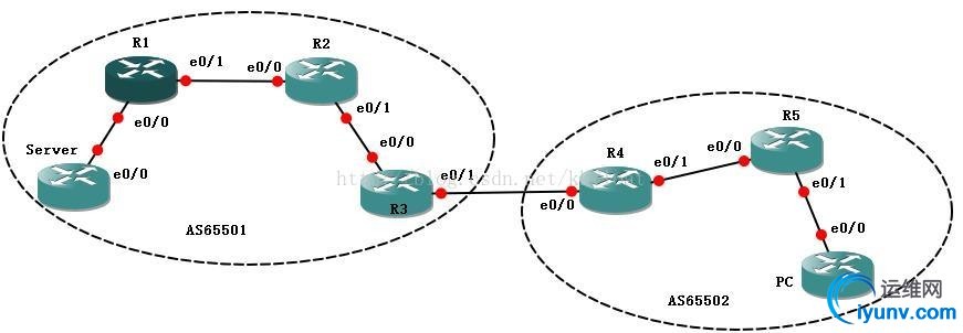

      R3(config-router)#net 192.168.34.0255.255.255.0 area 0
      R3(config)#router bgp 65501
      R3(config-router)#bgp router-id 3.3.3.3
      R3(config-router)#net 192.168.23.0 mask255.255.255.0
      R3(config-router)#net 192.168.34.0 mask255.255.255.0
      R3(config-router)#net 10.10.10.10 mask255.255.255.255
      R3(config-router)#nei 1.1.1.1 remote-as65501 nlri unicast multicast
      R3(config-router)#nei 1.1.1.1update-source loopback 0
      R3(config-router)#nei 2.2.2.2 remote-as65501 nlri unicast multicast
      R3(config-router)#nei 2.2.2.2update-source loopback 0
      R3(config-router)#nei 192.168.34.4remote-as 65502 nlri unicast multicast
      R3(config)#ip pim bsr-candidate loopback10
      R3(config)#ip pim rp-candidate loopback10
      R3(config)#ip msdp peer 1.1.1.1connect-source loopback 0
      R3(config)#ip msdp peer 2.2.2.2 connect-sourceloopback 0
      R3(config)# ip msdp peer 192.168.34.4connect-source ethernet 0/1 remote-as 65502
      R3(config)#ip msdp mesh-group anycast-rp1.1.1.1
      R3(config)#ip msdp mesh-group anycast-rp2.2.2.2
      R3(config)#ip msdp originator-idloopback 0
      R4配置:
      R4#conf t
      R4(config)#int e0/0
      R4(config-if)#no sh
      R4(config-if)#exit
      R4(config)#int e0/1
      R4(config-if)#no sh
      R4(config-if)#exit
      R4(config)#int lo 0
      R4(config-if)#exit
      R4(config)#int lo 20
      R4(config-if)#ip add 20.20.20.20255.255.255.255
      R4(config-if)#exit
      R4(config)#router eigrp 1
      R4(config-router)#no au
      R4(config)#router bgp 65502
      R4(config-router)#bgp router-id 4.4.4.4
      R4(config-router)#net 192.168.34.0 mask255.255.255.0
      R4(config-router)#net 192.168.45.0 mask255.255.255.0
      R4(config-router)#net 20.20.20.20 mask255.255.255.255
      R4(config-router)#nei 192.168.34.3remote-as 65501 nlri unicast multicast
      R4(config-router)#nei 5.5.5.5 remote-as65502 nlri unicast multicast
      R4(config-router)#nei 5.5.5.5update-source loopback 0
      R4(config)#ip pim rp-address 20.20.20.20
      R4(config)# ip msdp peer 192.168.34.3connect-source Ethernet 0/0 remote-as 65501
      R4(config)#ip msdp peer 5.5.5.5connect-source loopback 0
      R4(config)#ip msdp originator-idloopback 0
      R5配置:
      R5#conf t
      R5(config)#int e0/0
      R5(config-if)#no sh
      R5(config-if)#exit
      R5(config)#int e0/1
      R5(config-if)#no sh
      R5(config-if)#exit
      R5(config)#int lo 0
      R5(config-if)#ip add 5.5.5.5255.255.255.255
      R5(config-if)#exit
      R5(config)#int lo 20
      R5(config-if)#ip add 20.20.20.20255.255.255.255
      R5(config-if)#exit
      R5(config)#router eigrp 1
      R5(config-router)#no au
      R5(config)#router bgp 65502
      R5(config-router)#bgp router-id 5.5.5.5
      R5(config-router)#net 192.168.45.0 mask255.255.255.0
      R5(config-router)#net 192.168.0.0 mask255.255.255.0
      R5(config-router)#nei 4.4.4.4 remote-as65502 nlri unicast multicast
      R5(config-router)#nei 4.4.4.4update-source loopback 0
      R5(config)#ip pim rp-address 20.20.20.20
      R5(config)#ip msdp peer 4.4.4.4connect-source loopback 0
      R5(config)#ip msdp originator-idloopback 0
      PC配置:
      PC#conf t
      PC(config)#int e0/0
      PC(config-if)#no sh
      此时在Server端ping 224.1.1.1 ,并调试R3和R4 变化:
      Server#ping 224.1.1.1 repeat 100
      Sending 100, 100-byte ICMP Echos to224.1.1.1, timeout is 2 seconds:
      Reply to request 1 from 192.168.0.2, 184ms
      Reply to request 2 from 192.168.0.2, 188ms
      Reply to request 3 from 192.168.0.2, 184ms

      查看R3和R4的多播路由表
      R3#sh ip mroute
      (*, 224.1.1.1),00:07:34/00:02:46, RP 10.10.10.10, flags: S
        Incoming interface: Ethernet0/0, RPF nbr192.168.23.2
          Ethernet0/1, Forward/Sparse,00:07:34/00:02:46
      (192.168.1.2,224.1.1.1), 00:06:45/00:00:09, flags: T
          Ethernet0/1, Forward/Sparse,00:06:45/00:02:46
      (*, 224.0.1.40), 00:12:22/00:02:37, RP0.0.0.0, flags: DCL
         Loopback0, Forward/Sparse, 00:12:22/00:02:37
      R4#sh ip mroute
      (*, 224.1.1.1),00:08:08/00:03:15, RP 10.10.10.10, flags: S
        Incoming interface: Ethernet0/0, RPF nbr192.168.34.3
          Ethernet0/1, Forward/Sparse,00:08:08/00:03:15
      (*, 224.0.1.40), 00:10:28/00:02:35, RP0.0.0.0, flags: DCL
         Loopback0, Forward/Sparse, 00:10:28/00:02:35
